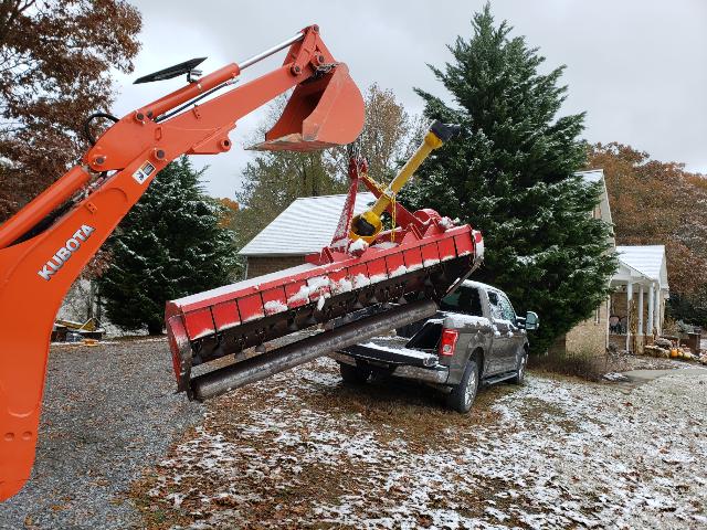

Newest member of the flail nation. Caroni TM1900 bought used. Previous owner swapped out OEM knives for stamped duck foot blades. Don't know if I'll change back, but I'll kill these before I do anyway

Hello and good morning Michael in Tennessee,
I wish to welcome you as the newest resident member of the "Flail Mower Nations" from the Great State of Tennessee.
I see you have some of that fuzzy white mold on your lawn that occurs in the winter months eh? We have a lot of that stuff up north and it is usually gone by late april most years.
If you have a lot of brush to knock down you can do it pretty well now as all the brush has been winter killed and does not have a lot of moisture in it.
Happy Mowing,
