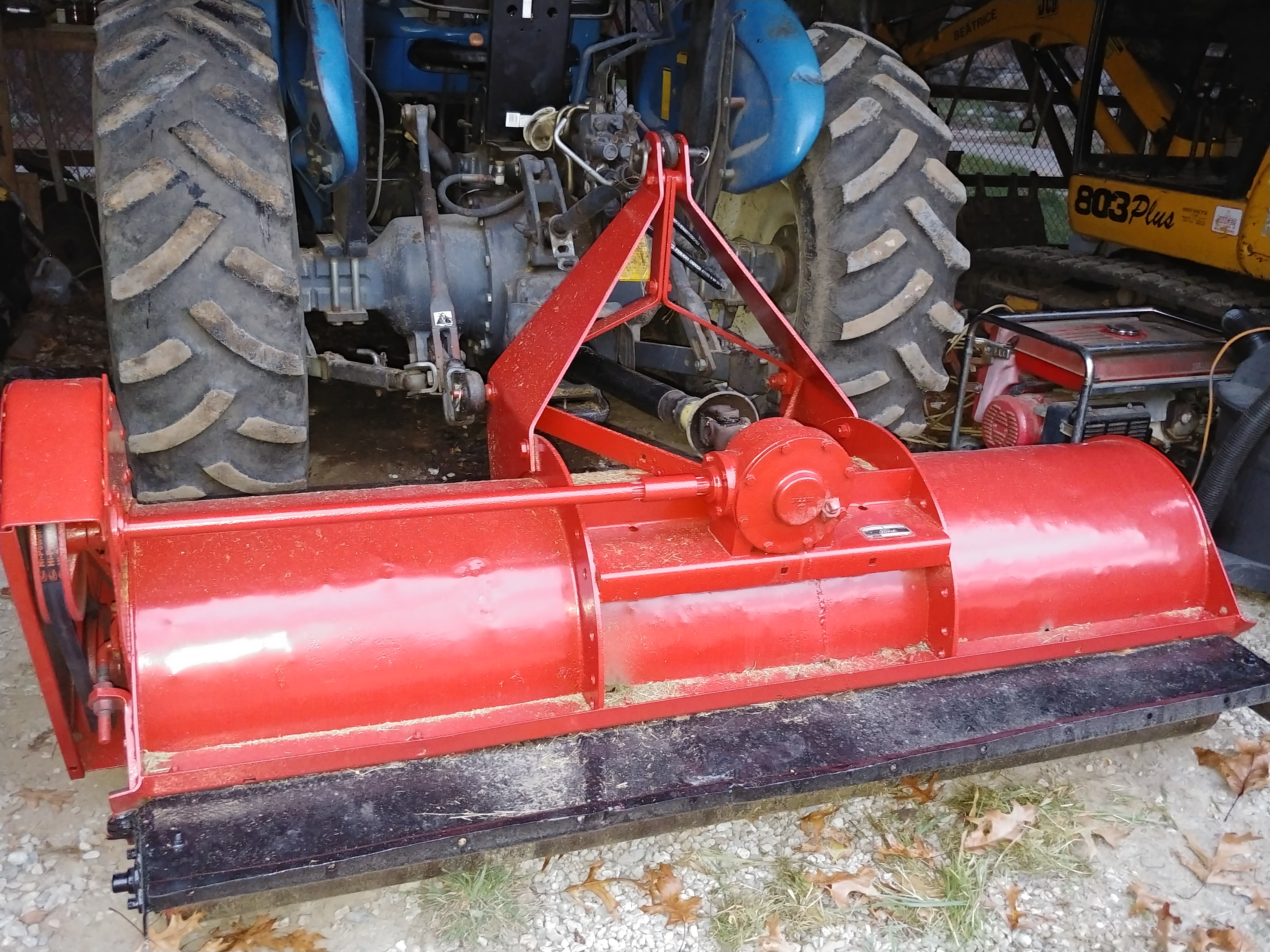

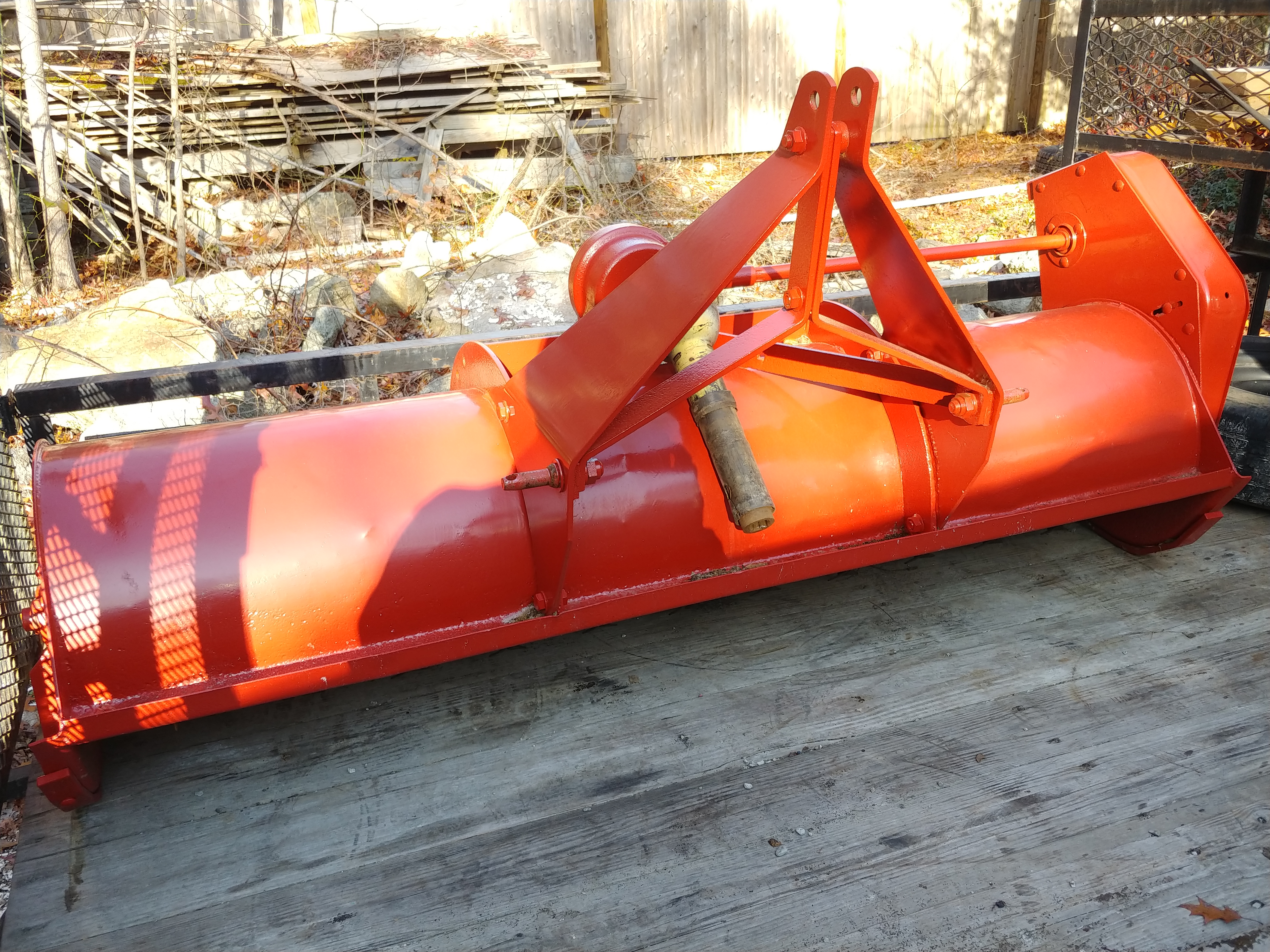

Here's the new to me Ford flail mower that I just picked up yesterday. I bought it from a local used equipment dealer who did a great job painting it, the wrong color!

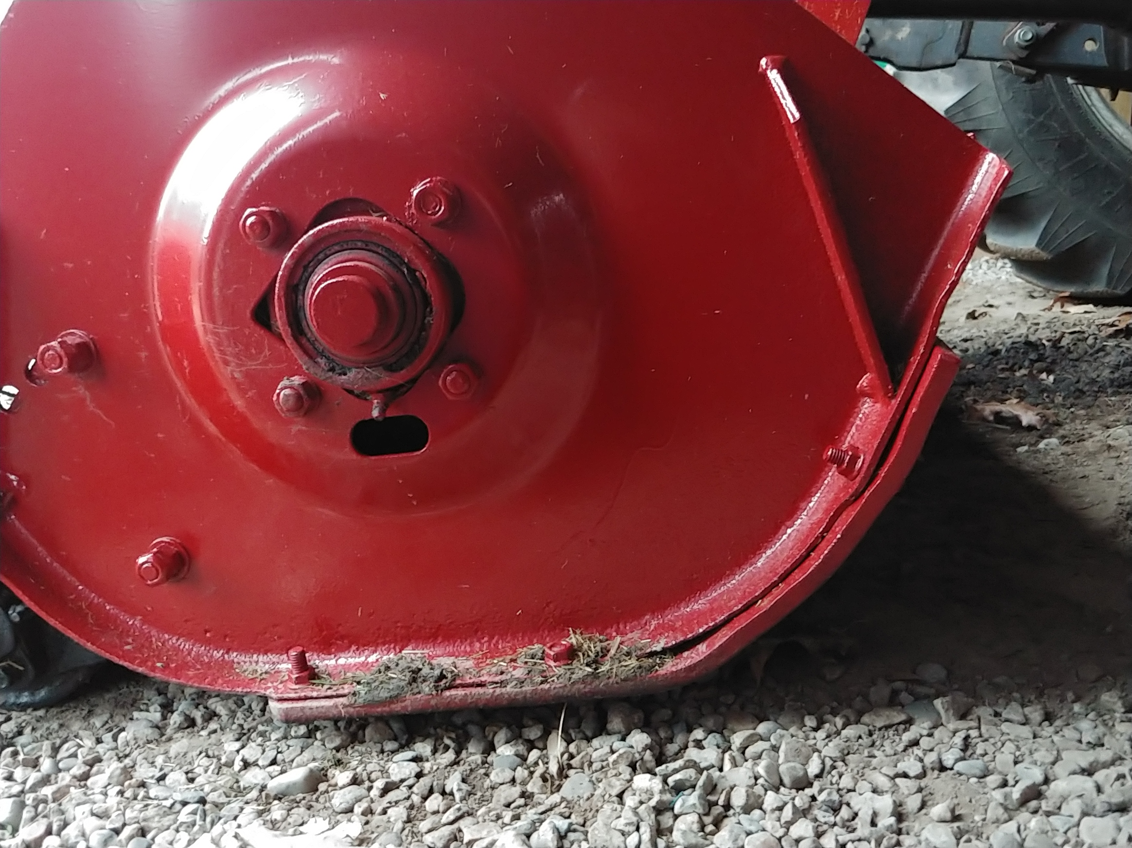

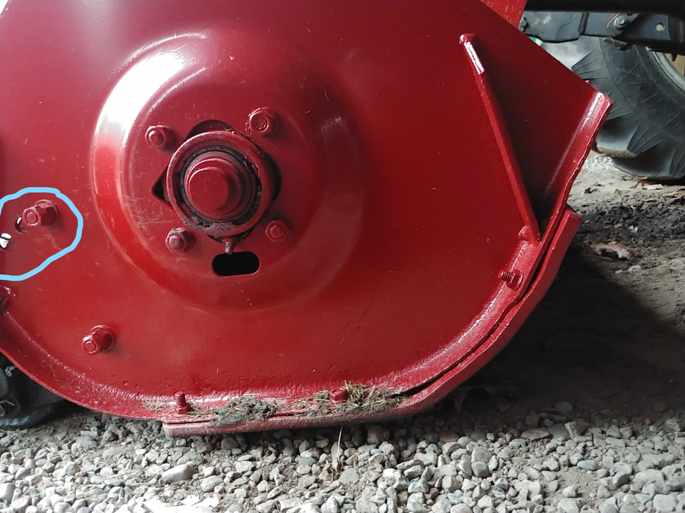

I set it up on the 3930 today and took it out for a test drive. I really like how it chops everything up so fine. Cuts real short though. Am I spose to be running this thing right down on the side skids and back roller? On uneven ground it's chopping in the dirt.
That would be the Ford 907. Uses the same blades as the 917, but different hangers.
Your roller is set to it's lowest setting. Good for soccer fields, bad for anything not flat. Set it to a higher setting and try it again. The skids are there as a means of protection to prevent bottoming out, not for riding on. The roller should be carrying it.

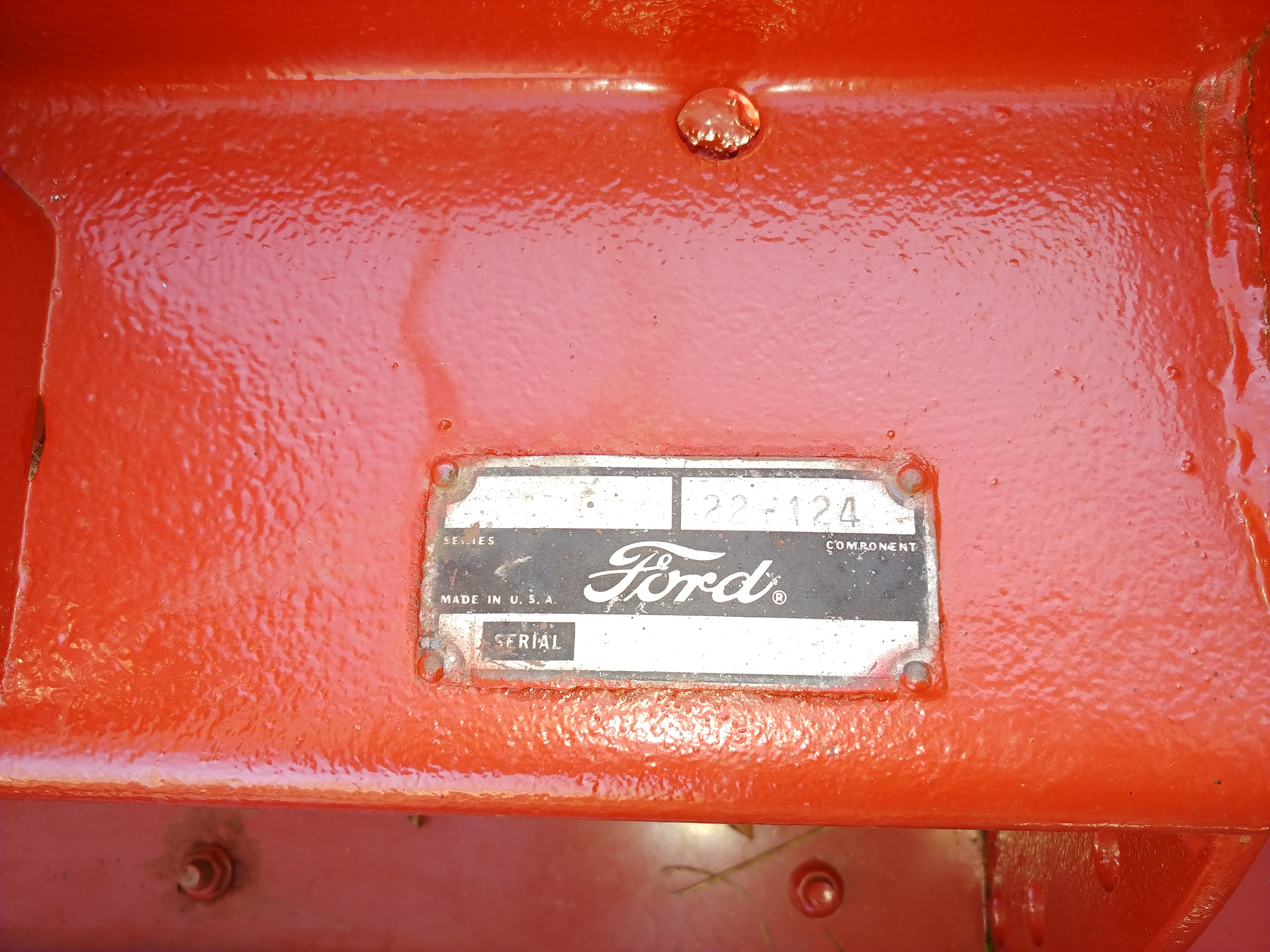

907 you say? Thanks! The tag is not very readable. So I'll look to drop the roller, and I guess adjust the top link to get the side skids up and out of the dirt.

The tag doesn't give you the "907". It tells you their code for the model and size. So "22-124" tells me that it's a 907 6 foot. They were made between 1964-1972. Messicks has a parts diagram for the unit and some parts are available through them. Just search 22-124 in New Holland Agriculture on the left side of their home page.
The bolts circled in this picture are the roller adjustment.
The roller is currently set at the lowest setting. Move it one notch and check the result. If it's not satisfactory move it to the last notch (only 3 options).
