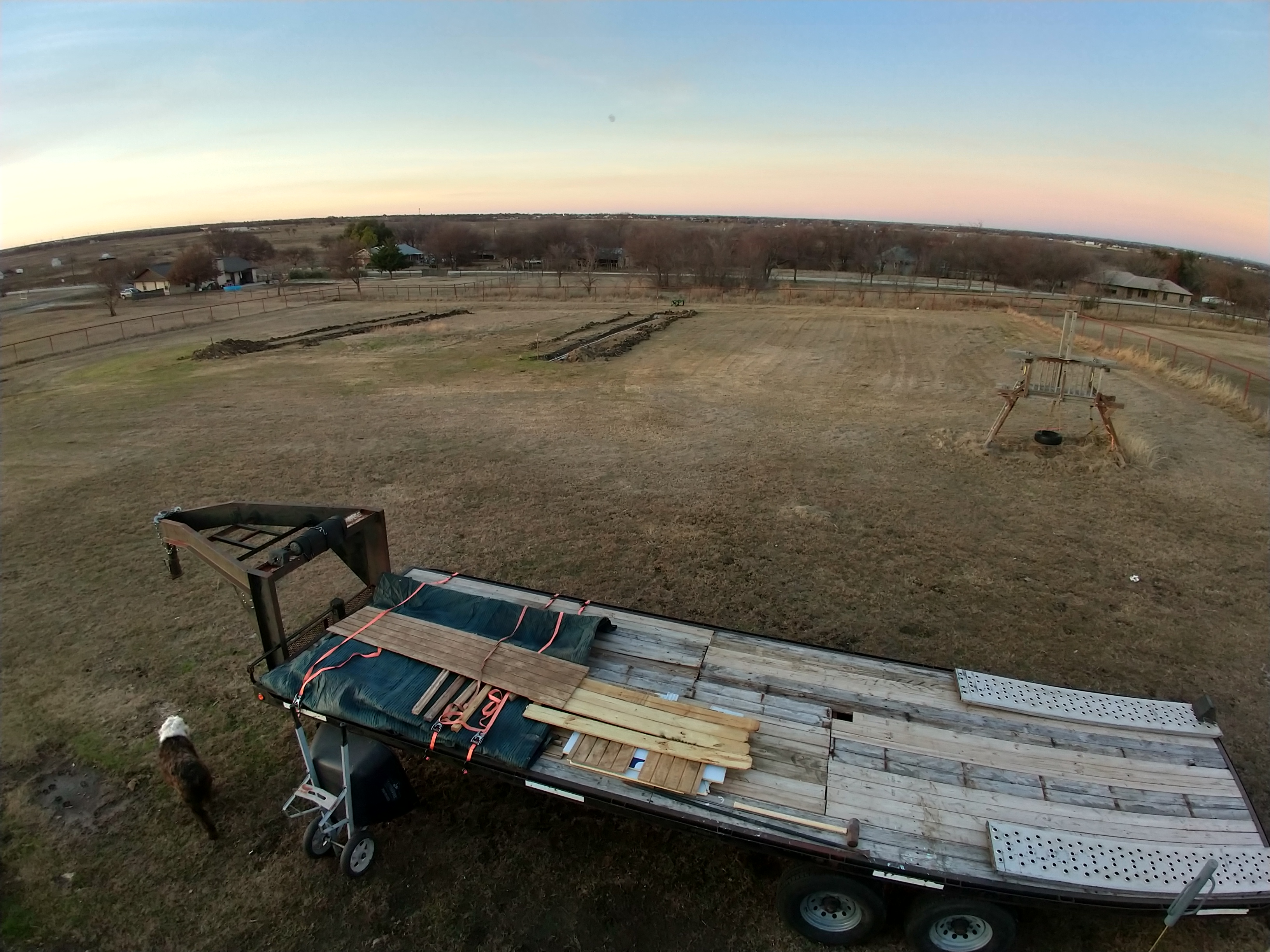

So, here ya go. The big chunk of the 3 acre plot.....
One of our OES is sitting next the GN - I'll easily presume drooling in anticipation of getting to bark @ & chew on the sprinkler heads when they activate. The 2 trench's are the expansion of 2 more heads for septic system irrigation.
As with everything else, I do as much as I can, when I can & where I can. Chipping away at the iceberg is a lifespan activity.

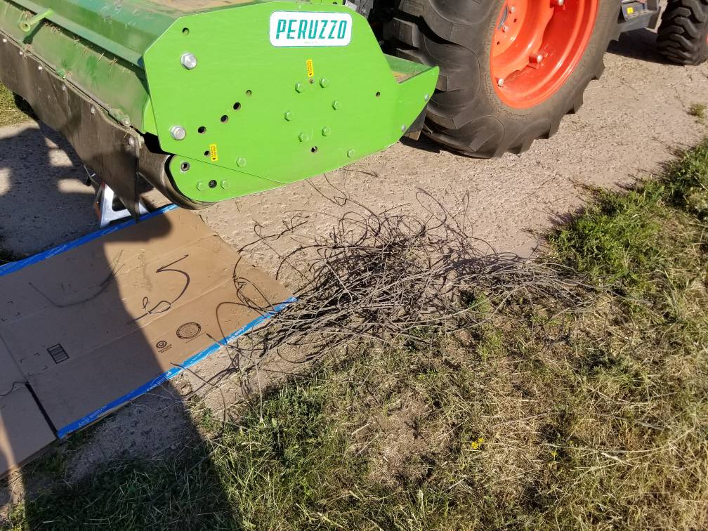

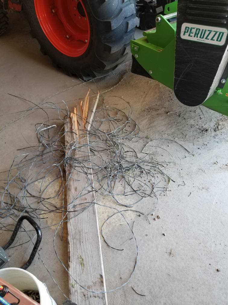

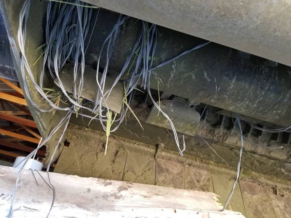

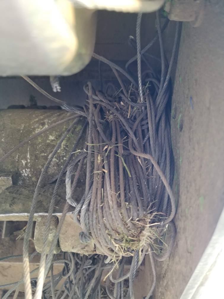

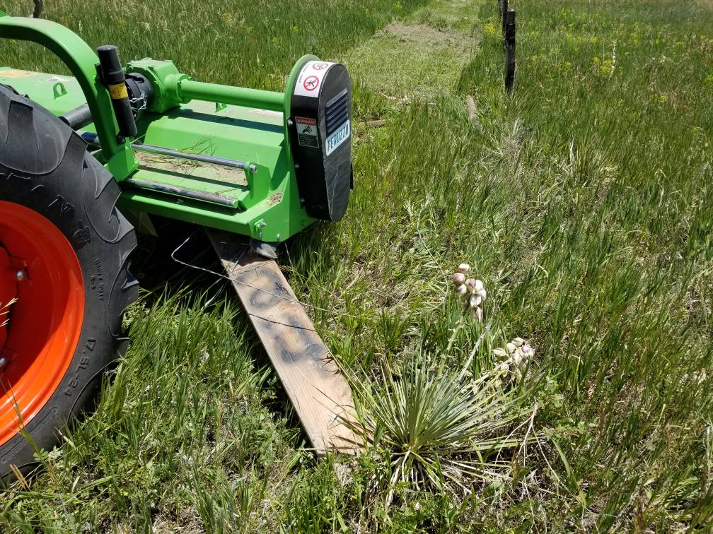

Just be careful around fence line, nothing rolls up loose wire like a flail mower. I have spent more time cutting wire from the ends of my rotor than I care to admit. I now will not cut a new area unless I am positive there is no wire there. I cannot stress this enough. Good luck with your purchase, sorry I can't help you with picking a mower. My dandl is 9' wide and it is the only flail I have any experience with.
About 2 seconds max from what's that noise or movement to a total stall most of the time. Both those incidents sucked. The wire rope was worse than the fence wire though as it was to squishy for bolt cutters to cut well.20190629_123641.jpg20190629_131356.jpg20190629_124509.jpg20180718_191806.jpg20180718_192936.jpg20180719_175911.jpg

Barbed is way more fun than barbless, but neither of those looks like as much fun as that cable. You must have gotten to play for hours. I am so glad I didn't get to have that much fun.
