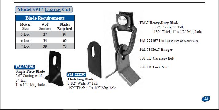

Regarding the advice that the Ford 917 model can use some/certain Alamo/Mott flail blades I couldn't figure out how to scan-search for what will swap in "plug n play" style?
Thanks to @TheFarmerInAdell for posting the picture in post #6576 that is from the Flailmaster PDF. The bottom of page 23 for the Ford 917 specific blades/hangers etal.
If you look at the top of page 2 on the Flailmaster PDF for the Alamo/Mott blades there is the "fine cut" model #MH-386. Is there any data that anyone has showing/proving (past experience?) these are too long to try and use in the Ford 917?

The MH-386 will not work. Go down to the 917 section of the Flailmaster catalog and it says the measurements of the 917 fine cut blade at 1-1/4" wide 3-1/2" tall. You could use the MH-293, but it will be shorter than the Ford version. I would suggest the airplane wing blades in place of going to a fine cut as you already have the hangers and brackets for them. This will give you a nice flat cut. If you want a very high quality cut you can switch over to the fine cut, but stick with the Ford blades.

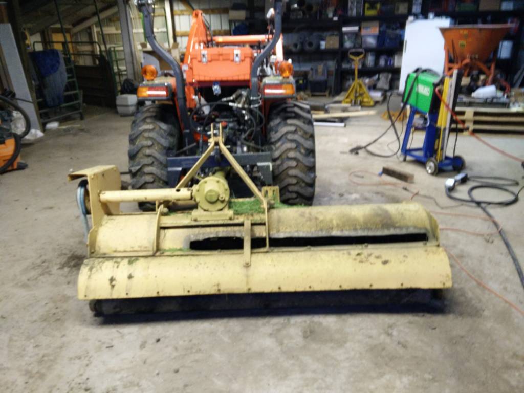

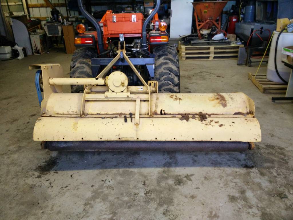

Some dents in the back of my 917 they I really cant see in these photos lead to the knives hitting the hood. When I got the flail ($100) it was missing knives, presumably to combat this issue. I cut out & patched a large chunk of the rear of the hood & replaced knives to fix this.
Which is probably a long way to say there is probably between 1/4 & 1/2" between the knives & hood when its it's running right. I can't comment on what blades may or may not fit beyond ones designed for a 917.
Yes you can also see the cracks in the hood in the missing knives photo. I never did bother getting around to dealing with those as it ran fine (for a $100 mower), if a bit noisy. Ran it for 2-3 years like that before retiring it & upgrading to a Peruzzo Brush Bull. IMG_20150525_185656.jpgIMG_20150613_203410-1.jpgIMG_20150529_181633-1.jpg
