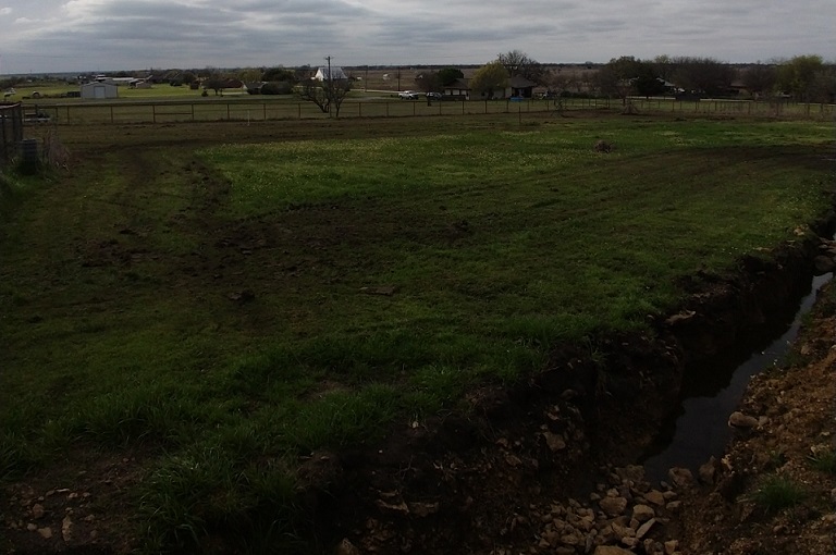

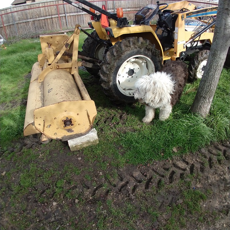

Okay, technically it's now "Monday" but, 'yesterday' I went a head and did a systems check and tested the 917 on a absolutely saturated back yard that had some varies growth. The missing 5-6 blades did have a noticable but still mild vibration while running.
The Cub cadet is claimed to be a 25hp unit. The 7260 (for refresher)
Here's the edited down pics of a test mowing and a post mow shot that one of our OES's is inspecting.

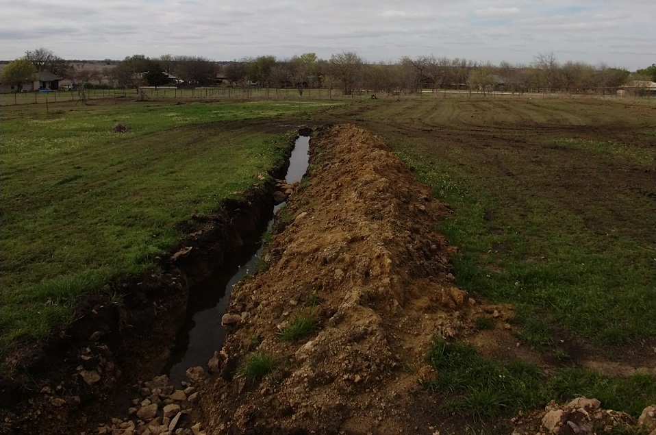

The trench I dug as part of a upgrade for drainage from the gutters. To get past the chicken coop. with the constant on/off rain its been very difficult trying to finish this all.
This 1st go at mowing with the 917 was a pleasant surprise. yes the accoustic signature was definately different, a much 'lower roar, if i dare say it. compared to the Bush Hog finish mower.
I did have to run the tractor at the 2300-2500 RPMS which is the "desired" 540 PTO RPMs but, that wasn't so bad.
I was able to cut 80% in M 3rd and occasionally the high spots were a drop to M2 gear and it did fine. The forward roll given the top link needing adjustment means next time I won't try to mulch the terf on a couple divet areas.
but, that yard is sooo saturated. over 8" this month alone......

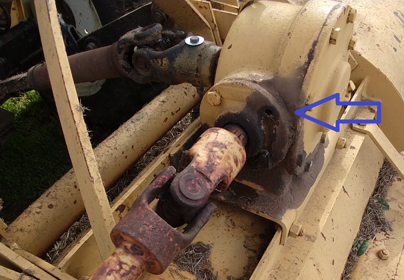

Oh yeah, and I'll be solving the bolt that spun out and disappeared(purple arrow).... drain and fill the gearbox when I do that too.

still need to deal with that bolt on the gearbox..... but, its been rain and now brisk weather ....
