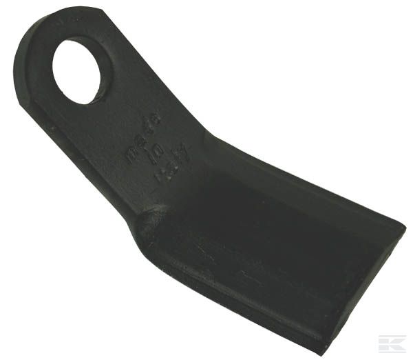

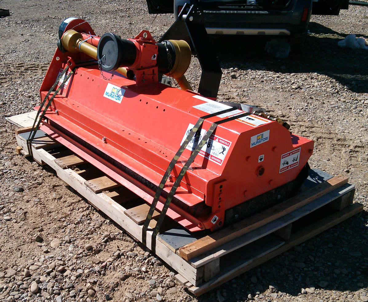

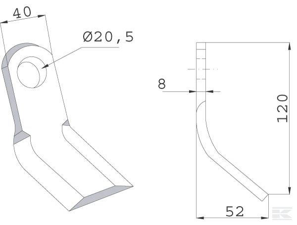

We have finally joined Flail Nation, thanks to all of the input on this board!
The mower is a Muratori MT22-170. I have a PDF of the parts guide if anyone needs one.
The knives are quite heavy, at 9/32 or 8mm thick.
