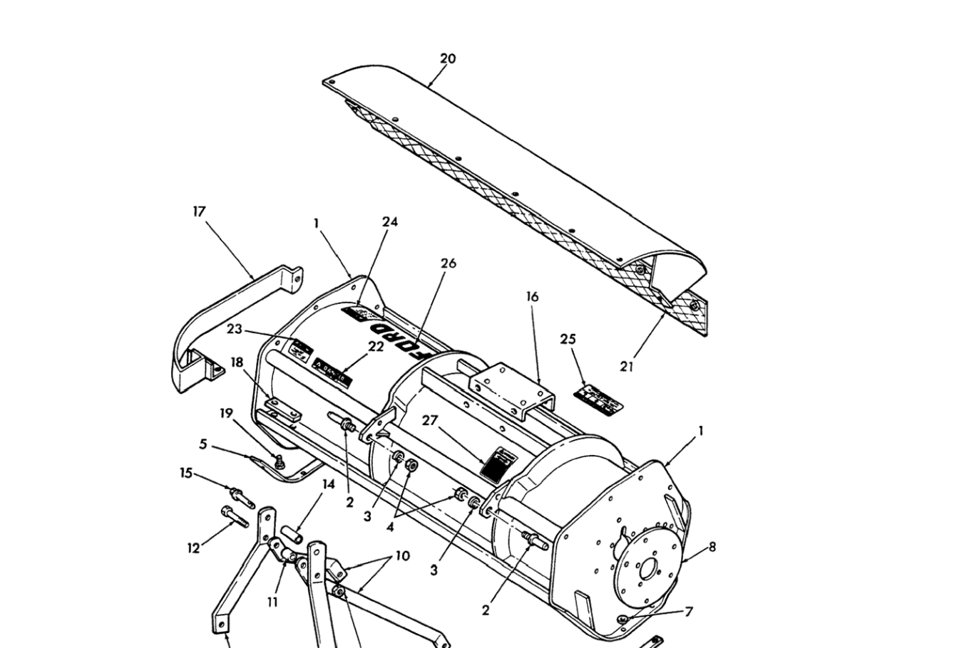

Anyone for a rousing game of "name that flail?
This one has come up for sale near me for what I consider a decent price. 48" in width, so a nice size for the little yanmar.
I think its a Ford 917 of some flavor but some parts look significantly different than what I remember from the one I had previously. The lift pin attachment also seems to be missing the float arms I remember? Could that be factor or is that a hack job somebody did?
Ended up buying this little 4 footer for $500. Little more than I intended to pay but mechanically it was in good shape aside from the lack of float arms. The blades even look good on it.

   / Let's talk flail mowers #6,647
Interesting bit of info for historical reference. Based on the Messicks parts diagrams, it appears to be a 48" Ford 917A, which does NOT have float arms. Guess it doesn't need anything at all....
   / Let's talk flail mowers #6,648
I always wondered what the difference between the 917 and the 917A was. Now we know it's the float arms. Honestly I disliked the float arms on my 917. My Alamo doesn't have float arms and I don't really see them as necessary unless you're mowing very uneven ground.
