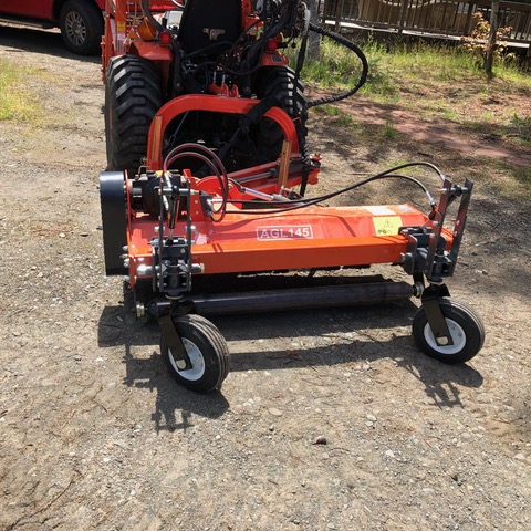

Downsizing -- is it your intent to lower those extra wheels taking weight off the roller , both for transport and to keep control and prevent sideways tipping when the cutter is swung out I suppose ? Nice installation/mod. How is that mower working out reaching out over bank edges, ditches, etc. ?
The wheels are for moving the mower from place to place and positioning for mowing. Once in position, the wheels are lifted so the mower rests on the roller. They operate very smoothly when the mower is pushed out to the side and back again, also driving around the yard. So far I only operated it in the yard to make sure everything works as planned and to fit the PTO driveshaft. I have a few steep banks to mow, but what I mostly have is a lot of uneven ground and difficult to reach areas under the redwood trees. I wanted the tilt cylinder (used in float) so the mower can tip from side to side and better track the ground. I wanted the side extension so I could get under and around the trees.

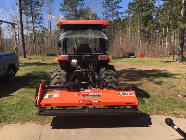

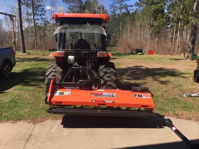

Just received and set up my Woodmaxx FM78H mower this week. Went pretty smooth.....with it taking me about 3 hours to get things set-up properly (yeah....I'm a bit slow). The pics below show the offset.....which, at the time of the pics, I had not adjusted for level. With a little fine tuning.......I took it for a spin. Seems like I have plenty of power for this unit....tho there is not much heavy stuff to cut yet. Really allot of bang for the buck with this unit. Seems ****-bent-for stout and property engineered. I bought the flail blades (all they had) and an extra set as well as spare belts. For my needs I think the knives will do a nicer job. I was quite impressed with the build quality and materials received. The assembly manual has some variations from current production....but nothing that cannot be figured out. Looking forward to mowing season. Gonna love that hydraulic shift right. OH....and the paint makes a good match for my Bota. flail centered.jpgFlail shift right.jpg

Had a quick look at their website and the products look pretty good!
I found a statement that the chipper knives are US made but nothing about the rest of the equipment or flail mowers origin - anyone here with more info on that?
