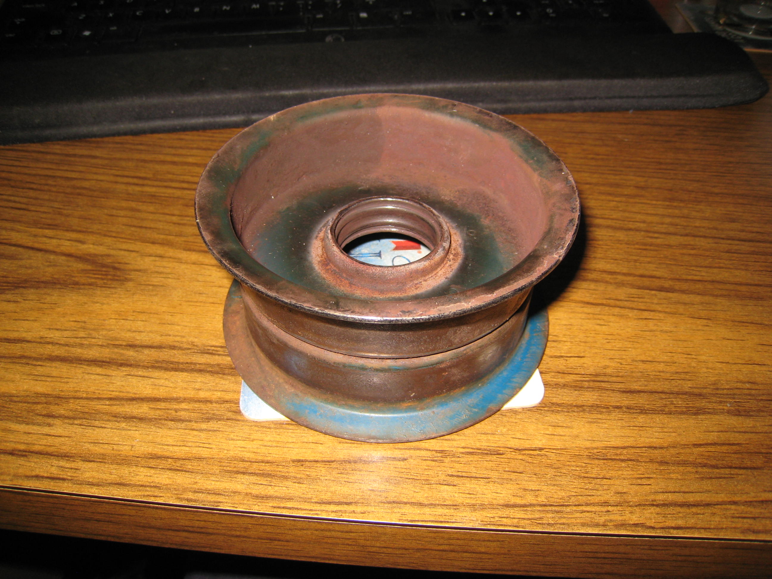

It looks good in the photo but I am not familiar with this brand and have a suggestion & couple of questions.
Please post photos of the most expensive wear parts i.e. the rotor, lugs for the flails & hangers (if it has hangers?). Some designs use loop hanger, others do not.
Also photos of the belt drive showing pulley and idler condition would be helpful in answering you.
Gearbox oil condition should inddicate if it's OK or not (i.e. how much water or metal contamination?).
A simple item like a small (4 inch diameter) flat idler pulley in the photo below could become a problem if it is one of a kind and no generic replacement is available.
The above idler pulley was supposed to be $25 item from a well known large dealer, except it was false/outdated information.
The idler was discontinued some time ago and there are no suitable replacements to be found!
Unfortunately the bearing is not readily replaceable due to the design.
I will make a new idler no problem, but it will certainly cost a bunch of time & money.
How comfortable are you doing repairs like this yourself?

There is hardly anything that couldn't be made if push comes to shove, but I have a hard time believing that idler is hard to replace. Heck I just went on E-Bay. 800 hits for a 4" flat idler pulley.
Yes I thought so too, but it's a double wide 4" flat idler.
I will fix it since I have a shop.
