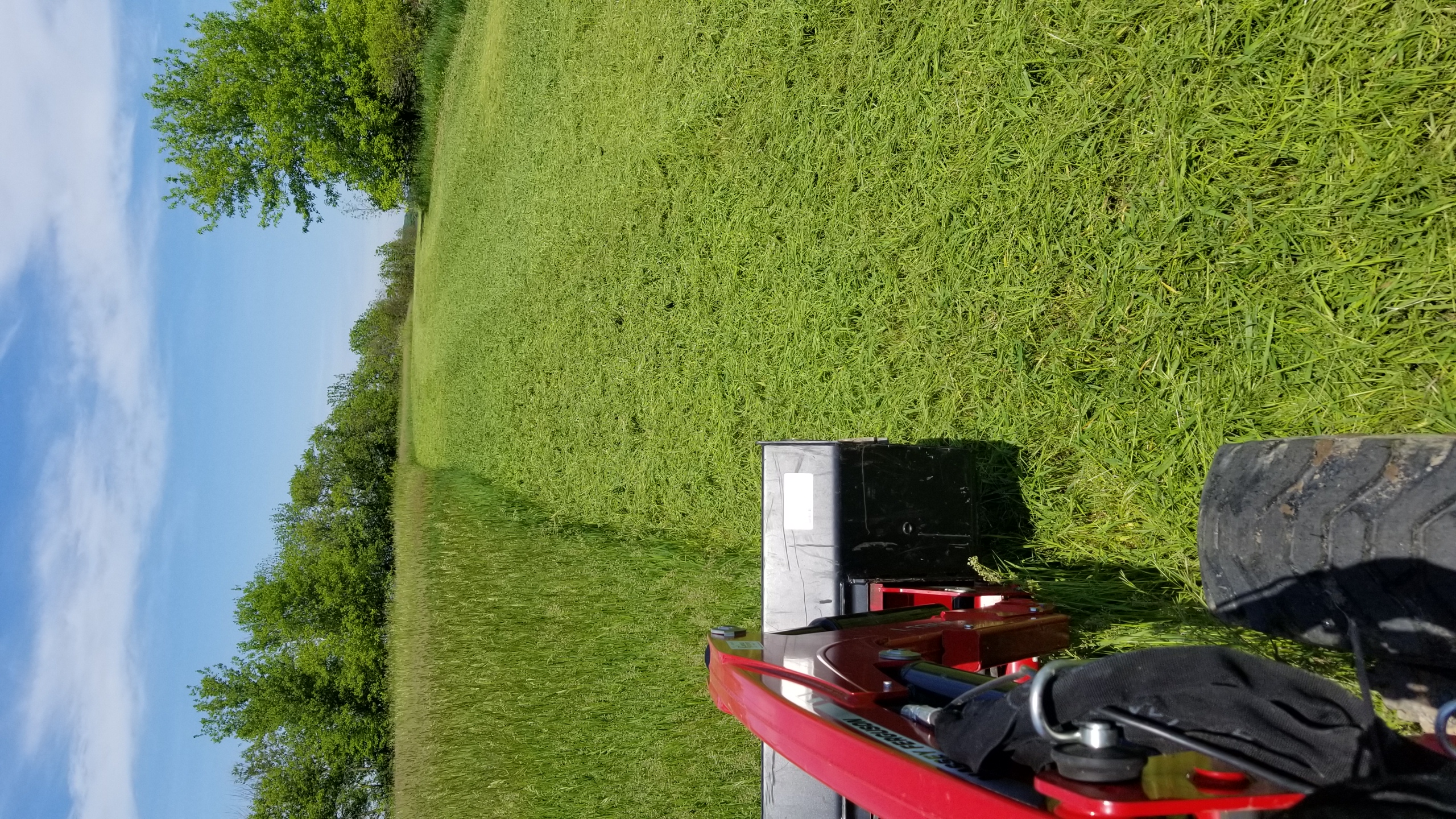

Thanks Leon! I am starting to get a better feel on proper uses. I did determine after looking last night that I needed to raise the mower some as it was mowing to close. I made a pass in the yard and it is already turning brown. We get so hot and dry here I am sure that the grass will burn up.
This mower only has two options on height other than the adjustments I can make with the top link. I lowered the roller and readjusted the top link to keep the skids just about 2" above the ground. Seams to leave the grass green at that height.
Now that I have a couple of hours getting use to it I am going to tackle my ditch bank.
I will definitely try mowing in a spiral and see how that works! Thanks for the tip and I am open to any other suggestions you and others might have!

I did some mowing last weekend. This area usually gets cut on a regular basis because we have gatherings there. This year we got quite a bit of rain and I was lacking in the time department. It got to 4 feet tall before I was able to knock it down :ashamed:
I decided to use GPS to measure my speed and it said 4mph. That's the fastest I usually go. Any faster than that the flail and I bounce too much.
SHD88 on a MF 2706E (57hp, about 50 at the PTO).
