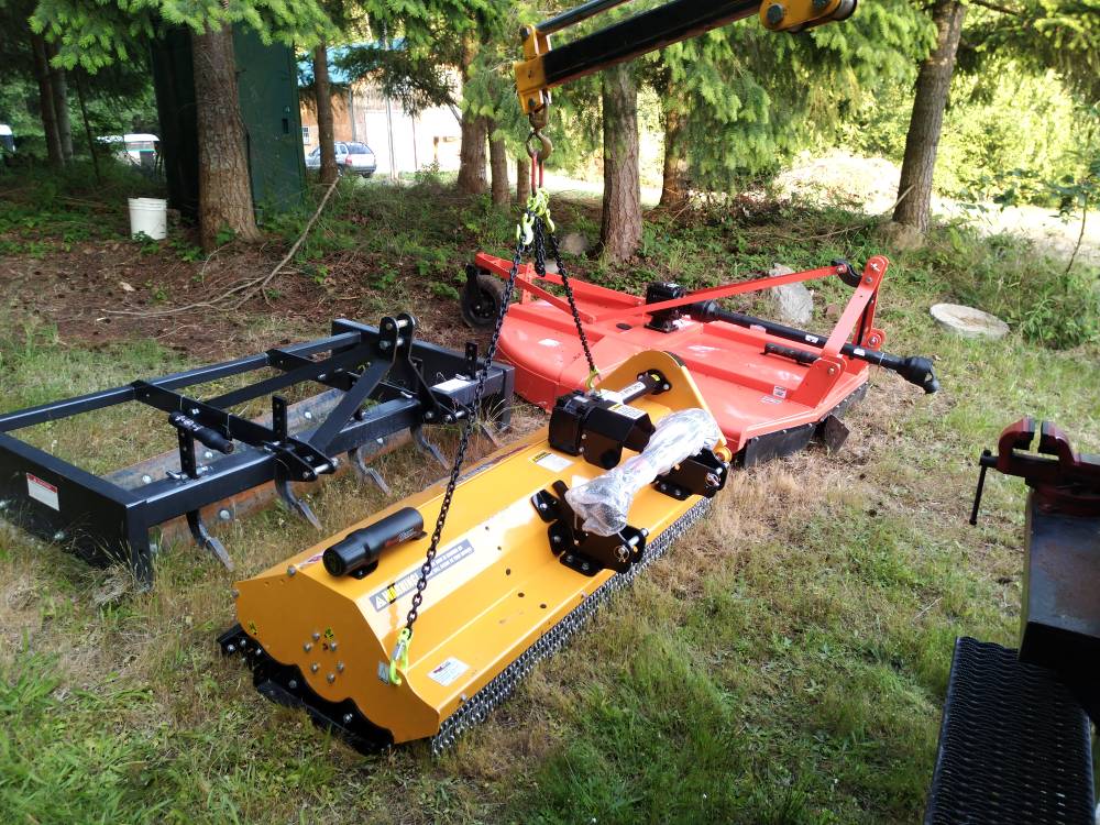

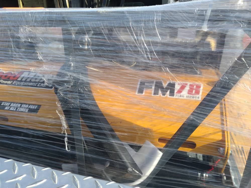

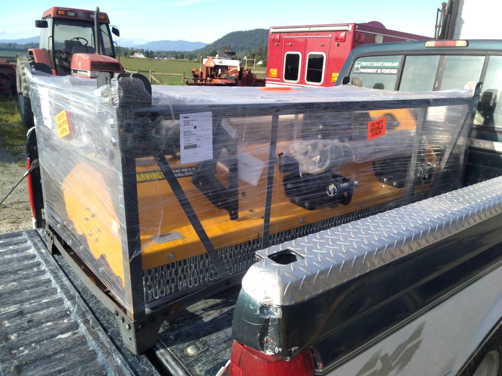

New member, just bought 30 acres of forestland, the property is mostly hillside with several overgrown logging roads crossing it.
I've been borrowing a New Holland 918H, after a lot of time reading this thread I ordered a Woodmaxx FM-78. It was delivered last week, the upper part of the 3 point hitch had been knocked around in the shipping crate and scratched up the paint on the mower in a few places. No real damage that some touch-up paint won't fix though.
Build quality and fit/finish seem better than most imported implements. I ordered it with hammers but will probably switch over to knives in a year or two after clearing some of the brush and downed limbs. IMG_20200617_184106.jpegIMG_20200617_184119.jpegIMG_20200617_202022.jpeg

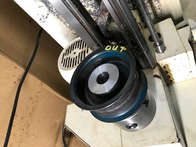

I am just in process of repairing idler pulley on my (new to me) Ford 917L and it is noticeable how the idler looks like it's pretty small diameter in the Caroni.
The 917L idler had failed due to worn out single row sealed ball bearing which was designed to be non-replaceable.
The OD in 917L idler is 4 1/4 inches which I thought was pretty small until I had a look at your photos!
Probably the smaller the diameter the more bending of the belt IE. more heat.
917L idler:

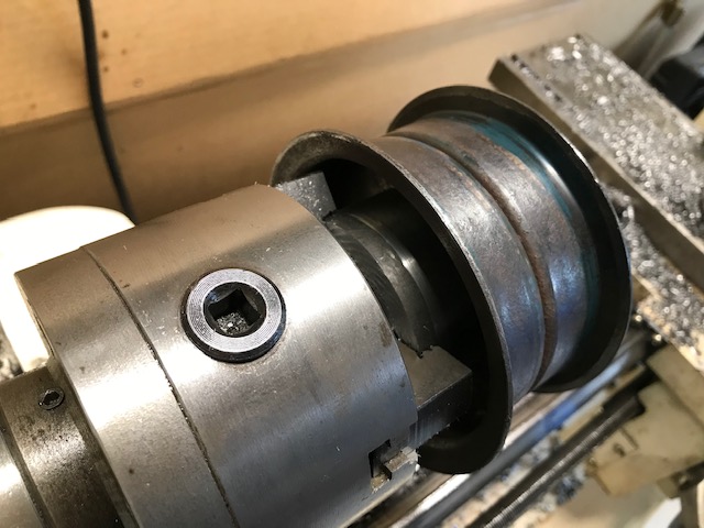

Thank you for the suggestion - grease fitting for the idler arm at the pivot shaft is a good idea and I will add one on mine also since it was bone dry.
I have made some progress repairing the idler pulley but it's been delayed due to other priorities.
(I decided to make a new hub wide enough for two bearings and reuse the rest of the idler)
Here are couple of photos of work in progress:
