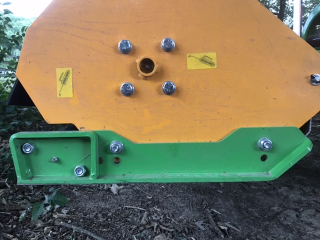

I am running out of room to add a 3rd remote but that is on the table.
However, I do need to tweak the height just a bit. With the roller lowered it is cutting a bit to high. If I shorten the top link, the skids dig in on turns. I am thinking I go back to the top holes and take top link as far as I can to get a higher cut than my first test. I lowered the roller because I adjusted the top link quite a bit but still thought it was to low of cut.
Seems to me that they should have a hole in between the two they have. :confused3:
Well, I would create that hole that is missing. Then again, I have the ability to do that. Can you take a picture of the roller mount?
Alamo has 1/2" adjustments with two sets of holes on the roller bracket and several holes on the mower body. Every half inch one of the roller hole sets will line up with a hole set in the body.
I just picked up a Alamo/Mott 6', fine cut, that has only one row of holes (4) for the roller bracket, I assume it is an older model.
   / Let's talk flail mowers #6,736
In this case the roller mount is the skid plate. I can't adjust just the roller although that would be nice and certainly available on most flails I researched. I have thought about adding middle holes but unless I shift everything back a bit, I am afraid there is not enough meat left to keep things secure.
I still need to play more with it this weekend but it could be that a longer top link is in order. Thanks for helping!
That is kind of an odd set up. You could add another hole to both the body and the skid. The hole in the body would be the same level, just offset to the front or rear, the other in between the two holes but offset front/rear the same amount.
I would suggest the longer top link. It would be the quickest and easiest.

K5lwq, is there enough slop in the fit so you can put it in the lower set of holes up front and the upper in the back? That would move the roller lower.
