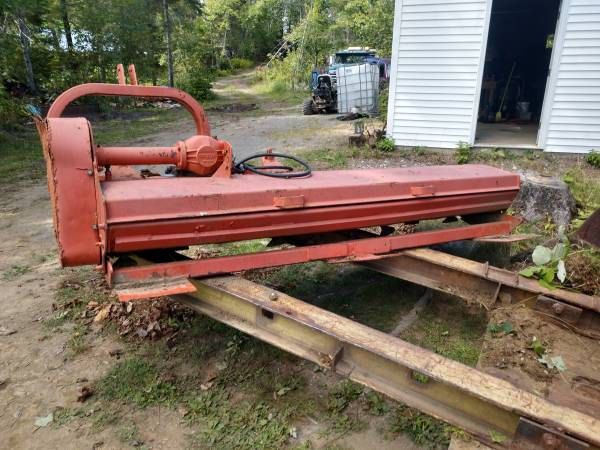

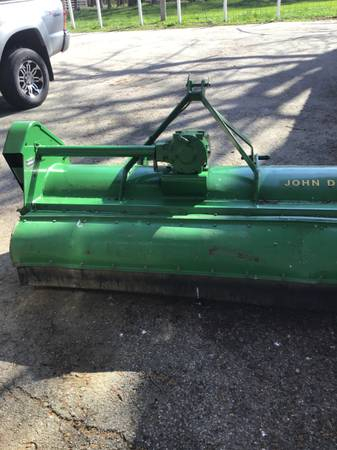

There's also a rough looking seppi smo 225 within a few hours drive for $2400 and I think maybe a Deere 25a looks like new for $2k a few hours away.
