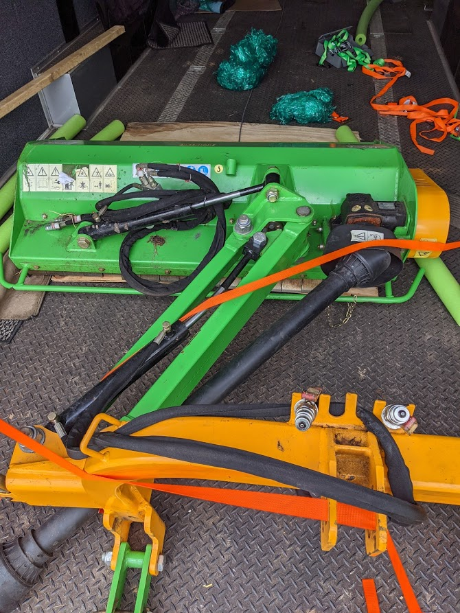

So guys, I have been trying to read through this thread but I jumped in at the end here because I ran across a Nova ditch mower for sale at a golf course near me. The claim they did not use it a lot because the angle and length of their ditches were to steep. They are ordering a RC on a boom. $1200 so I jumped on it. Hopefully a good purchase and should work well with the grass at my place (I hope) I'm so new at this I know I am going to make a mistake or 2 and this may or may not be one :)

Great buy and sure to be handy. If it doesn’t work out let me know. Trying to decide between a side shift or ditchbank model.
