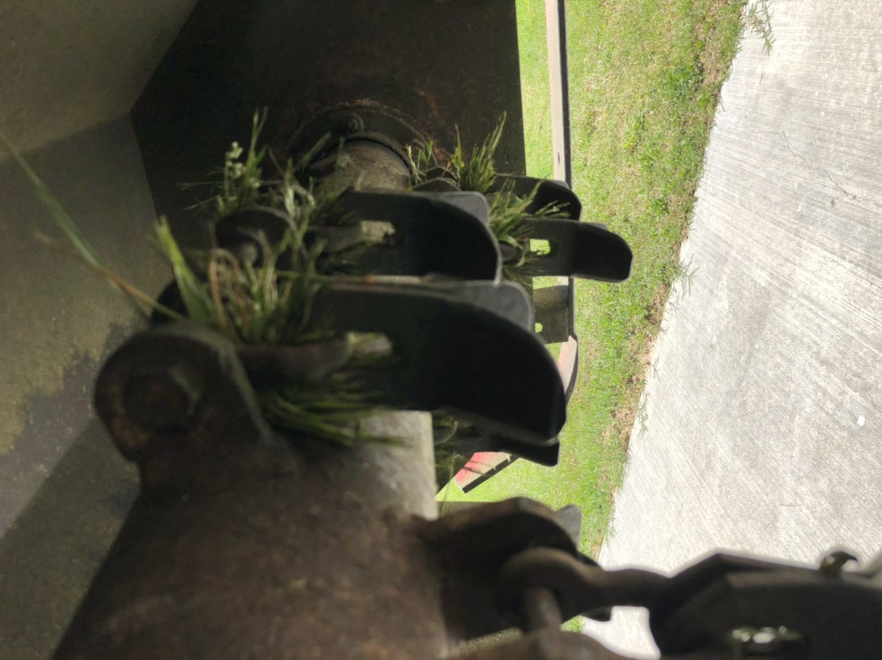

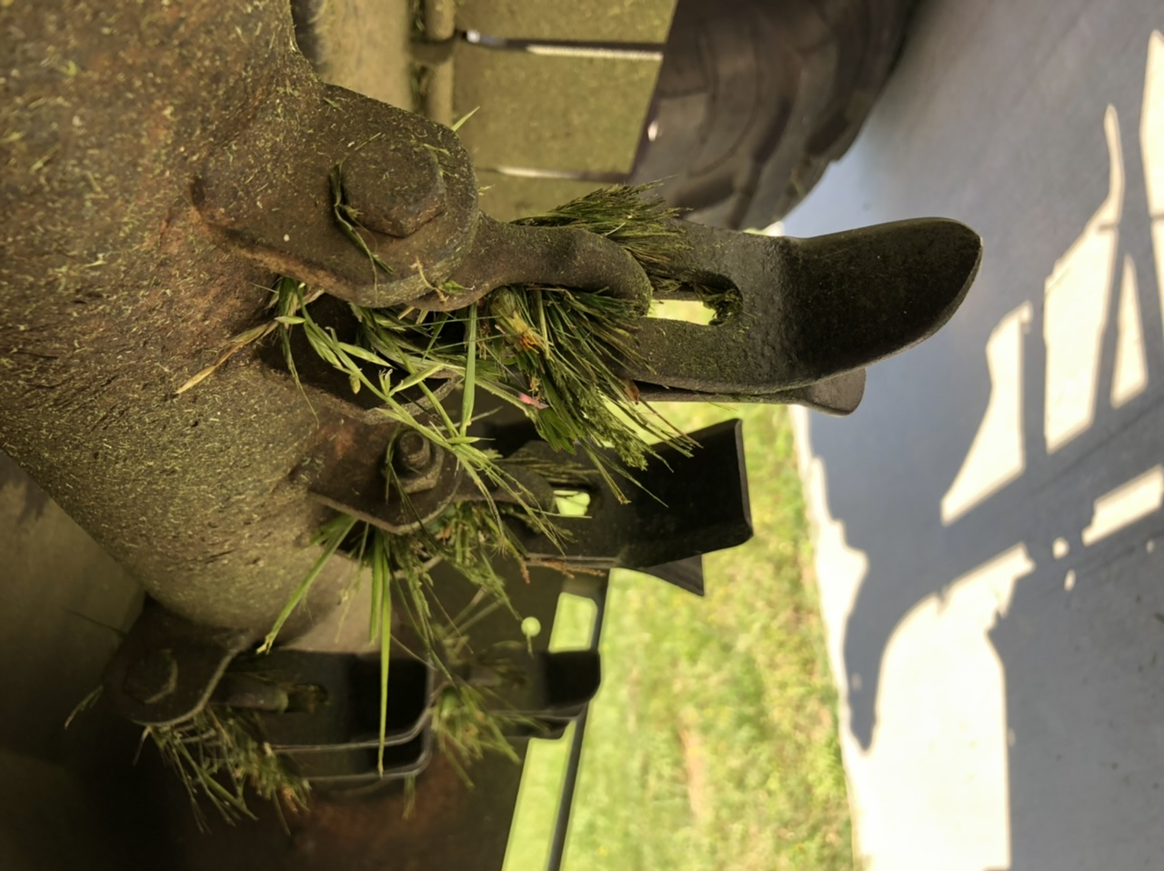

Revisiting my interest in replacing my Y blades now that Spring has arrived. Here’s some photos of my blades. Most have been reversed in the past by others and a few are fairly new. Due to the cost I’m wondering if I would be disappointed with new blades or would it be a WOW moment? (sorry that they posted sideways)

I see some of your knives have been replaced (nice and square tipped) where others are very worn and rounded. Mine are just like yours mechanically except that mine have a pin with cotter key instead of the bolt holding each clevis in place. Is yours an Alamo ?
So long as it is not vibrating and shaking too badly I would just replace the knives one at a time as they fail or get torn off (or get so badly worn they beg for replacement.) I do not think you would notice any great big change if you replaced all the knives. Obviously it would do a little better, cleaner cut but probably no "Wow." I'd be tempted to cycle through and replace just the very worst worn ones.
Cost ? Hmmm. I have found the knives to be pretty inexpensive at a local JD dealer who provides parts for the WV State Road Alamo flail equipment. They were cheap enough I bought a dozen or so just for spares.

Those look very similar to the Flailmaster FM7 blades I use on my JD 25A flail. Bought a bunch when FM was closing a couple years ago. I mean like 2 complete sets plus blades for my JD 390 flail. It helps that i drive by FM every day on my wayvto anf from work. The FM7'S were like $1 ea at the time. Definitely check out Flail Master for replacement blades. They may even have bearings. LMK if you need assistance with an order or to pick up parts.

Thanks for the offer. Its good to know definitely that Flail Master is still in business. I have a Caroni mower they don’t list in their online catalog but hopefully they will have parts that will fit it. Agri Supply wants about $7-8 per blade.

Good grief! My Alamo knives are about $1.35 each. That is the heavier "Y" style (there are lighter ones and heavier ones, both stamped steel.) Used in pairs and hung on clevis just like TethroB shows above. Note these are reversible too so JethroB may have some knives he can reverse if they still have plenty of metal in them. Maybe he already has ?
