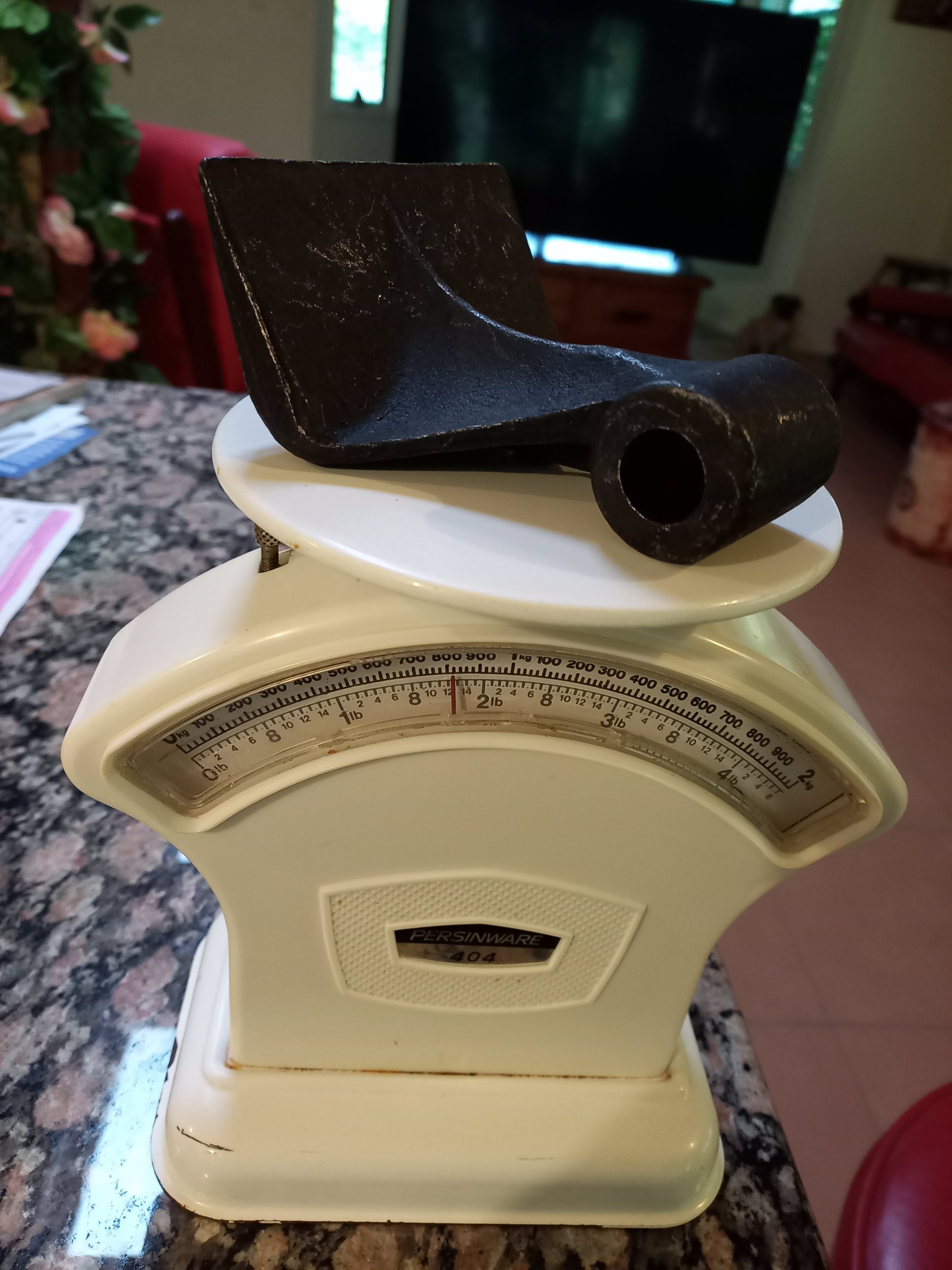

Hmmmmmmmmmmm,, how about some Country "Engineering"??
Why not treat those new flails sorta like a rotary lawnmower blade,,,
if the new ones are a little too heavy,, "adjust" the weight with your angle grinder.
Pick a spot that is not too functional, and grind away the excess weight.
All's well that balances well!! :cool:
... and a year from now when ONE of the paired hammers you put on that matches none of the rest on the mower gets busted or replaced and then again later another and very quickly you do not know which is which and you cannot find the different weight culprit. I hope it shakes your teeth out. And it will.
There is ingenious country engineering and then there is short sighted admiration for what should be a very short term fix.

To bad he couldn't toss the mystery hammers on a scale if he needed to.
Grinding to balance is perfectly reasonable. How many flywheels & driveshafts have a hole drilled on one side or tab welded on from the factory? I'm sure the rotor itself was balanced with one of those.
You want to get it reasonably close on balance, but it's not a Swiss watch. At any given point in time the dynamic weight of grass & stuff bouncing around under the hood is going to be causing similar balance issues.

yeah if they were all exactly the same weight I could see his point. I did ask for advice, so I won't knock anyone for giving their opinion, however 'I know it all' it might sound. ;) I don't usually put my teeth in while I'm on the tractor anyway, so no worries about them getting shaken out 🤣:ROFLMAO:
I did put two blades on the opposite ends of the same rows that I put the newer blades on. If these were already worn significantly, I'd just replace all of them, but it's literally new with less than 5 hours on it. I'll keep an eye on it, and if I have to buy some more to match, I can and will, OR I could just grind the new ones down to match the weight. on the 3 OEM blades I took off, there was a half ounce difference from one to the other, and as someone up there said, they're going to pick up some chunks of grass/mud occasionally until it slings off there's going to be a bit unbalanced anyway.
maybe, instead of grinding the new ones, I could just add a washer or two on all of the original hammers, there's a tad bit of space in there to do so. so as I buy more replacements, I won't have to grind them. I will make sure to keep the belts checked and the fittings greased, bearings aren't that hard to replace :)

I compared a new Caroni brand Y blade weight to the compatible Flail Master made ones. Both 4.4 oz according to the nice lady at the post office. If you are searching for flail parts call FM. Some items aren’t in their online catalog. Made mostly in Tennessee too.
   / Let's talk flail mowers #7,430
I just weighed one of my hammers. It is 1 3/4 lb.
