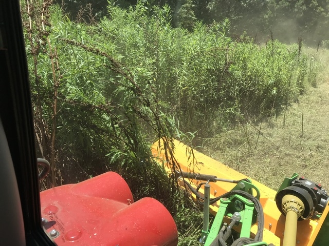

I run a 64” Victory ditch bank mower that weighs 685 LBS on my Branson 4815C. My tractor weighs somewhere around 4,000 lbs with cab and loaded tires. It handles it well but you definitely feel it when you extend it all the way out off of the ground. But never felt tipsy and I run without FWD engaged. Don’t have a picture of it fully extended in the air but here is the way I mow 90% of the time.

How do you like that? I have pretty well convinced myself that I would prefer something like this to an RC. I need to keep cost down, but I don't want junk either.

I really like it and glad I bought it but I did have to replace the pillow bearings on the rollers. The ones that came on it did not last long and I am very conscientious of keeping them greased and the grass cut off. I put a much better bearing on but had to modify the housing to get it to fit. Interesting enough grass doesn’t wrap around quite as bad.
My dad warned me when I bought it that I was not going to like it because of the maintenance it takes to keep it going. So far I have not found that unreasonable except when I decided to sharpen the hammers. If dad was still alive he would have gotten a call that day letting him know he was right! That took half the day and I have not run a grinder that much since I quit building trailers. :oops:

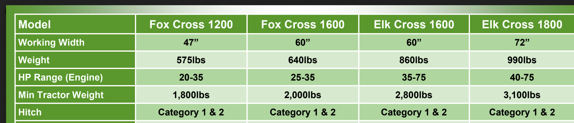

Yeah, I'm just getting advice all over the place, trying to compare apples to apples. Peruzzo lists pretty mowers as compatible with smaller tractors. My advice from a Del Morino dealer was more conservative. I'm not trying to be argumentative, but the only chart, or rule of thumb I have is the one attached.

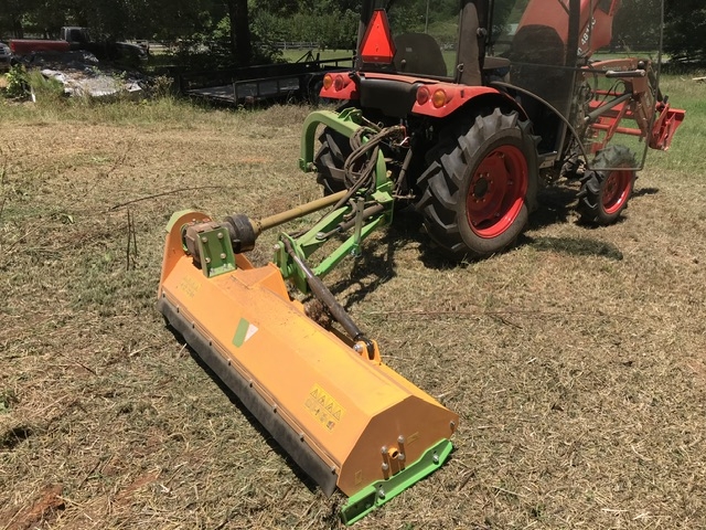

I have a Peruzzo Brush Bull 2200. Much bigger & beefier than those ditch bank ones listed. Apples to orange comparison though as ditch bank stuff has to be smaller & lighter.
It shifts over about 2 feet to the right from whats in the photo. 7.2' working width flail, 6' track width on the tractor. Lots of torque on the 3pt when its shifted offset to the side.

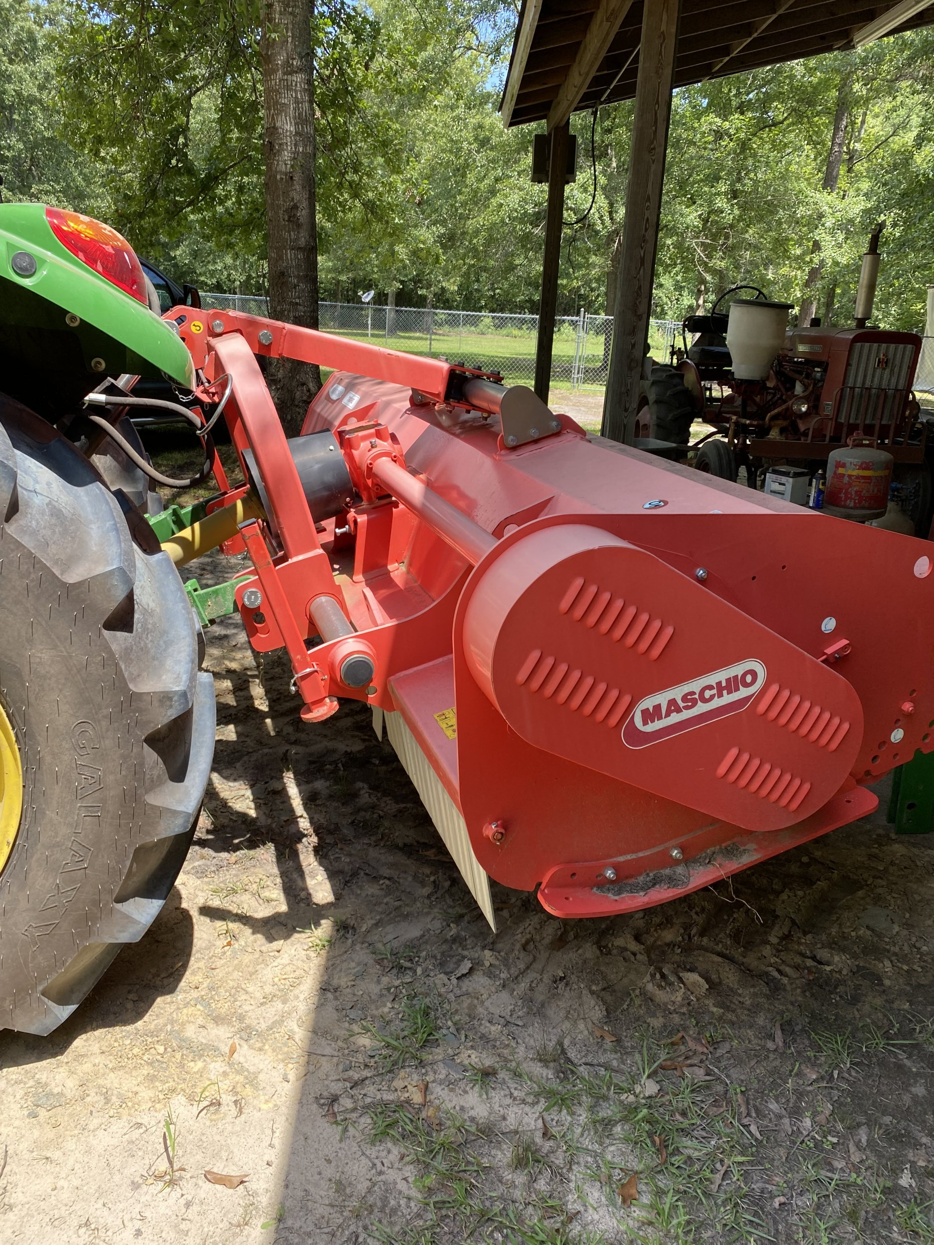

Here's my Maschio. Fallon hit the nail on the head. If you want a real flail one of these is the real deal. This one shifts both ways about 2 feet. 10' cut and really heavy. It runs hammers and is badass. I have a Hardee 4' hydraslide ditchbank cutter. That thing is a beast as well but does the job. Those offset flails are light and dangerous. Because of the weight they rate them for smaller tractors. Those things are an easy way to end up in a ditch or upside down.
