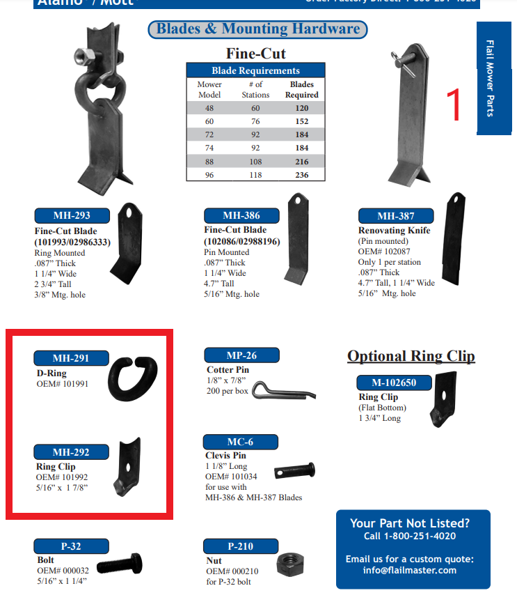

Hit a hidden rock in the weeds last weekend and monkeyed up a whole section of blades on the drum. For now plan on just beating them back into shape on the old anvil.
Come winter though I was thinking about maybe putting a heavier duty blade on since I'm mostly doing bushhog type work with it. It's a fine cut 88" Alamo that uses the long thin blades like #1 in the picture. I'd like to use the parts in the box to swap to one of the blades with a 1x1/2 hole in it, like a heavy duty side slicer or a duck foot. The ring is 3/8 instead of 1/2 but that's only 1/16 on either side and when it's spinning it shouldn't matter anyway. Is that reasonable?

If you do this the flail mower rotor will become unbalanced. The best thing to do is simply
remove the opposite knife mounting station if you do not have the identical knife to replace it
and raise the cutting height of your beautiful flail mower.

I'm talking about replacing all the blades, not just the mangled ones....long as you're using the same blades at every station balance shouldn't be an issue I'd think...
