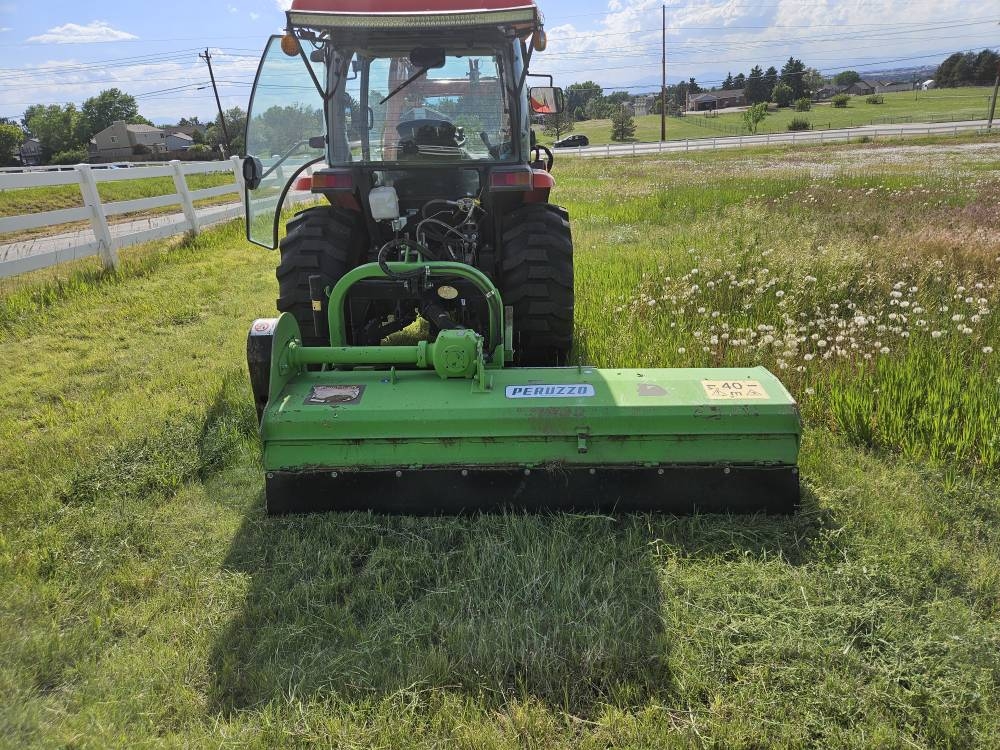

You have more HP than my L4060, but the same frame. My 7.5' Peruzzo Super bull is 1,500lbs & the max I should be lifting. It's probably a hair big to be honest, but I like it.

I never take the loader off. I can't be bothered to take the 5-10 minutes to do it. I've taken other Kubota & JD loaders off but haven't bothered with mine in the 1,000 hours I've put on it. I usually take the bucket or forks off though.
