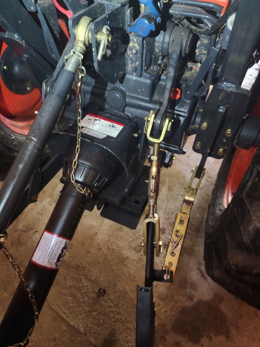

The turnbuckles to adjust tilt are the same length. The left one is just a fixed rod, with a turnbuckle on the right (to allow for leveling, I'm assuming?), and the lower arms sit level with nothing attached. I'm assuming it came level from the dealer, and I haven't putzed with this much since I bought the tractor, as I've never had the need. Not my tractor, but this is a pic of an identical tractor's rear setup:
There are no chains on the rear. Would these be to adjust the lower arms side-to-side? I have a solid bar on each side that sits in a channel and gets pinned at a certain length that controls how far in/out (L/R) the arm sits. Once I get the attachment hooked up, I make sure I use the same pin holes on both sides and I know my attachment is centered.

   / Let's talk flail mowers #8,197
When turn buckles or chains are used on the lower links
they prevent the lower links from shifting from side to side
your mule does not have that ability.
If your mule has the same hoisting arrangement for the
integrally mounted 3 point hitch implements you will
need to tighten the turnbuckle at least 3 threads to
prevent the mower gearbox from hitting the ground
when you rotate the flail mower shroud to vertical.
As this mule has no owner useable adjustment for the
lower links other than the right turn buckle you will have
to use the right turnbuckle to shorten the right lower link
to increase the height of the mower when it is rotated to
vertical and lock the draft control.

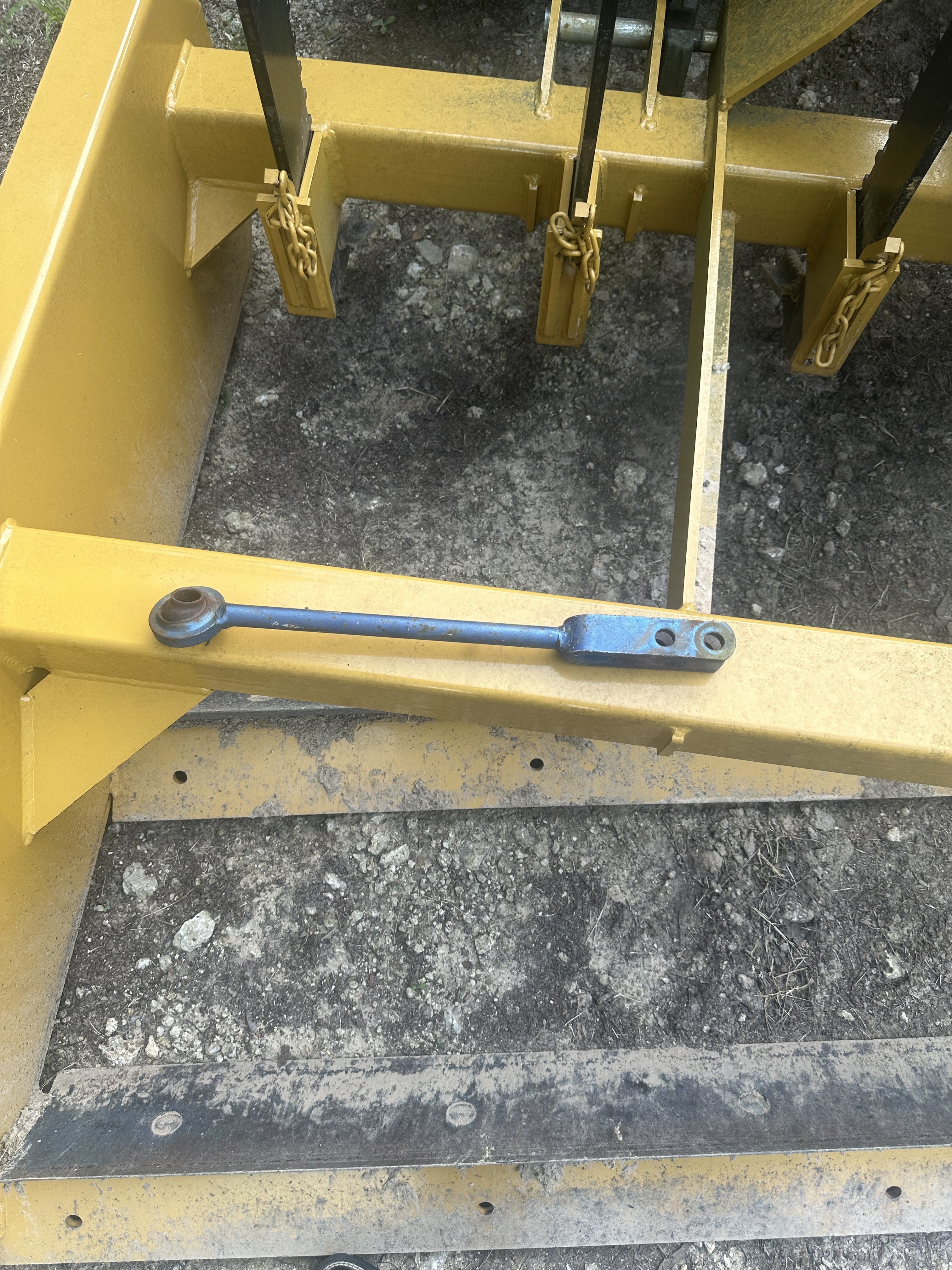

You could remove the left lift arm side link and drill another hole about an inch above the bottom hole. Then use this new hole when you reinstall. Then adjust the right lift arm to even things out again. That should give you plenty of lift.
Like this arm that was on my Kioti.
