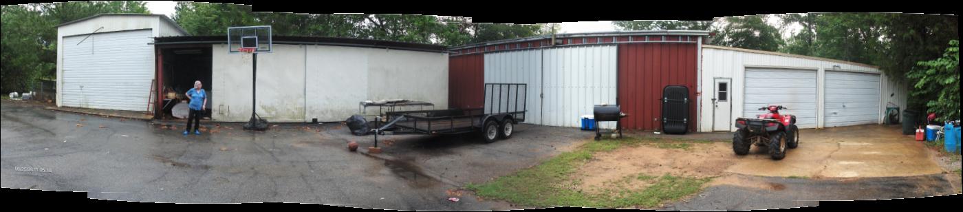

My vote would be for multiple buildings or really big and subdivide. I've got 4 main workshops.
From left to right
A 14' tall RV shed I use for storage and vehicle parking
A 10' tall shed for my sawmill and tractor implements
A 12' tall shop primarily for tractor, vehicle , welding etc.
and on the far right a 10' to 9' workshop I'm going to be using for woodworking and small gardening/maintenance.
When we bought about 2012 I thought it would take me years to fill up. An F350 and a 50 hp tractor helped to fill it up fast.
But with the separate buildings I isolate my sawmill (LOTS OF DUST, woodworking (some dust) and "repair" areas (grease and oil).
Just be sure to include off floor shelving systems for LOT's of storage.
I presently have about 150 linear feet of pallet racking, much of it 12' high with 3 to 6 layers of storage. Virtually all of it still has 1 or 2 layers empty for future storage. About 50' of it has the bottom layer used as a workbench with storage across the back.
