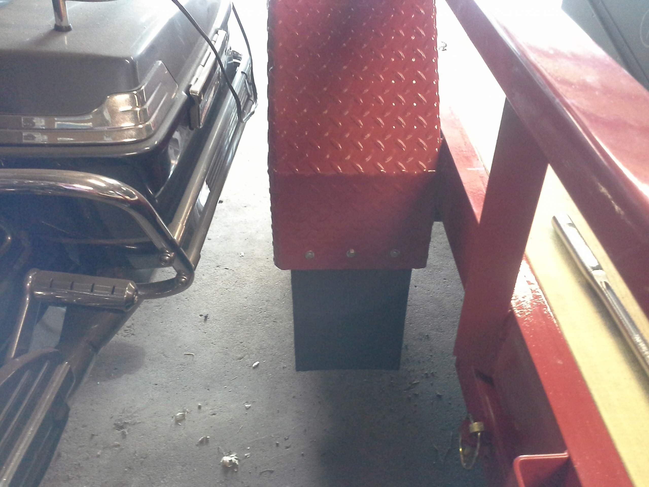

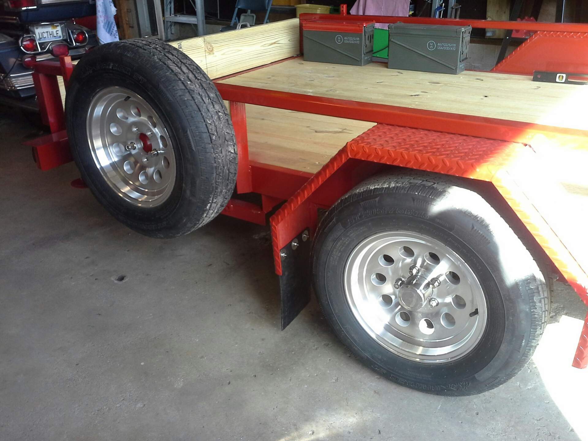

Mud flaps.
   / Lets talk small utility trailers,78 inches wide x 14 feet long.
#82

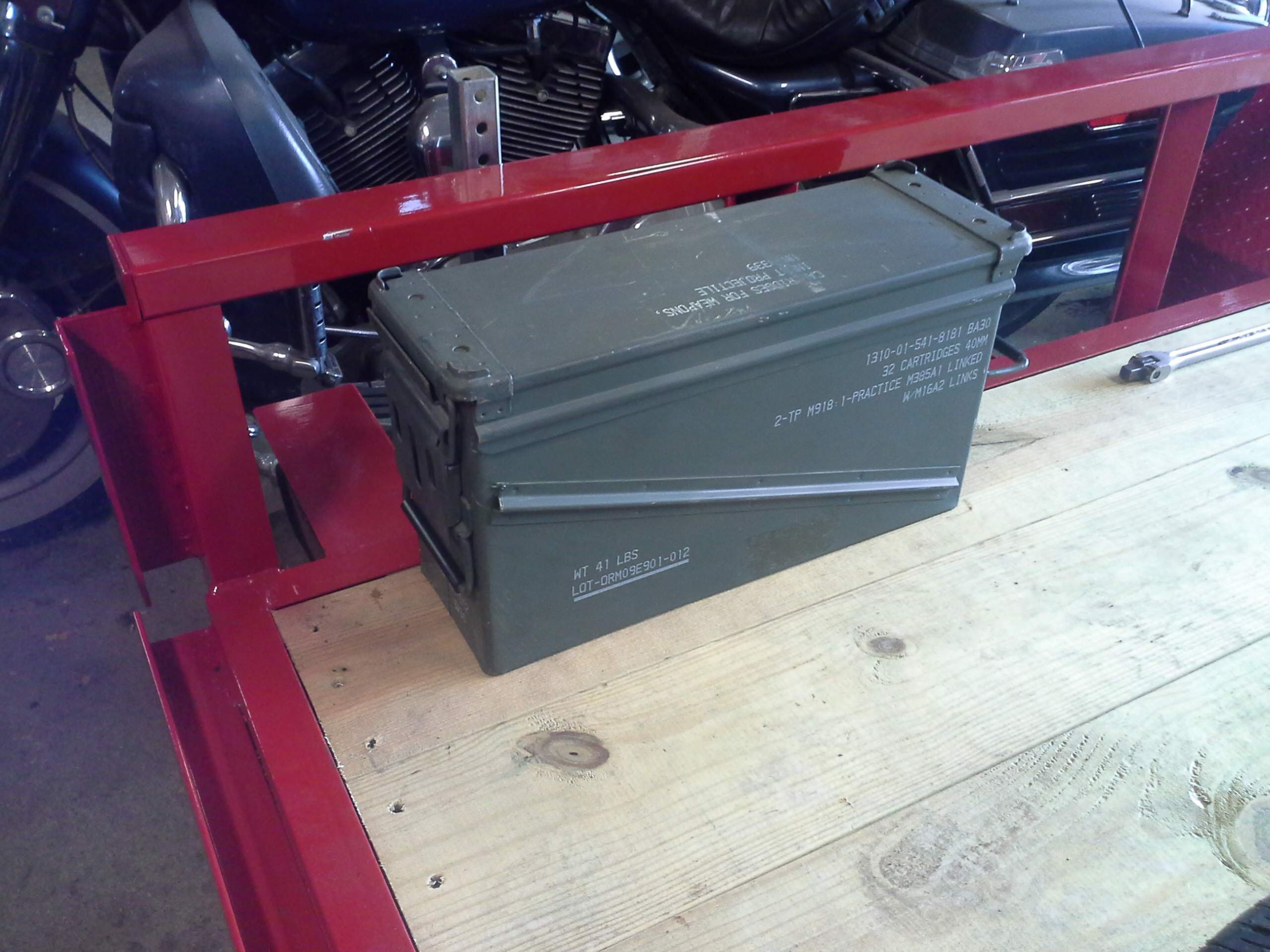

Spare tire bracket.
40mm ammo cans.

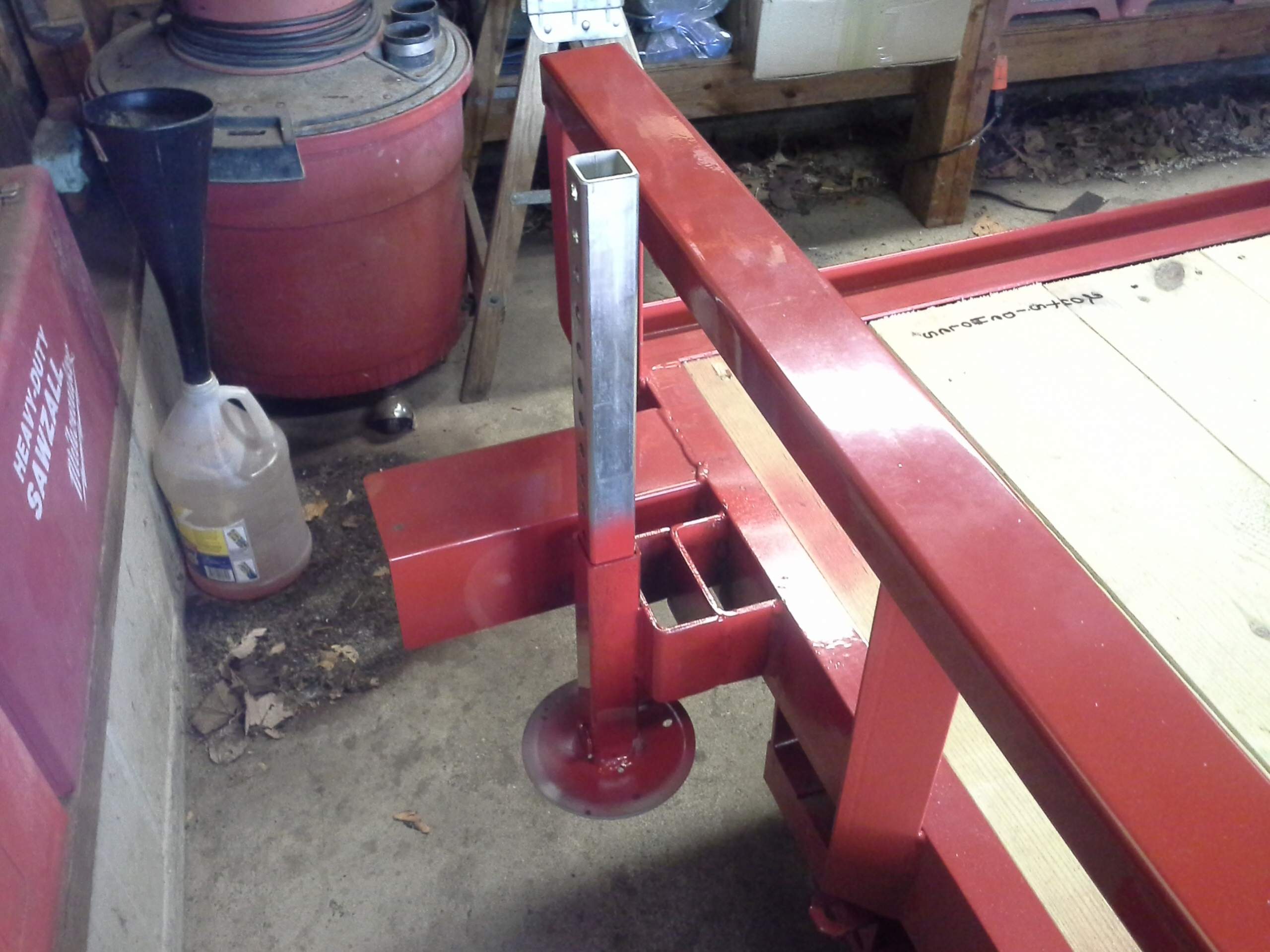

#83

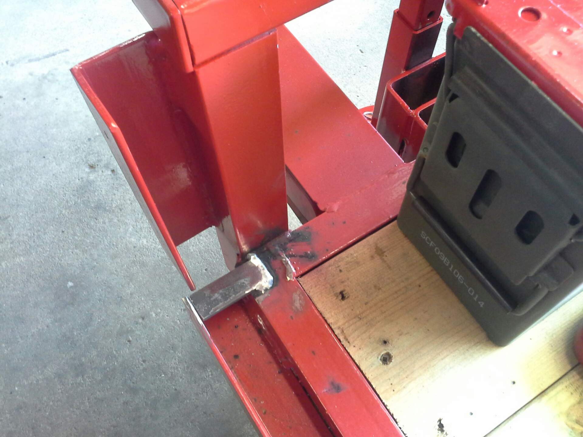

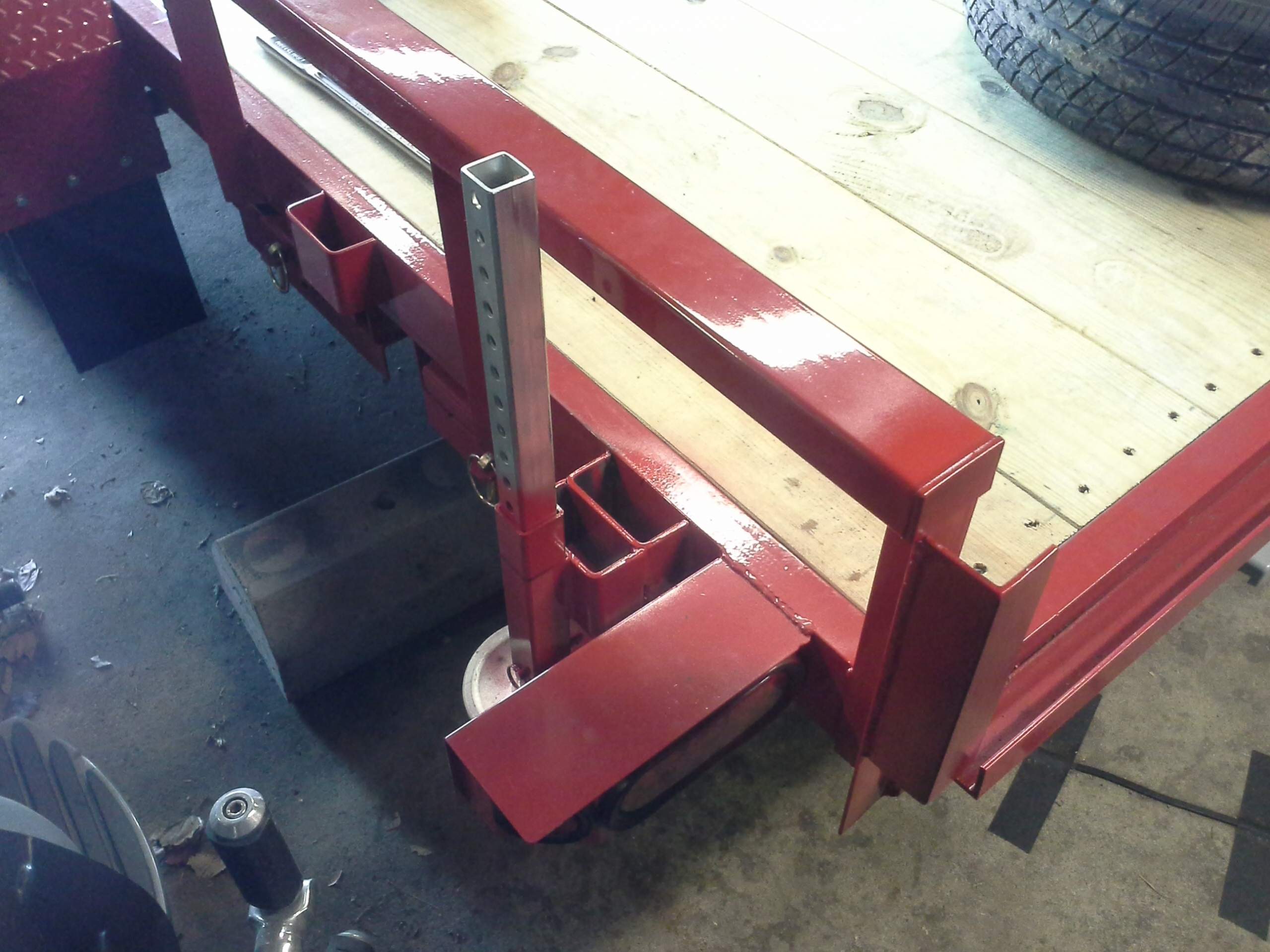

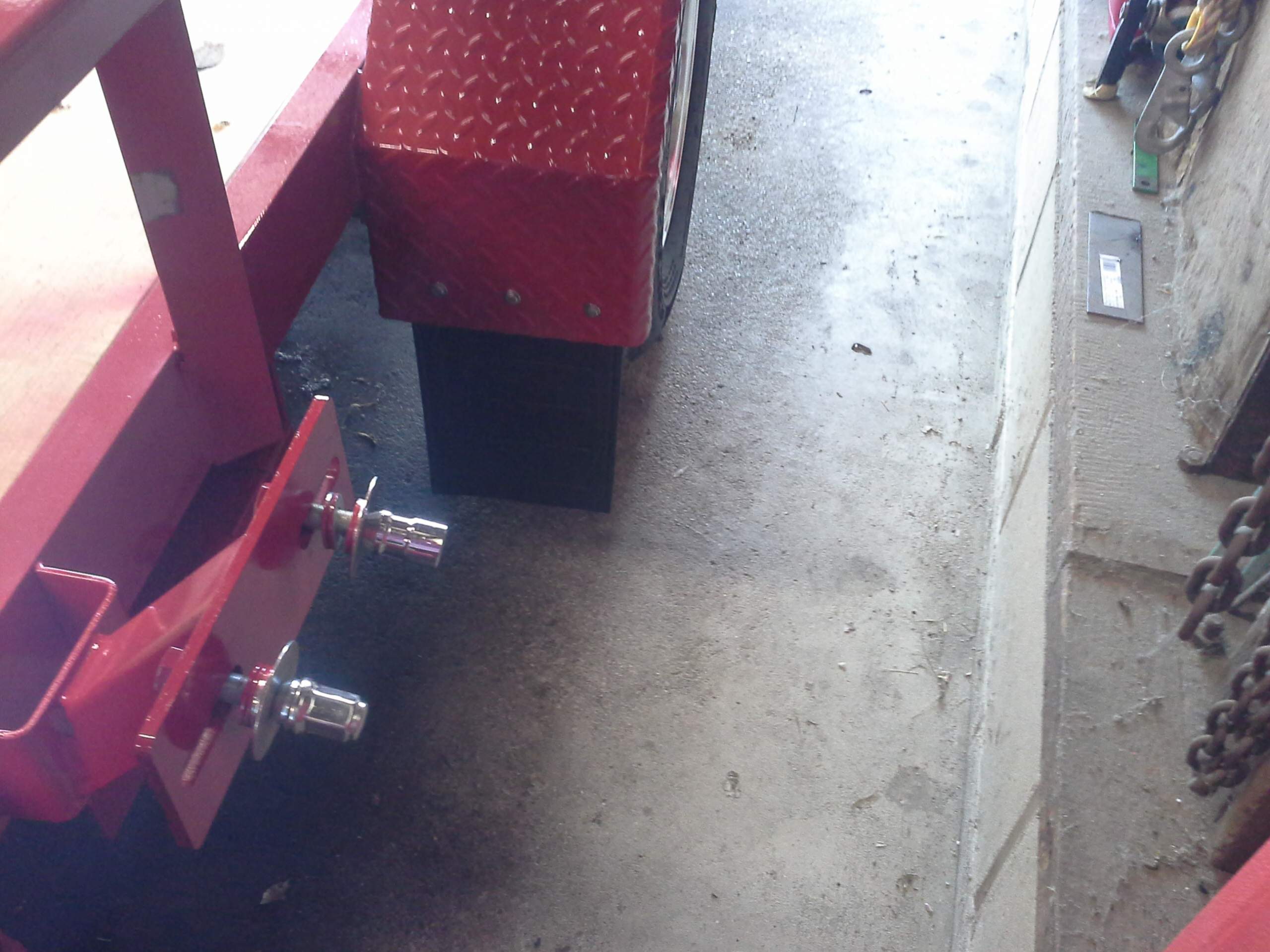

Rear drop leg stabilizer support jacks.

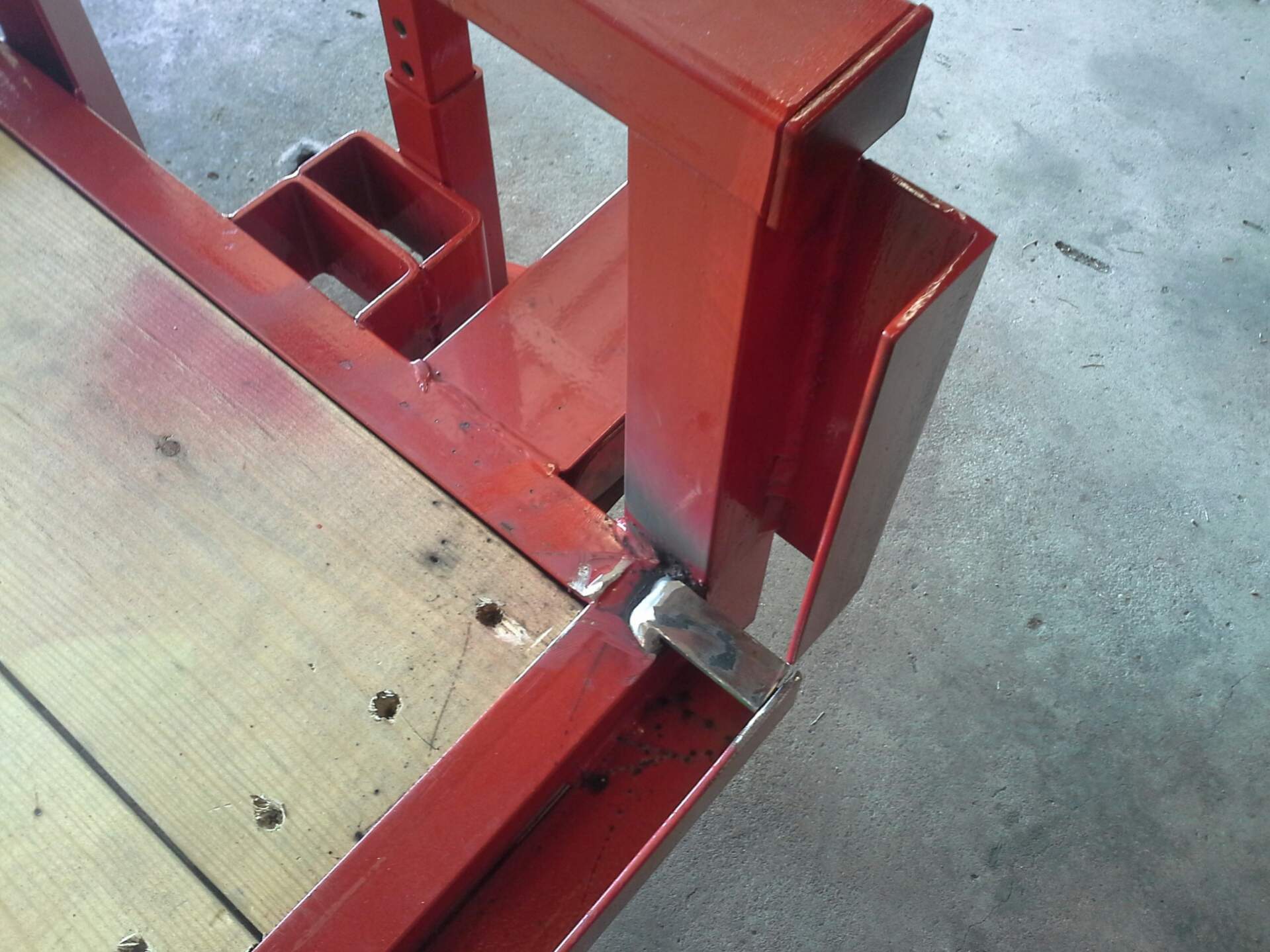

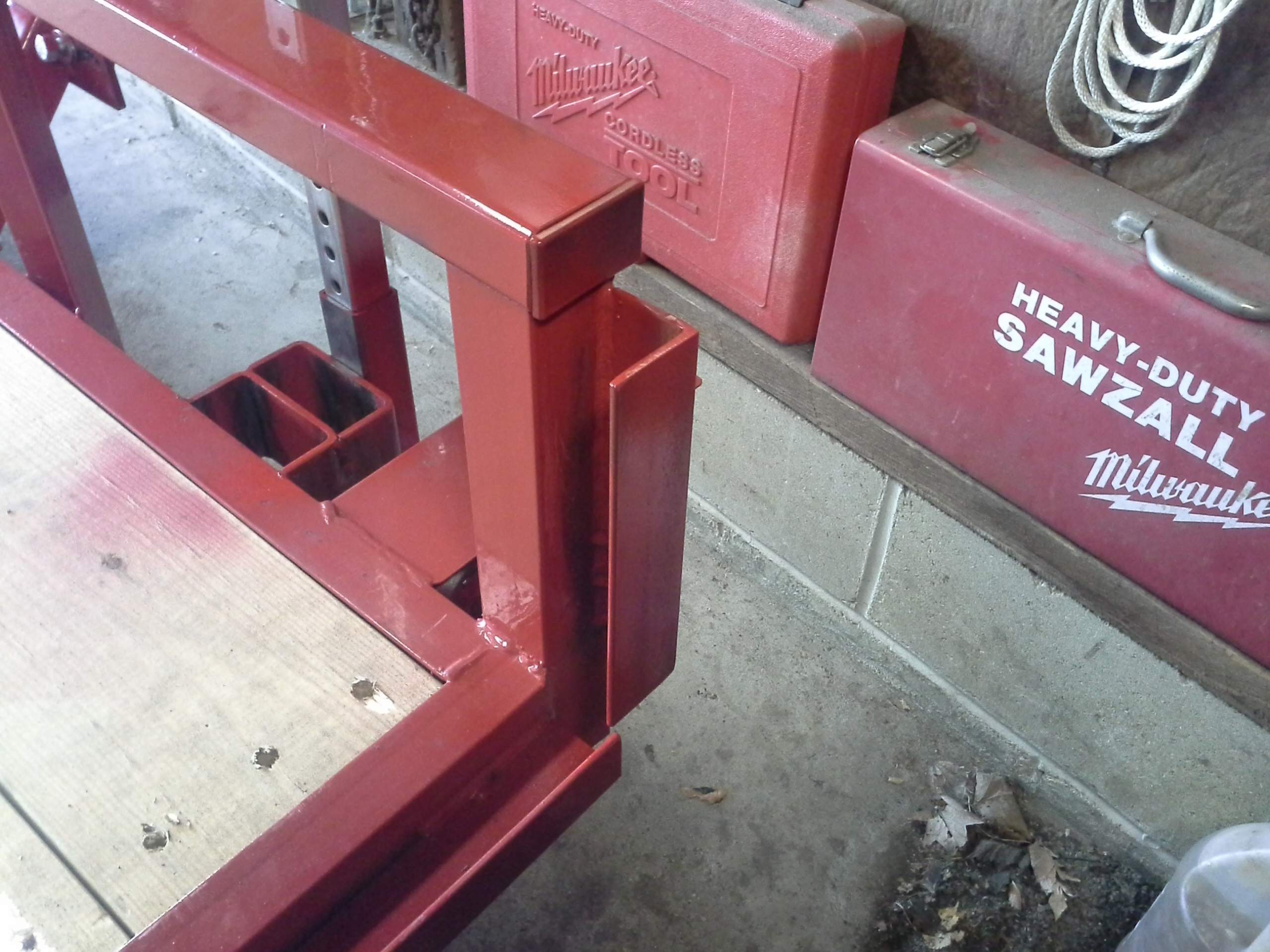

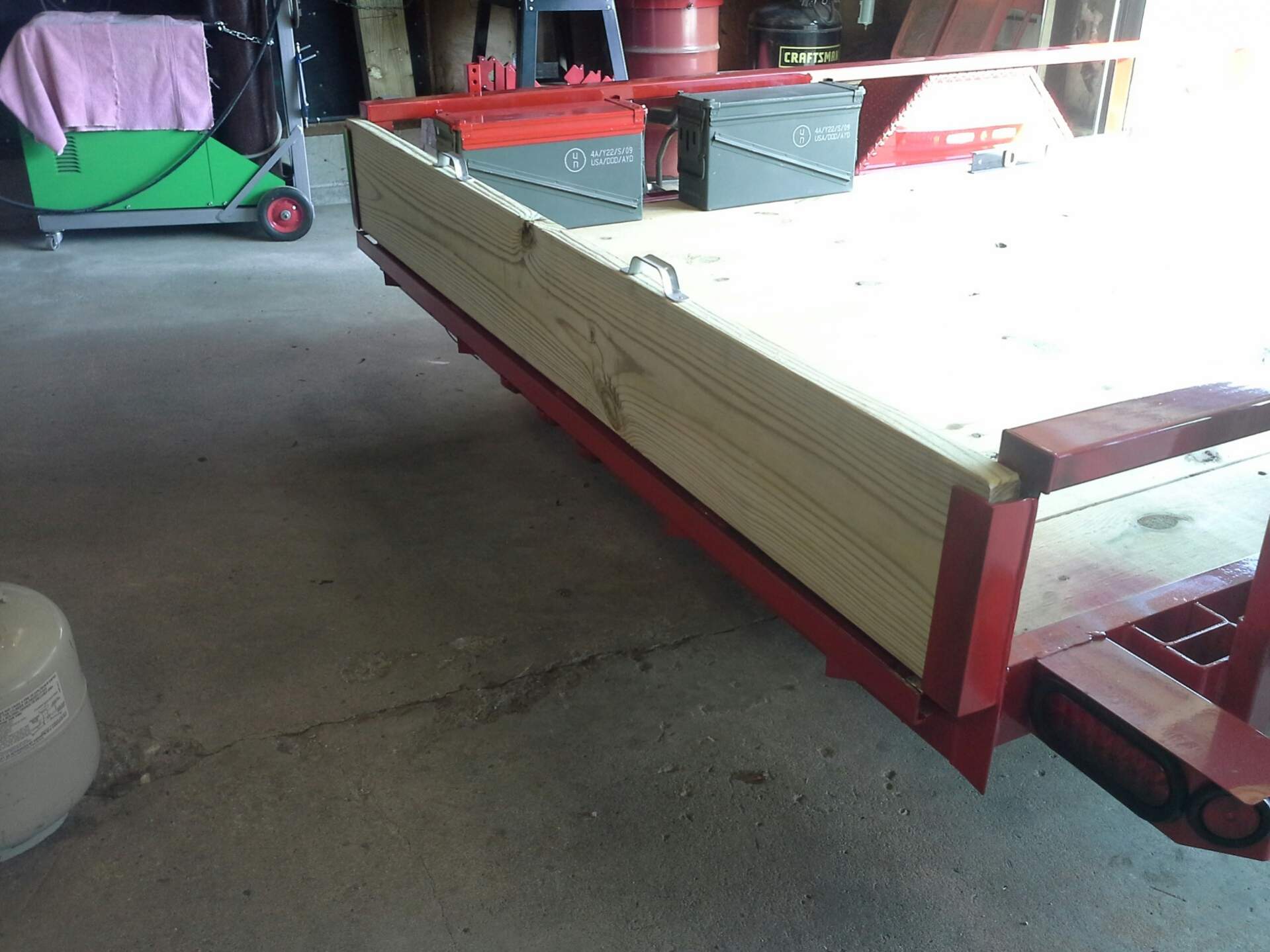

#85

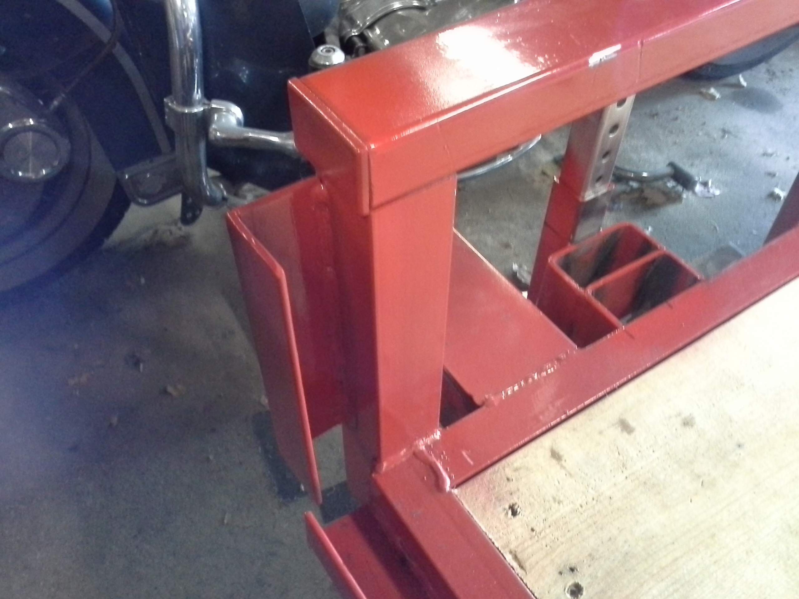

Board drop for my rear gate, 2x10=treated?
#86
I like those. Did you buy them or make them?
I bought them at the time I picked up the trailer but I welded two stake pockets together and then
welded the sleeve to the stake pocket.

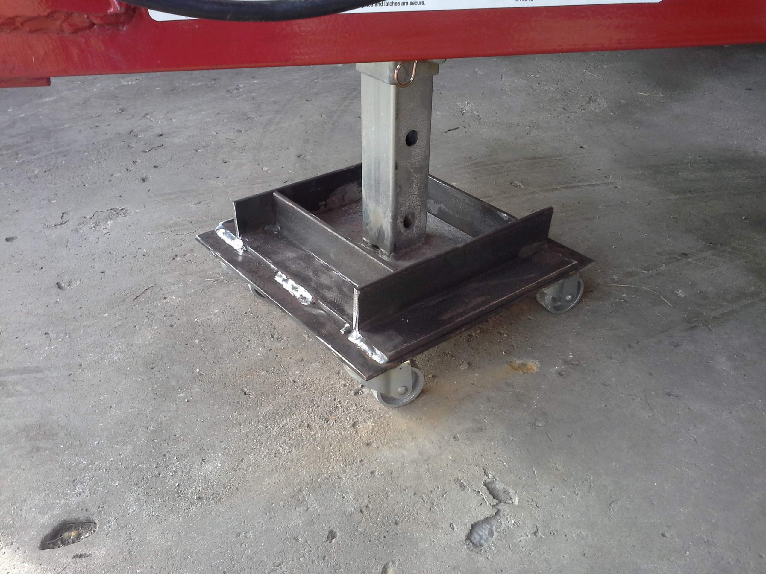

Here are a few pictures of the stuff I've added to make my trailer more to my liking.
I set my jack pad into this gizmo, I can wheel the trailer
around the drive way and garage like nothing at all.
i like this. may have to steal your idea. using slightly larger pneumatic wheels and i could use it around the shop
#88
All they are is 2 inch cast steel wheels.
The base plate is 12 inchs square, by 1/4 inch thick, the angle iron is 2x2 inchs by 1/4inch thick.
My foot pad was 6 inches by 8 inches, bigger than most I see.
I for sure am glad I didn't get a tandem axle, I would never move it around like a single axle.

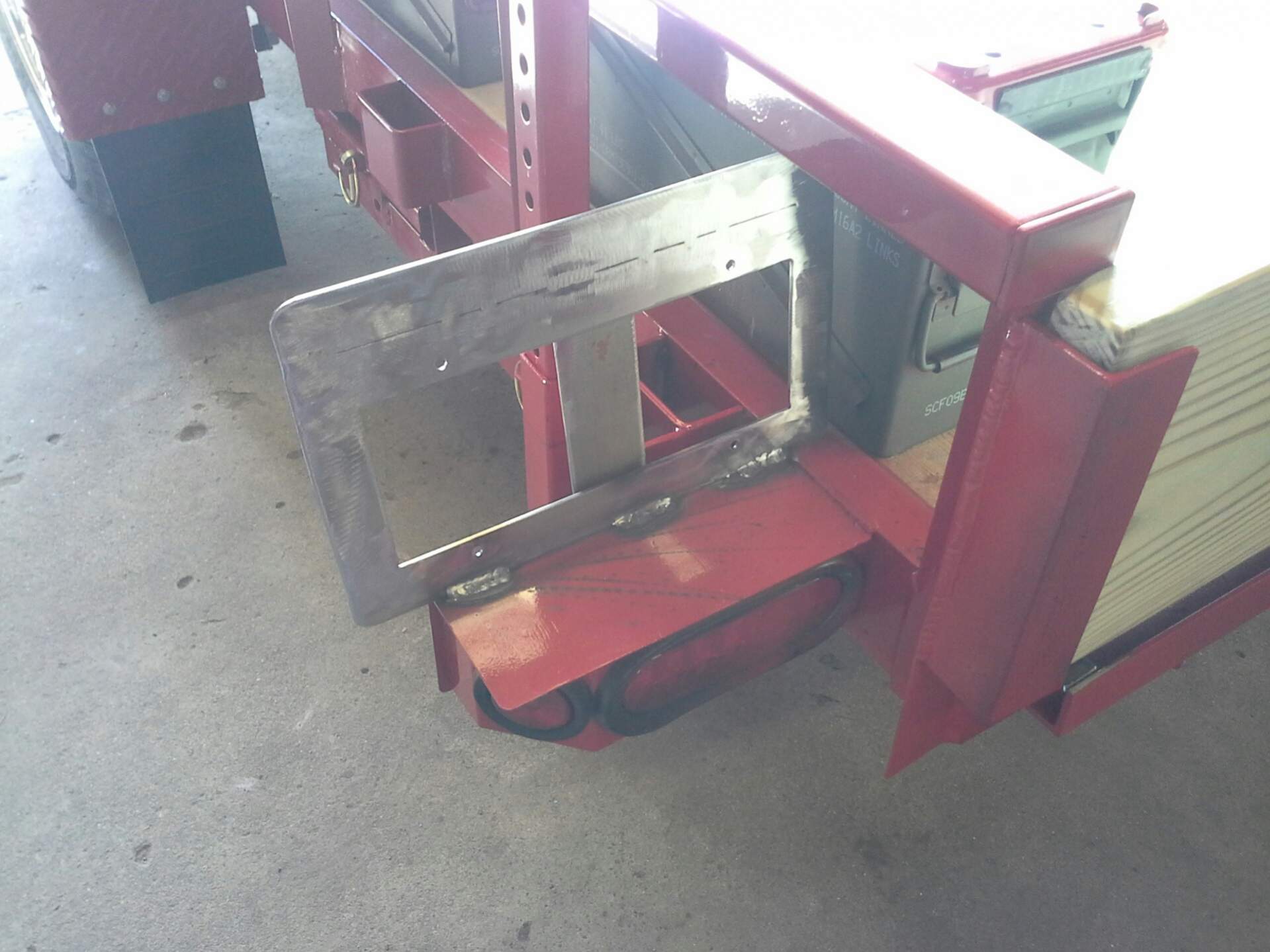

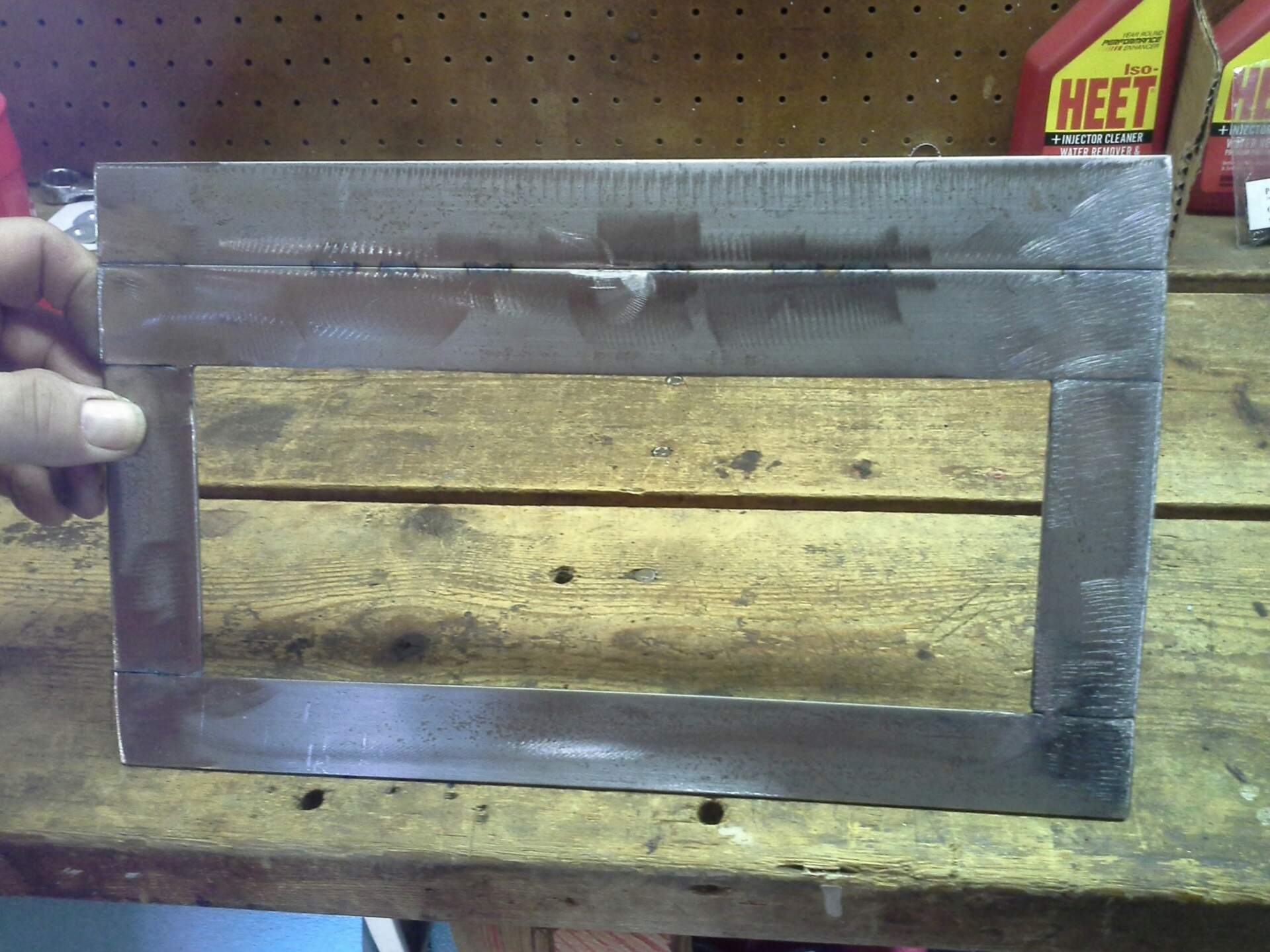

Every Saturday is my day to tinker on the new trailer, today was no exception.
I didn't like where the original license plate holder was located.
So, I made a frame out of 1.1/2x1/8 inch flat stock.
I new LED plate light is on the way to my house.
Also bought a 2x10 treated for the rear gate.

   / Lets talk small utility trailers,78 inches wide x 14 feet long. #90
I made a tailgate for mine similar to yours. It did pop out once on a rural road so make sure you have a way for retention. I ended up using pins thru a hole with bushings.
