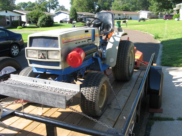

I tow a 1400 lb tractor on a 1020 lb single-axle trailer, although that is infrequent.
(NOTE: Tractor is hauled without the rotary cutter shown in the photo. I was just taking the whole unit to a truck scale for weighing on the day I took that photo)
Most of the time the trailer is carrying about 900 lbs or so (garden tractor and walk-behind brush mower) . Have not had any issues so far. Seems to tow fine.
As to "bouncing" when empty, it might a little but not a big deal, and anything that adds a little tongue weight cures that quick.
A concern for me was the empty weight of the trailer. I am bumping-up against the max tow weight of the vehicle, and a bigger trailer would be heavier, and thus carry a smaller load.
Another concern was storing the thing. I live in a typical suburban subdivision and I use it to haul equipment to some rural land I own. A bigger trailer would be harder for me to keep at "home."
I have no regrets at going single axle over tandem.
