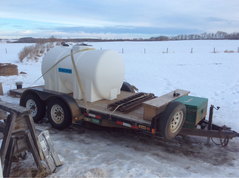

I have a 14' tandem car hauler that I use for hauling water to my house. The 14' works out great for water, but it is just to short to haul the tractor with any attachments. The box blade usually hangs off the back. I bought it used from a cousin, so the length is what I got. When I one day get a new truck I will buy a 16' deckover with tandem 7000 pound axles.
You will never regret getting tandem axle, but there is a good chance you will always question yourself if you buy the single axle. Way smoother pulling whether loaded or empty, as the tandem axles walk on bumps. When one axle hits a hole the other axle is usually still on the flat, so the trailer moves down half the distance.

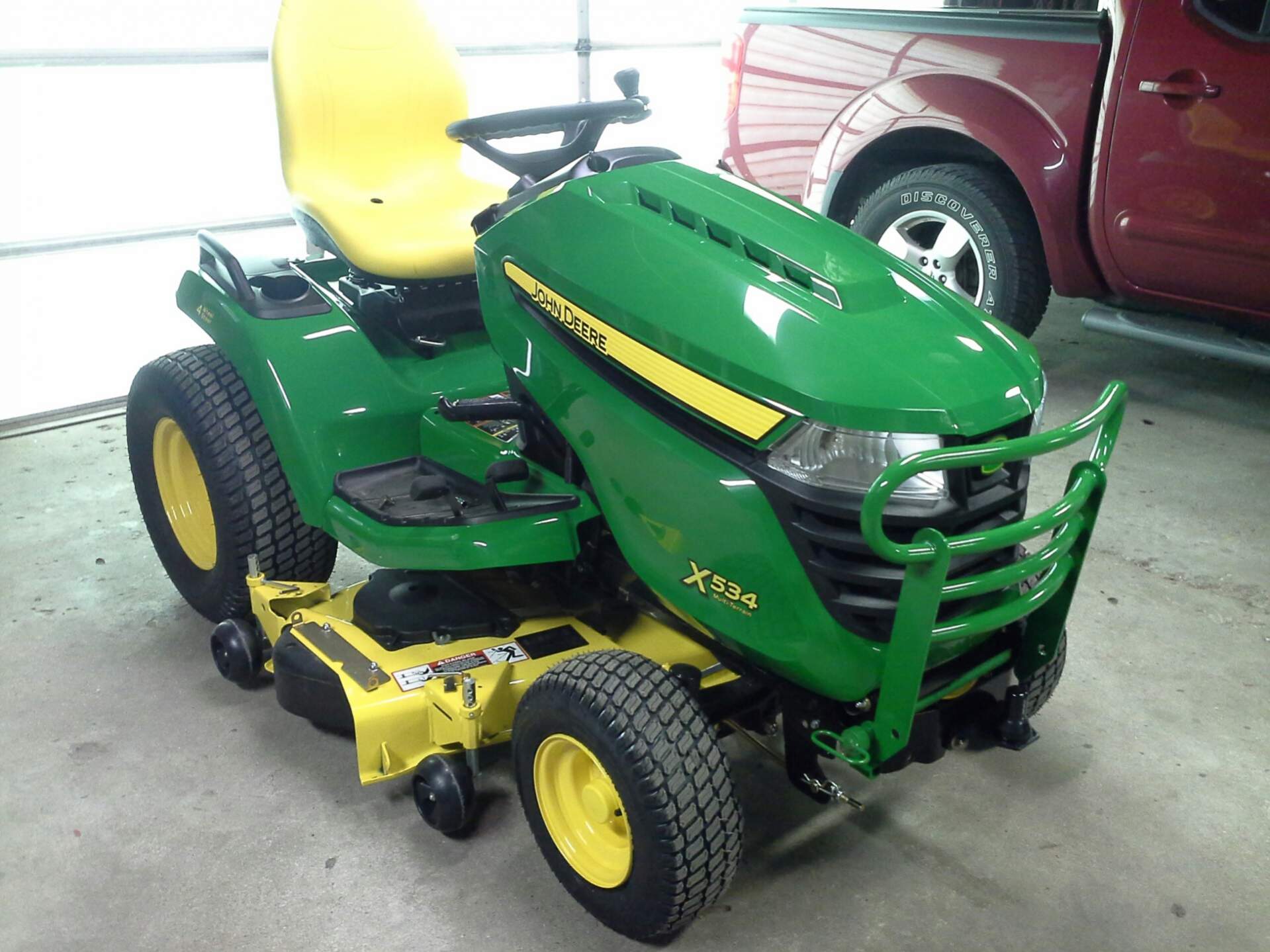

Mower

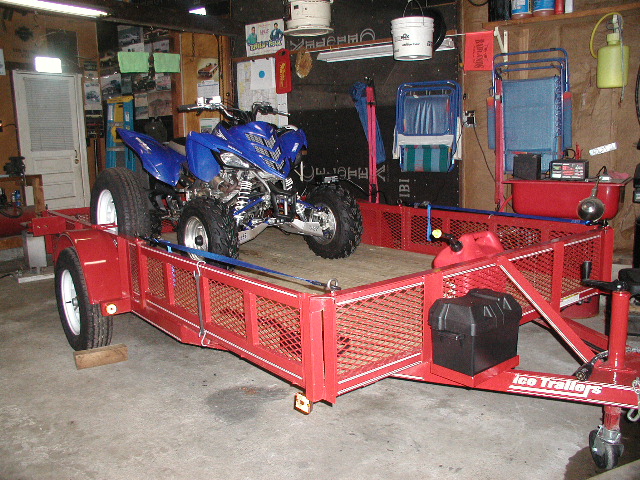

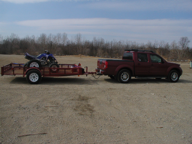

Rice trailer with thousands of miles on it.
