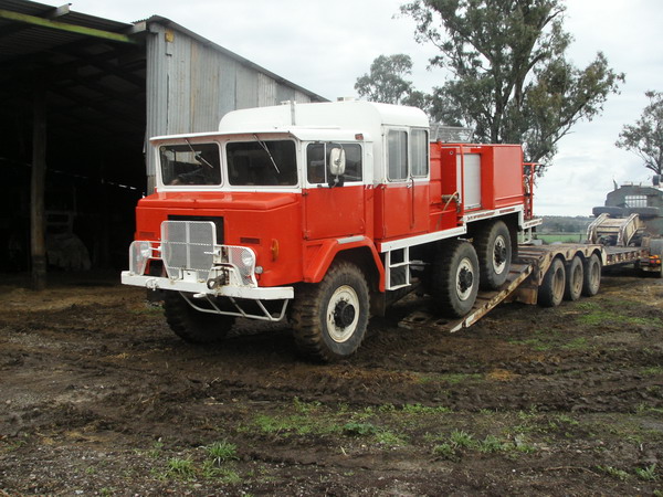

PS- Seeing we're taking about water, thought you guys might like to see our latest "new" second hand water truck that arrived this week, we've quite a few of these ex-army beasts for dedicated on farm use only to supplement our other farm trucks - used to cart for spray rigs, a mobile source for livestock & a firefighter - 6WD go anywhere & will be c.7000lt/1800US gal once we fit another tank behind the cab & will tow a trailer with 5000lts.
You're going right to the head of the class, with posts like that! :laughing:
