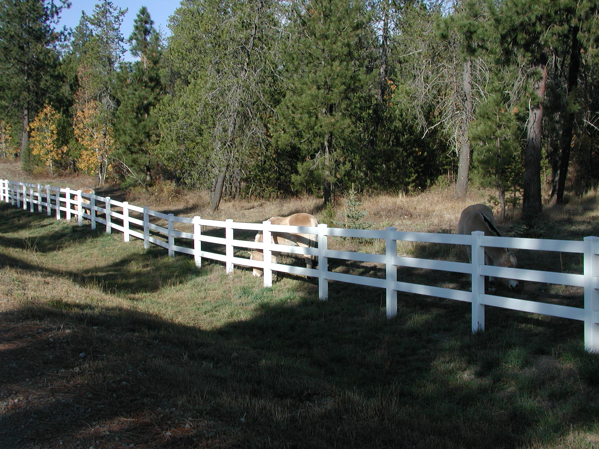

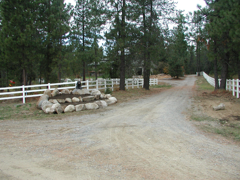

   / Leveling Fence Posts???? #9
laser level or string level....would not matter.
the problem is, no ones property is entirely flat. you cant set the top of all the fence posts to the same height, otherwise if you have a 4 foot hill, the fence posts may only end up being 6" tall.
We had about 1200 feet of white vinyl fencing installed on the front of our property. Its all rolling hills (slight rolling). They kept most of the posts the same length, and made it so the tops of the fence posts followed the rolling hills. No sudden jumps or drops, just a smooth rolling like the land.
The guys did this with simple string lines.
