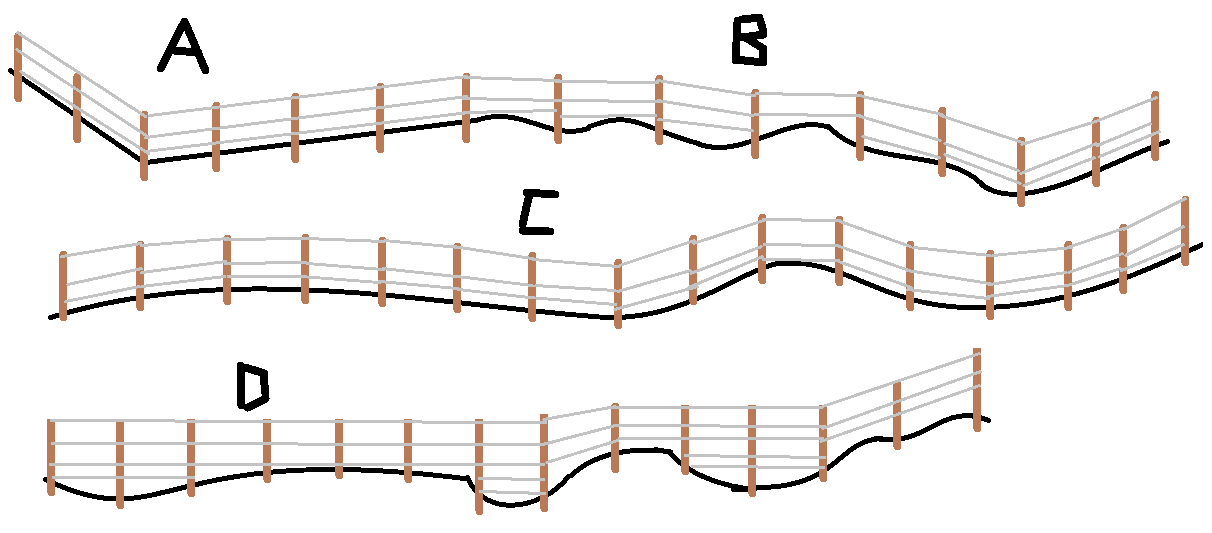

not best diagram in world. nor did i attempt to make it very accurate. but more of an attempt. to help visualize rough ground. to more even gentle slopes.
if ya using water level to get grade and better slopes. just get some long sticks. and space them out evenly. then get like red tape or something easy to see from some distance. and wrap tape around each stick, were you want the grade to be / slope to be. and bring in dirt or remove dirt. and use the red tape like markers of were you need to adjust things. the water level comes into play. of figuring out how much slope (rise (height) or run (horizontal distance) ya want to keep, over a certain distance. and allows you to drag water level to each stake. and measure distance between other ones. so you can get more of a constant 1" to 5" slope. as ya go over a nice gentle rolling hill.
once ya have a nice working slopes, that will allow fence to roll along with the ground easier. then it becomes much easier to set posts. put boards up and cut top of posts off, without having to adjust each board up and down.
if driving down a given road enough. were there are fence boards and you can them from a distance. you can make out sometimes the (ups and downs) that folks have put in, in attempt to get a more gentle curve in the boards.
but when you are up close and personal putting boards up. it may all look ok, but not from a distance. and it will start looking like an older fence with repair jobs done to it. couple inches there 3 inches there 4 inches there....
