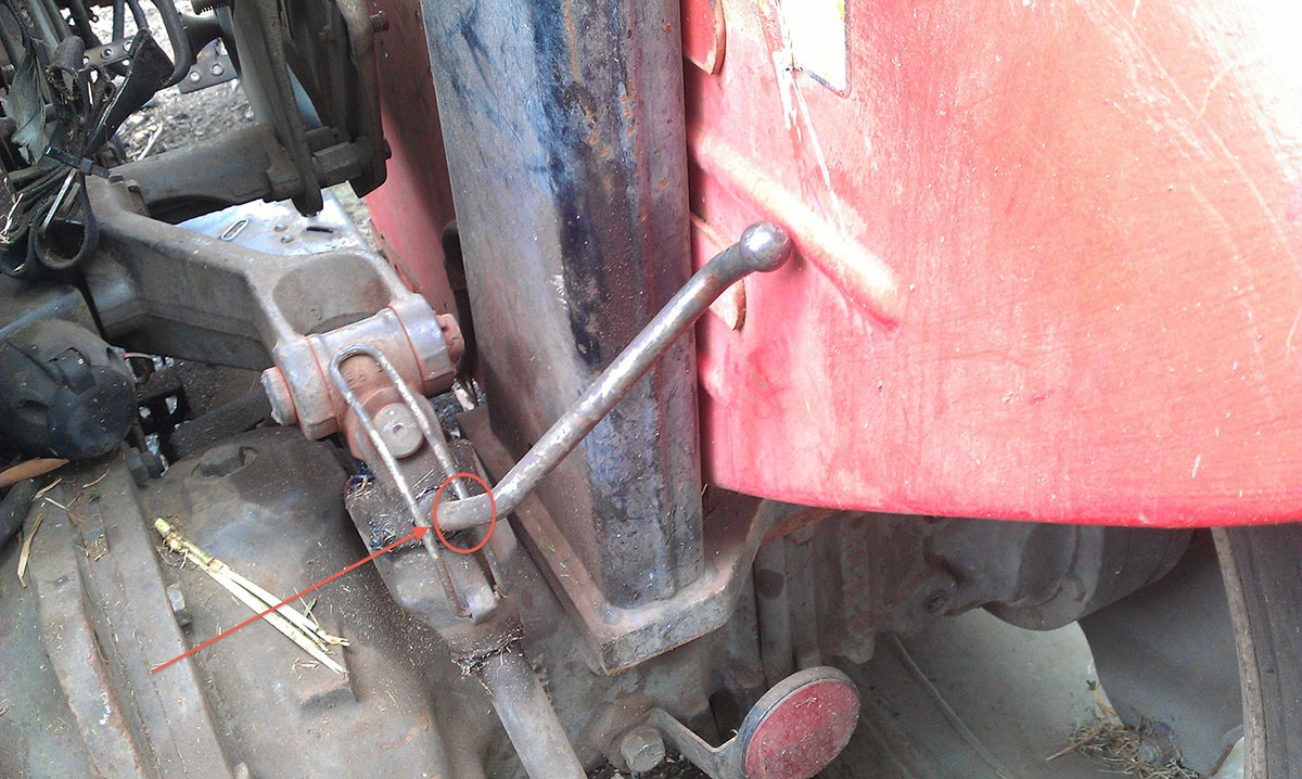

Ive discovered a strange problem with my recently acquired MF253 which I cant work out. Basically the handle for the levelling box on the rear hitch cant be used as it fouls on either the mudguard or the ROPS frame. It all looks original eg proper guards and genuine MF ROPS but for some bizzare reason there is not enough space between the handle and these parts to turn it.
If I drop the linkages to the lowest level and swing the arms to the far left I can just turn the handle but this is clearly unworkable for doing fine adjustment work needed when using a box blade or similar.
Short of taking a hacksaw to the handle any ideas?? The handle doesnt look too short or different to the one described in the manual. I cant help but think I must be missing something obvious but I dont know what! Happy to be called an idiot if I can only get it to work!

If you lift that clip that is around the base of the handle, will the handle swivel in the base so you can turn it without interference?
/ levelling box: can't adjust!! #3
Looks bent here. Might just be the photo angle. If that part of the handle "wobbles" from side to side as you crank it, that is probably the problem.

thanks for the suggestion, I should have mentioned I had tries it with the clip in all positions. Just had another look then and was thinking maybe the handle has been bent at some stage but its a very solid piece of steel and to bend it accidentally in situ in reverse would seem improbable and scary!
Bruce
was typing the same as you posted! Only difference is Ive had over a year to contemplate the problem vs your couple of minutes!
Thanks and yes it is slightly ecentric when rotated as far as I can

By looking at the photo, that can not be the original. Something had to be replaced.
See if someone else has the same unit and compare.

if moving your lift arm just a few inches gives enough room to turn the handle you might turn the pins on the blade inward so your lift arms are narrower.
But i agree that most likely the handle is bent.

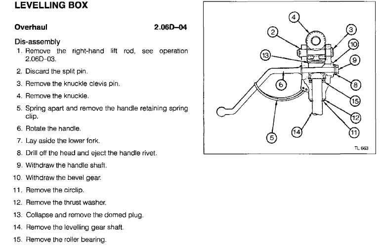

what part doesnt look original? the handle or the whole assembly?? Here's a screen cap from the manual. Not sure if these are to scale but I'll measure relative dimensions in the morning and see if it aligns.
I'm the 2nd owner of the tractor it came off a flatland golf course and seems to be very original ie anything that needed fixing was replaced by dealer.
I'll see if I can track down a compatible 200 series and compare the setup. thanks for the suggestion.

It seems there's a third bend in the OP's handle, as in right where it comes out of the box. (maybe the lads who mowed the GC were only good at going foreward)
At worst, 'blue wrench' repair might only cook some grease inside the box. (Wouldn't take much to over-think this .. :confused3:) An easy fix, no?

The handle just seems too long, it maybe orig. but that's why I said see if you can find someone with the same unit for comparing.
It could also be bent, too far over. Your parts diagram looks to to be bent less than yours.

Thanks for all the feedback. I'll pull the handle out and see if I can straighten it, if not a new part is thankfully pretty cheap. Its funny the photo makes it look more bent than it really is and it was only whilst looking at the photo, not the tractor, that I realised I'd probably missed the obvious.

Straightened up and back together, working well. Wasn't sure if Id get it straight again but it came good after removing the handle to get a good purchase and making sure I didnt damage the internal gears, used some scrap rhs section as a lever.
The only thing that may be of use to anyone else is the removal of the rivet that secures the handle to the bevel gear. Its a large steel rivet and the manual says to drill it out which may be ok if you have an industrial drill press but I quickly realised it would be a long process so instead ground off both proud ends and tapped it through in a couple of minutes. The mf parts guy I spoke to was surprised a rivet was oem reckoned they normally spring or roll pins.
