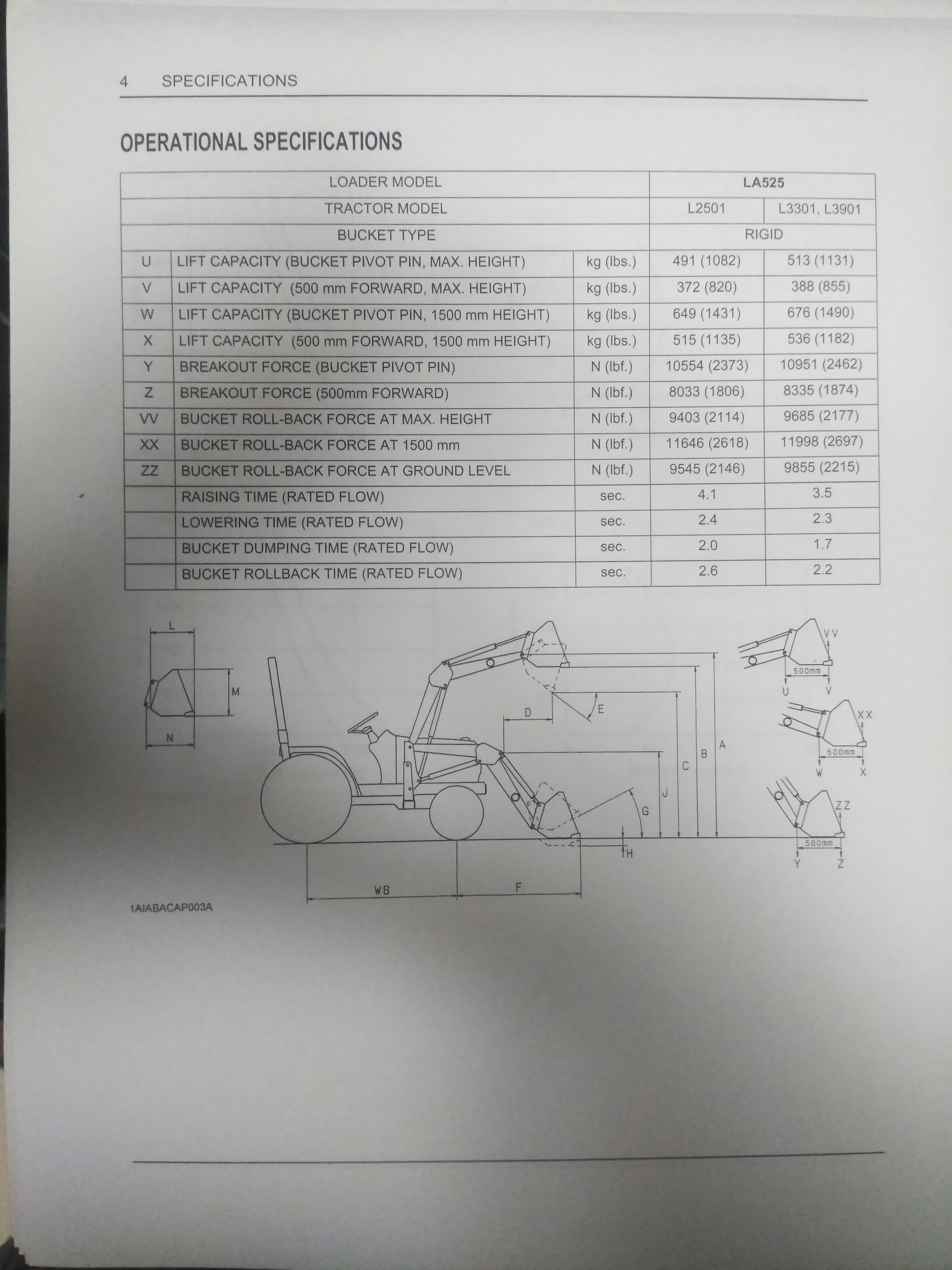

I have a copy I got on line of the fel. It has a lot of specs just don't understand how to read them.
I'll post some pages this evening when I'm home.

From TractorData for L2501:
Loader:
Loader type: Kubota LA525
Height (to pin): 94.3 inches [239 cm]
Lift to full height (at pin): 1131 lbs [513 kg]
Lift to 1.5m (at pin): 1490 lbs [675 kg]
Lift to 1.5m (at 500mm): 1182 lbs [536 kg]
Note that the "at 500mm" rating means this is the weight that the loader (or tractor*) can lift when the load is 500mm (20") out in front of the pins. This is the rating that may be typical for a loaded bucket that is out in front of the pins.
*: For the most part it's the setting of the hydraulic relief valve in the tractor that limits the loader's maximum lift. If you have more pressure you can lift more....or break something.

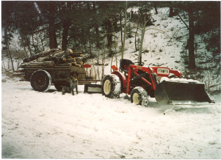

Yes, it would help if you post the pages. BTW, if this is your first time posting pictures to TBN you may need some help with that. Don't be afraid to ask.
We did a lot of forest work and got in all of our firewood for many years with a little tractor and FEL about the size of the B6100 because that is what fit the terrain best. So it can be done. We found that the limiting factor was not the FEL lift - there was plenty of lift. The limit was stability. Our little Yanmar got really unstable side to side even with a heavy box blade and weight on the 3pt. We fixed that by going to wide turf tires and also widening the way the wheels mounted to the axles to get it as wide as it would go.
For lifting, you always want to lift as close to the front of the tractor as you can. Sometimes that means replacing the bucket with something else, or cutting down the sides of the bucket so that logs can be carried closer to the front arms of the loader. If you can get the load close to the bottom of the loader arms where the bucket fits, but without the bucket itself - then it will lift twice as much and be more stable as well.
luck, rScotty

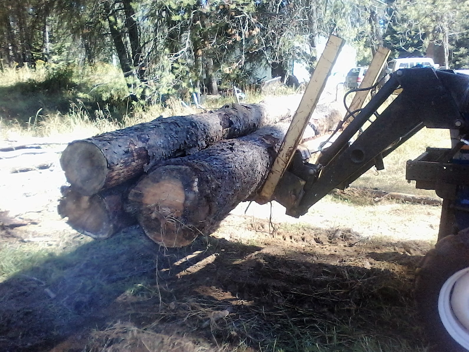

ps for lifting /stacking
Clamp or chain on Forks will get you started or a quick attach set of pallet forks , I usually stick with the grapple most of the time
Chain on forks in link and last pic - were under $250 all in and rated for 3000lbs. https://www.tractorbynet.com/forums...let-forks-debris-forks-branch-removal-001-jpg

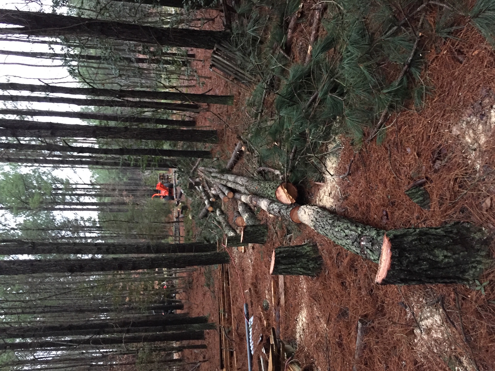

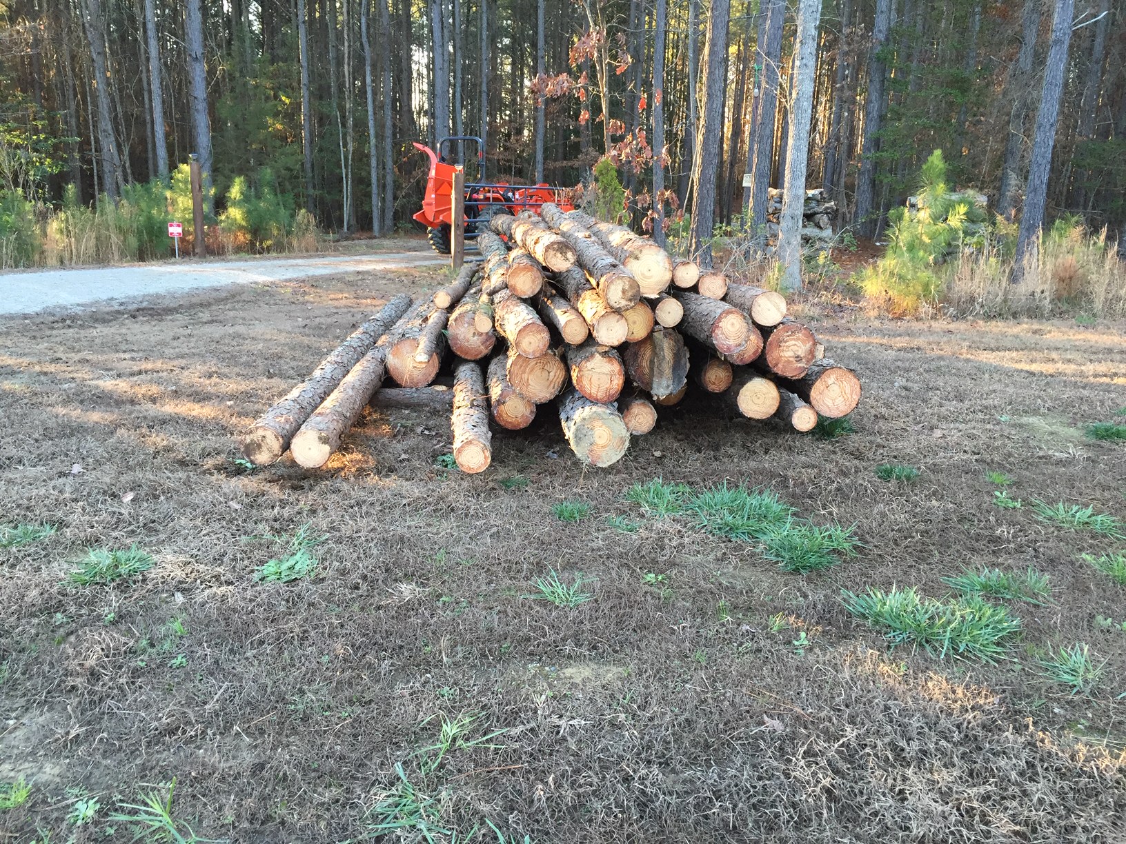

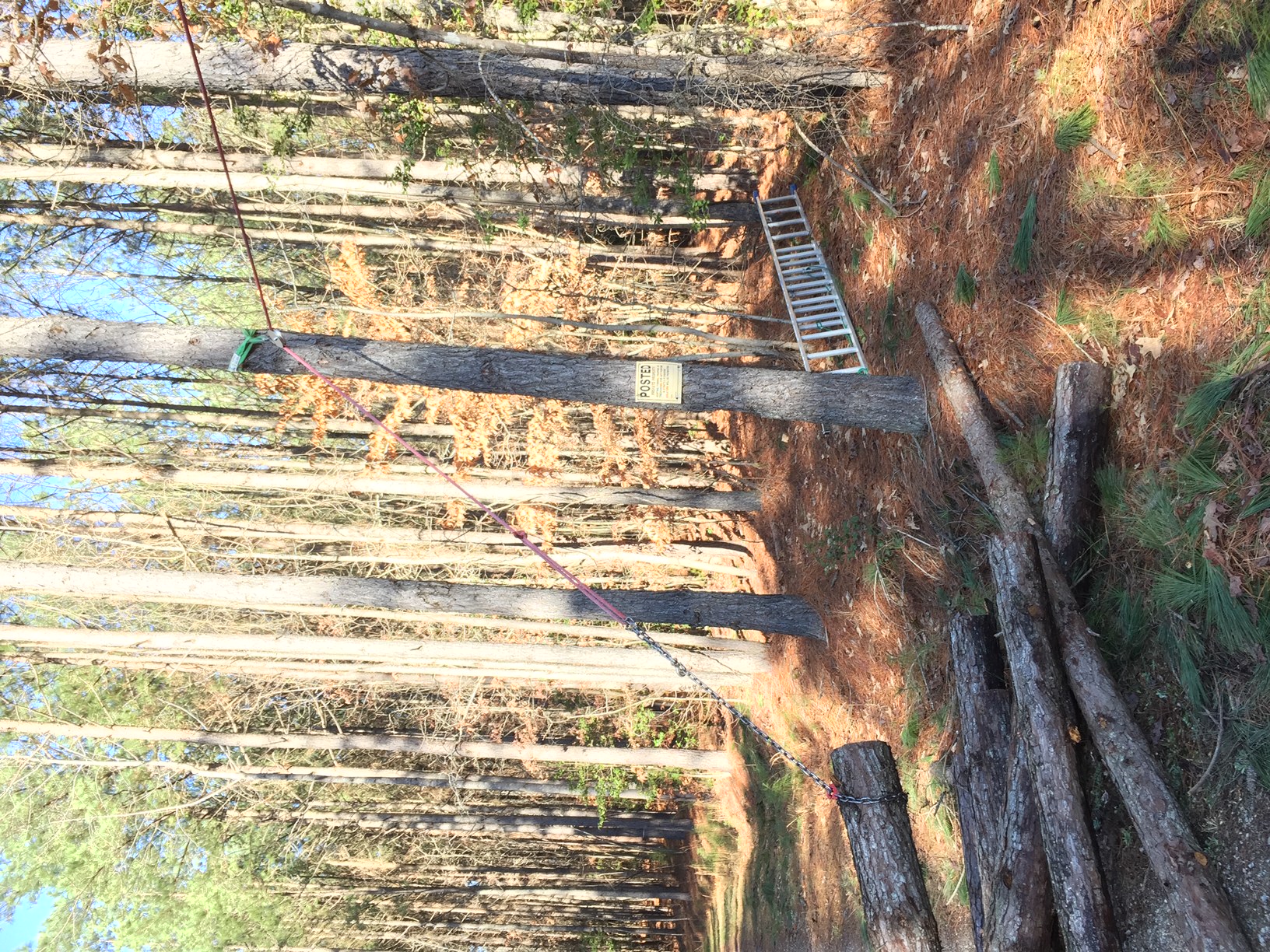

I wondering what you guys can suggest to me so that I can stack my logs/ trees that I have cut down.
I have acres of pines about 60-70' tall. When I need to clear an area, I drop the trees, limb them, then use a rope and fairlead (pulley mounted up in another tree) to get the logs out of the woods. I normally drag the trees out whole so they are laying across my driveway, but sometimes I buck them beforehand. I generally buck them into 8-16' sections and lift them with clamp-on forks on my front loader. Drive them over to a pile and dump them. For skinny trees I might buck into 16' sections since they are light and won't twist the loader around. If I have to drive through my 16', gate I cut the logs to 15', don't ask why....
Clamp on front end loader forks, Ill have to google that, thanks

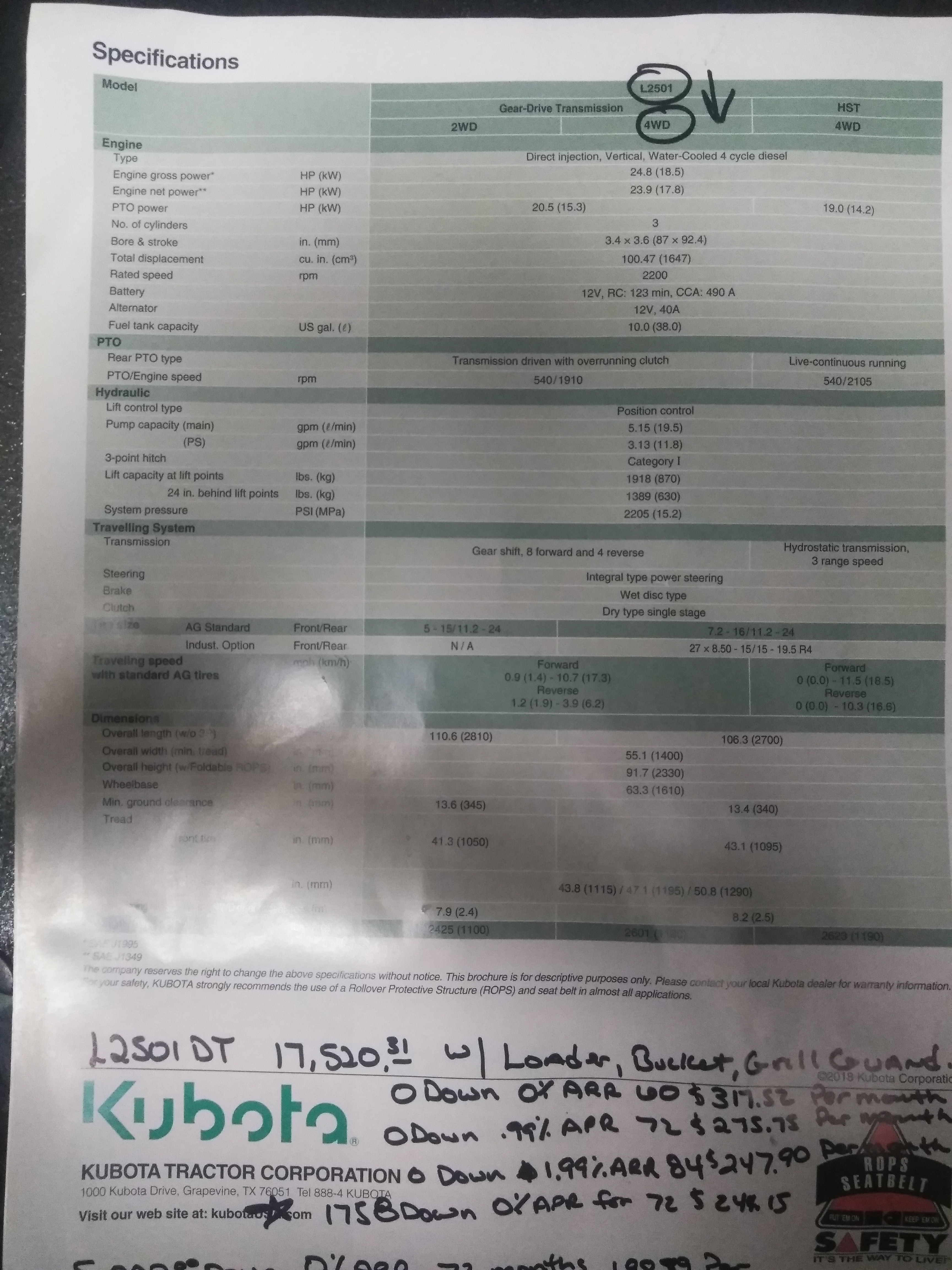

Heres the specs I mentioned
   / lift capacity numbers #20
Generally lift capacity will be at a specified distance from the axis.
On a FEL bucket that would be the loaded center and the axis should be the front axle.
Next the factory will have set the relief valve to kick out at that load limit.
The farther away from the bucket C of G the less U will safely be able to lift.
Now all that can be negated if U have rear ballast to counter act but relief valve will cancel the added capacity.
LOL, confused yet?
The 'work around' is lots of rear ballast and tweak the relief valve and watch your front tires squat.
