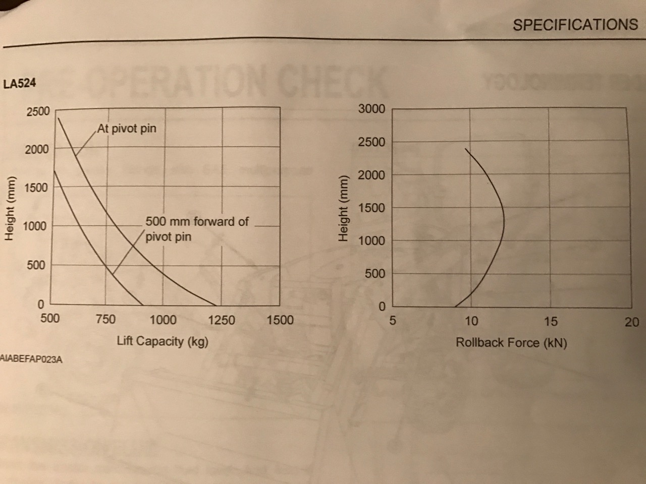

The owner's manual for the front loader will have a lift curve in it similar to this:
Out back, the PTO is the part that rotates and turns machinery -- the "3-point" is the part that lifts stuff. Should be good specs for that in the owner's manual too.
It does have something similar to that. I'll post a pict. this evening, I don't have the manual with me.

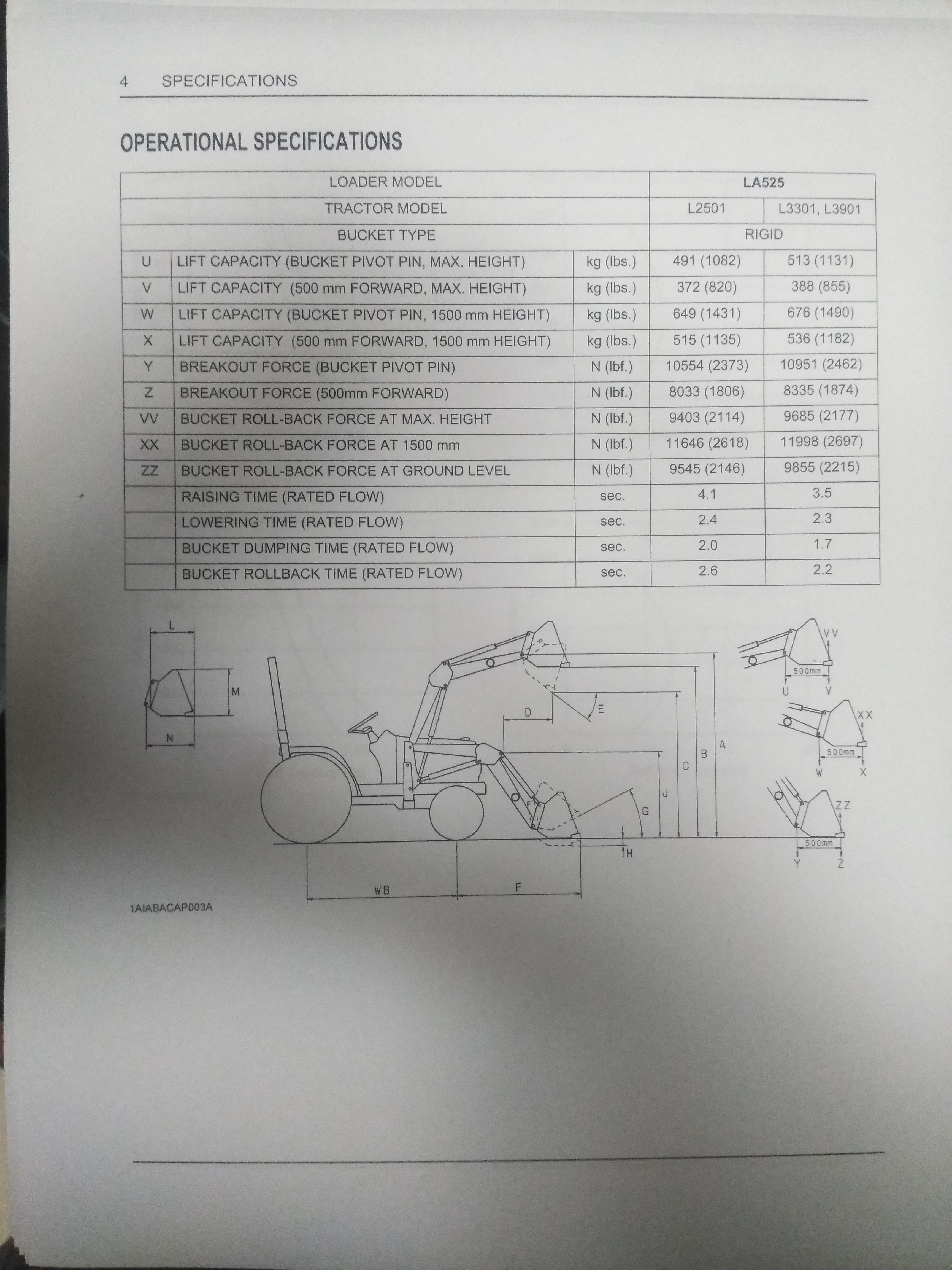

I have a copy I got on line of the fel. It has a lot of specs just don't understand how to read them.
I'll post some pages this evening when I'm home.

From TractorData for L2501:
Loader:
Loader type: Kubota LA525
Height (to pin): 94.3 inches [239 cm]
Lift to full height (at pin): 1131 lbs [513 kg]
Lift to 1.5m (at pin): 1490 lbs [675 kg]
Lift to 1.5m (at 500mm): 1182 lbs [536 kg]
Note that the "at 500mm" rating means this is the weight that the loader (or tractor*) can lift when the load is 500mm (20") out in front of the pins. This is the rating that may be typical for a loaded bucket that is out in front of the pins.
*: For the most part it's the setting of the hydraulic relief valve in the tractor that limits the loader's maximum lift. If you have more pressure you can lift more....or break something.

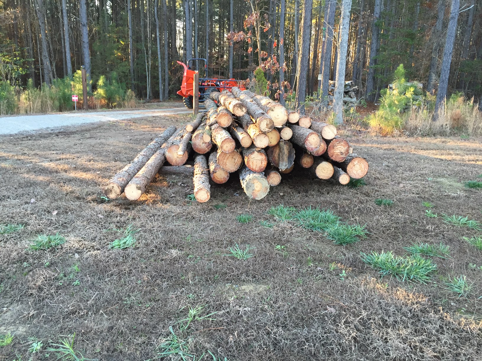

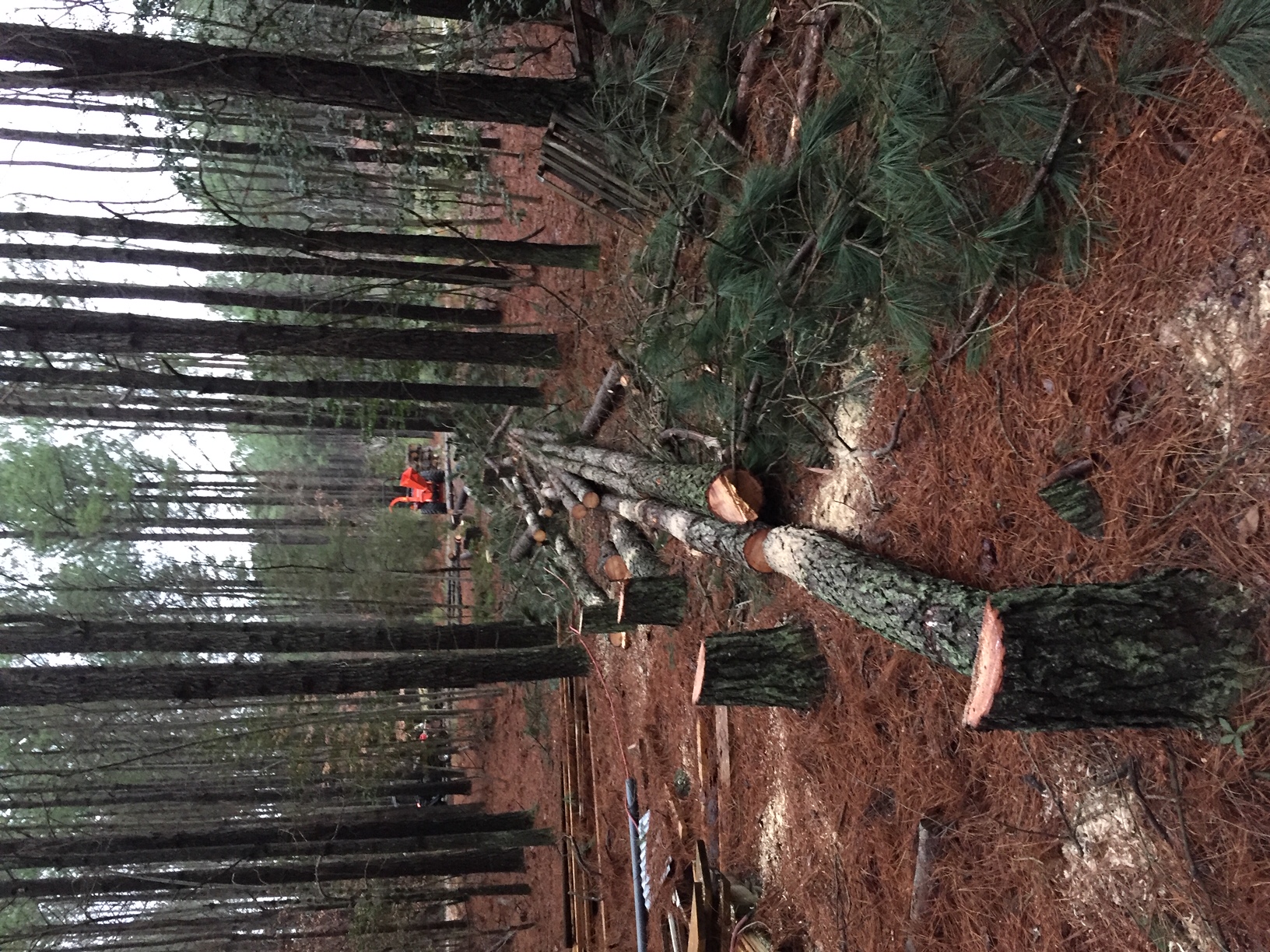

I wondering what you guys can suggest to me so that I can stack my logs/ trees that I have cut down.
I have acres of pines about 60-70' tall. When I need to clear an area, I drop the trees, limb them, then use a rope and fairlead (pulley mounted up in another tree) to get the logs out of the woods. I normally drag the trees out whole so they are laying across my driveway, but sometimes I buck them beforehand. I generally buck them into 8-16' sections and lift them with clamp-on forks on my front loader. Drive them over to a pile and dump them. For skinny trees I might buck into 16' sections since they are light and won't twist the loader around. If I have to drive through my 16', gate I cut the logs to 15', don't ask why....
Clamp on front end loader forks, Ill have to google that, thanks

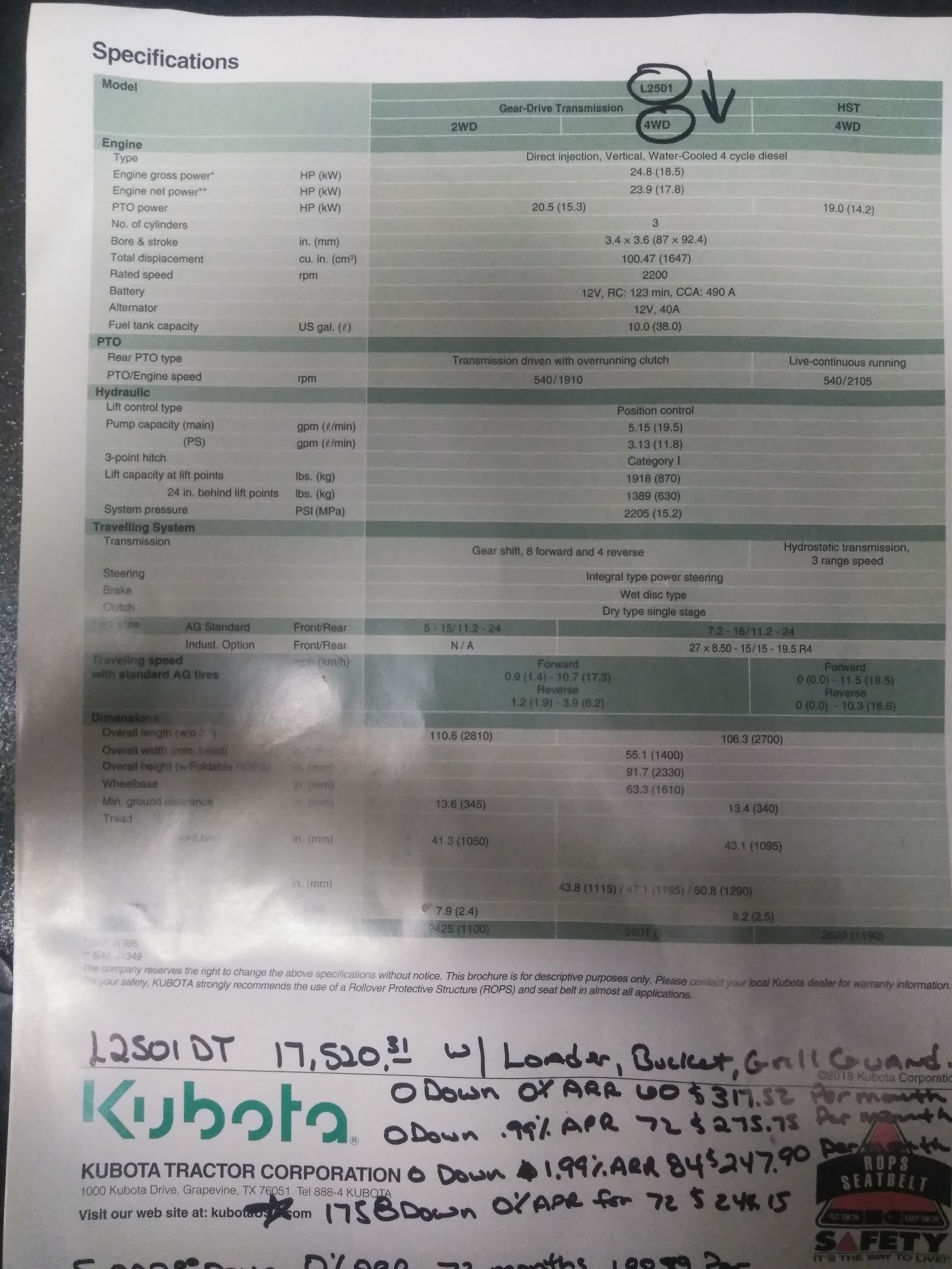

Heres the specs I mentioned
