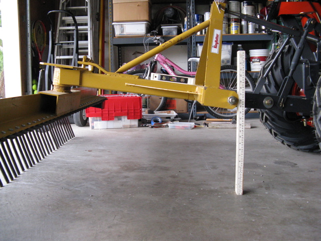

Here's a picture of the setup when the rake "top tube" is parallel to the ground. This is my preferred setup, because it allows the rake to angled left and right without causing one side of the rake to dip, which then requires adjusting the length of the right lift rod. In this setup, the top link is extended to within 3/8" of an inch of its maximum length. Note that the lower link is at about 22".

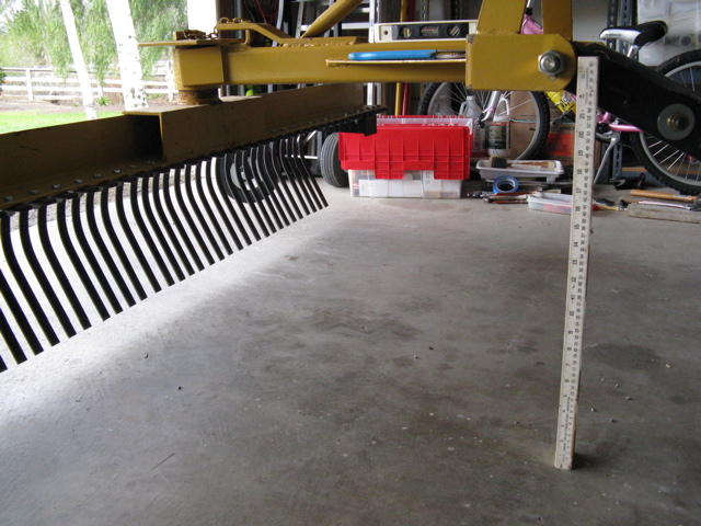

Here's a picture of the above setup with the lower links fully raised. They only went up another 2", so this got the rake tines 2" off the ground, not really enough for transport.

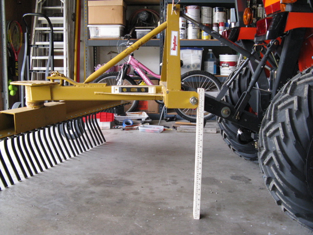

Here's a picture with the top tube angled so it is lower on the 3PH side. I shortened the top link by about 1.5" from the previous setup. The lower links are at about 16" now rather than 22", so when fully raised the rake is about 12" off the ground.

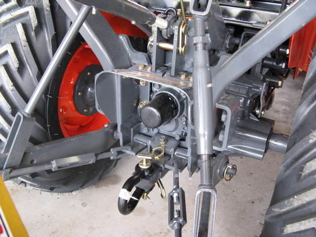

With the top tub angled down as pictured above, if I angle the rake, the side the I angle forward dips a lot. With the rake fully raised, it dips to 3" off the ground (from the 12" if the rake is not angled). I adjust the right lift rod to fix this. It doesn't take too much, but keep in mind this adjustment needs to be made whenever I change the blade angle. Here's a picture of the lift rod with the adjustment. The lock nut is at the old adjustment.

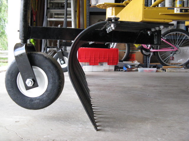

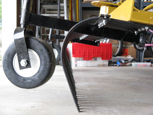

The other issue with having the rake top tube angled down is that the tines become more upright. The following two pictures show the difference, although it is not as big as I thought it was.
I'm thinking that as long as I use gauge wheels, I might be ok with the setup that has the angled top tube since I don't believe I will need to adjust the lift rod length. I'll just put the 3PH all the way down, and let the gauge wheels do their job to level out the rake. The only potential problem is that when the rake is angled and fully lifted, one end is only 3" off the ground, so I'll just have to not have the rake angled when transporting it.

seapea, from what I can see is that the size of your tractor doesn't have enough 3pt lift height for that model rake. So, if you are set on using that rake you will have to live with constantly making somekind of adjustment to the 3pt. You may just modify your raking technique to lessen the amount you have to adjust the rake. Looks as though maybe the sub cut model rake might have worked out better on your model tractor. I'd bet that the distance from the ground to the draft link pins is shorter on the sub cut model rake. That would allow you to lift it higher with your model tractors 3pt.
Looks like the gauge wheels throw in a whole other factor. I'm thinking this rake isn't going to work with your 3pt hitch lift height.
