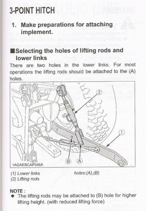

I now see my mistake in interpreter the affect the A and B holes in the lower link will have the implement height.
http://www.tractorbynet.com/forums/attachment.php?attachmentid=98014&stc=1&d=12055637 57
I only looked at the affect when the lower links are lowered. When lowered, moving to the A hole makes the lower links even lower. However, once the lower link is raised a little above parallel to the ground, using the A hole starts to have the opposite affect, and will cause the lower link to be raised higher than it would be in the B hole. This is just theory right now (I've been pondering this for a while). I give it a try tomorrow. I also have a longer toplink I'll try tomorrow, although this won't affect the lift height.

In my previous post, the references to the A and B holes were reversed. Today I moved the lift rod to the B hole. That raised the lower links by about 1/2" at the pivot point, and raised the rake about 1". Not much, but it helps.
I ordered Pat's, and I'm guessing this will give me about another 1", which should be enough. I think my rake will by about 5" off the ground then.
Chris
   / Lift height problems with KK rake on B2620 #25
There is another set of holes in you lift arms behind where the lift links coming down from the rockshaft fasten to the lift arms. If you move the lifting rods back to these holes it will increase the lift hieght.
If you make this adjustment watch closely the first time you raise the lift after making this adjustment to be sure nothing binds up or comes in contact with sheet metal anywhere.
These are the A and B holes referred to in previous post. I made this adjusment and it added about 1" to the height of the rake.
