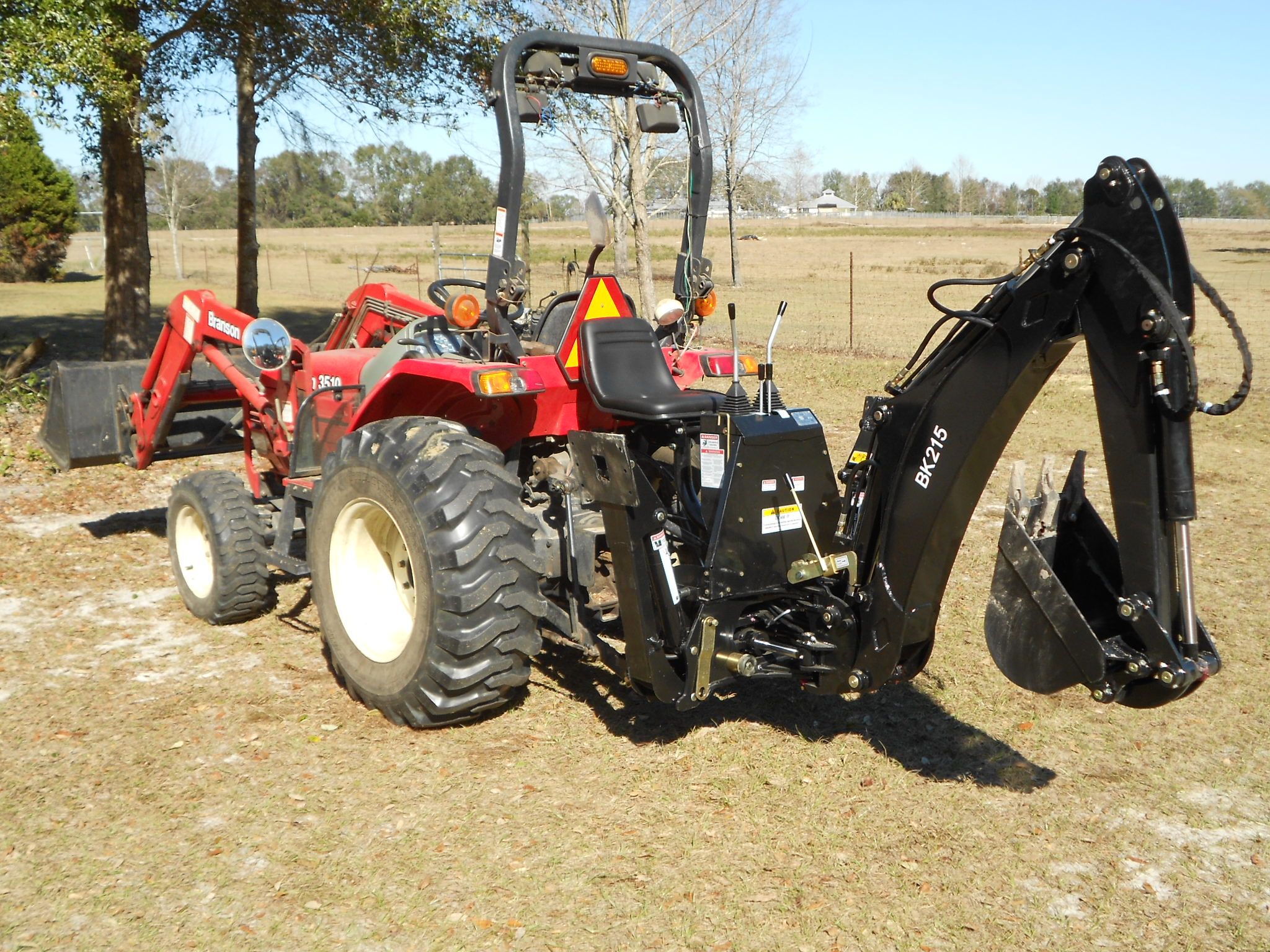

I知 purchasing Woods 7500 backhoe with subframes and the only option to load it and offload it on and off the trailer will be to use the front loader. The tractor has the lift power but wanted to see if anyone have done such project and if you have any recommendations for me - loading, offloading, securing, etc... I値l be renting heavy duty 14x6 trailer.
The backhoe is 3h away from me so I need to make sure it can all happen at one shot.
Thanks

They are hard to move because they have no real balance point.
As soon as you start lifting the boom will shift, usually a direction you don't want.
I have loaded one that I sold using tractor forks and it was tricky.
Make sure you have plenty of chains and straps to secure the boom to the main structure and to keep the outriggers retracted.
Extra blocks might come in handy, a com-a-long or two also.
When rigging I always take way more than necessary to be ready for anything.
I hope the price is right, I bought this one new/free shipping for $3400.

I bought a Woods BH7500 w/ subframe a few years ago. I lifted it with 2 chains to hooks on my bucket and used a 3rd chain from bucket around the hoe arm to prevent the teeter totter effect. I took my tractor to where the BH was, drove over the subframe so it was under the tractor and used two chains to lift off the ground. I then drove it onto my tilt bed trailer slowly with a buddy on each side guiding it so it wouldn't swing. I only had a 4 mile trip to bring it home. I should have taken pics but didn't think about it at the time.
