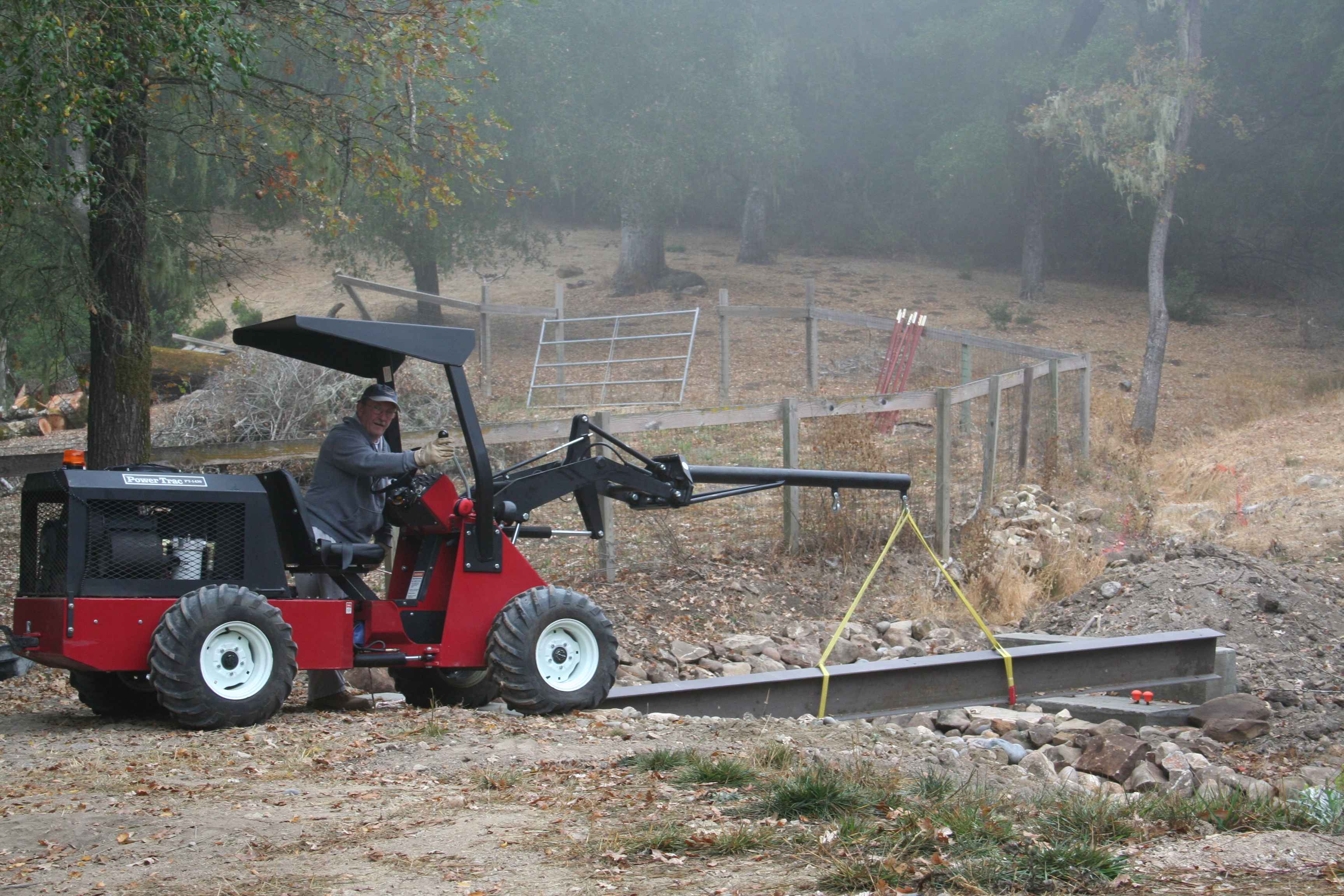

I understand the concept but have no idea how to calculate; however, in the attached photo I was lifting a 400 lb beam at the tip of the boom. The beam is 14 ft long so the center is at 7 feet. I had no feeling of tipping, in fact I carried two of these beams off the trailer at one time and had no sense at all of being light. I did not try three as that would have been at the total advertised capacity and I did not want to try it.
Which model PT do you have. I can see that it is red.
