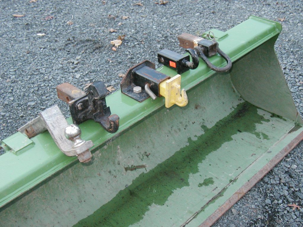

I think 2 chains are needed unless you have a center mounted hook.
That was the reason I went with the center mounted receiver, so I could use just one chain even with the heaviest loads I could lift. Must be a PITN having to use 2 chains.
Where did you get the bolt on receiver? Or is that just a standard light duty automotive receiver?
Ken
Ken
I had this one made for me, obviously not to complicated, but as far as I know no one had one to buy at that time.
Now HF has one that would work perfectly for ~ $20.
5000 Lb. Capacity Step Bumper Receiver

I don't completely understand what you mean, but I agree you could use 1 longer chain to make the 2 drops. But you still have to, fool around balancing the load. For me I wouldn't consider anything but the center mount, if My bucket wasn't up to the task I'd beef it up.
The 2 grab hooks would come in handy for stabilizing a large bulky load in the bucket, can't do that as well with the single center mount.
But look at all the other options available with the receiver, the ease of using just one chain for lifting is just one benefit.
I had the 3/8" weld on grab hooks in my hand, but decided against installing them on my bucket for the reasons mentioned. I know they are still all the rage so I don't want to criticize them too much :)

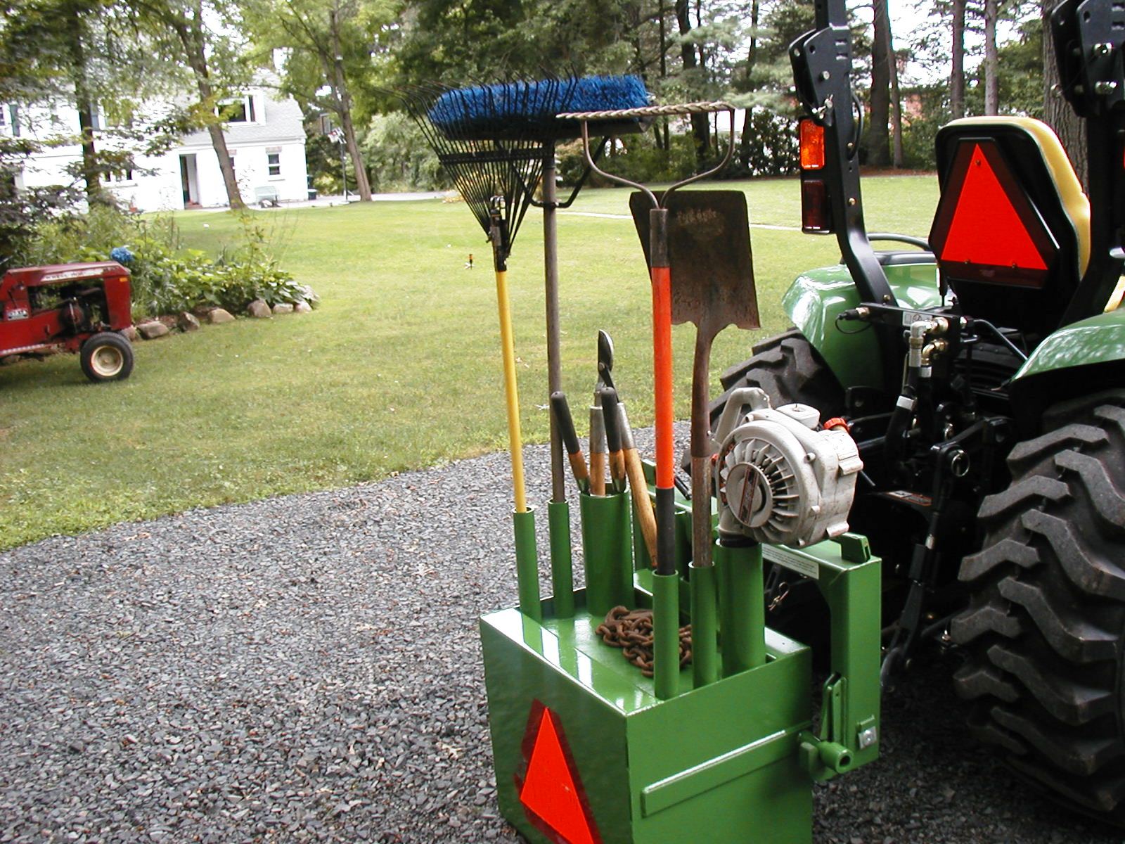

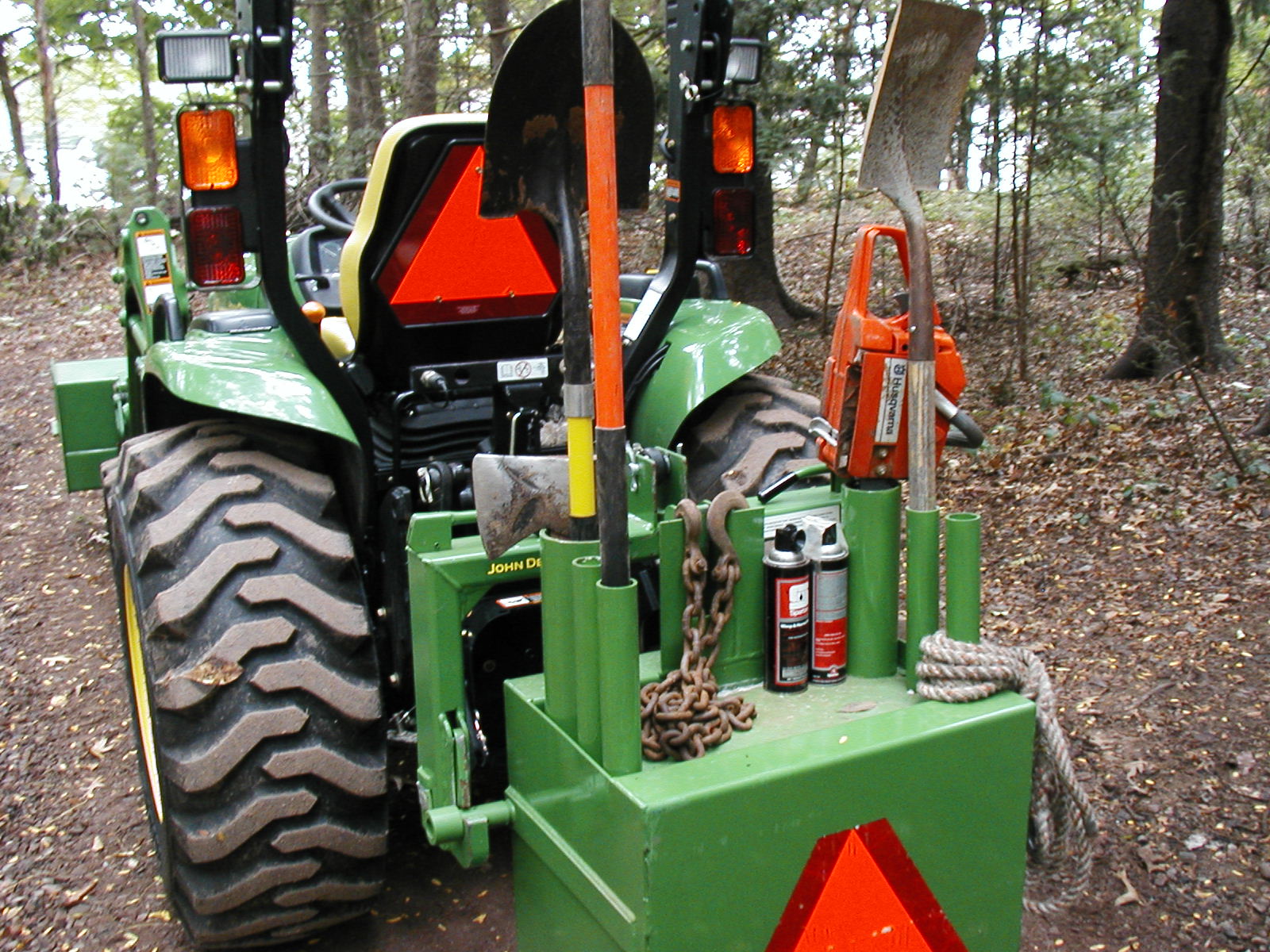

Another subject, JB I like what you did with your ballist box with the stone and pipes. When I get one I'd like to do the same thing. Does it give you enough ballist that you feel comfortable with? What size pipes did you use?
OK I got it now, that does sound pretty simple, couldn't picture it cause I never did it.
As far as the ballast box. I have since filled it with concrete to within 2 inches of the top. seems to be the perfect weight, even with the pipe in it. One 4", one 3" and four 1.5" pvc schd 40.
You might want to consider steel pipe, I thought about it to late but thought with plastic if you broke one you would be stuck with the short hole. So far I've had no problems, pvc is pretty tuff but the smaller ones are vulnerable, not so much the larger ones.
Maybe consider a way to drop the pipe in the concrete with a slightly larger formed hole, so you could take them out or change them if necessary.
That may be overthinking it, But for sure the pipes come in handy.
Good luck,
JB
