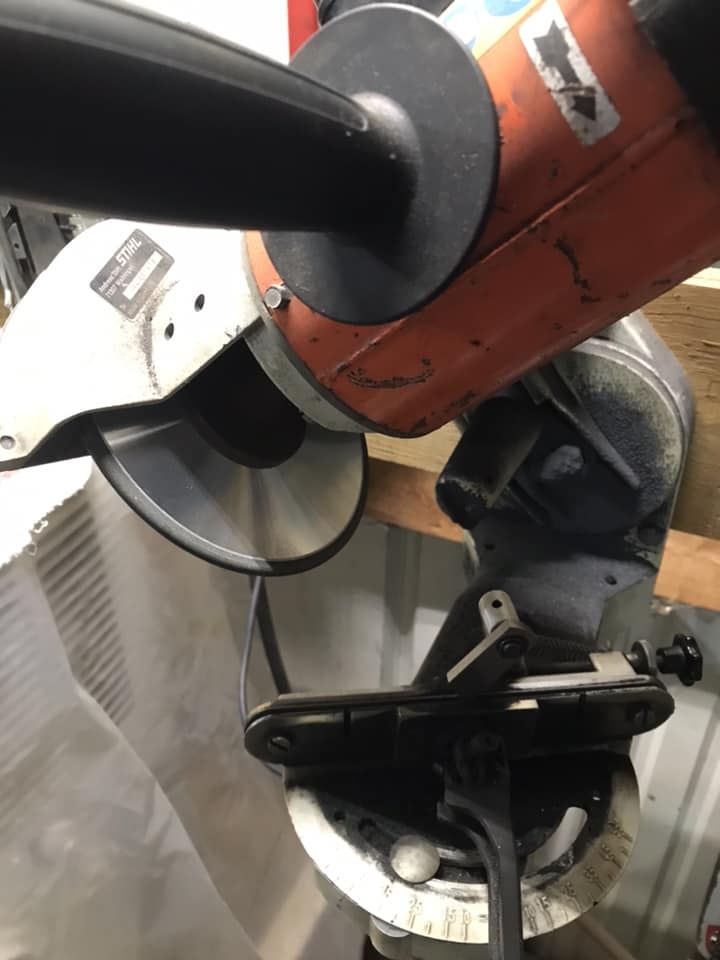

There are very good combination sharpeners which cut the raker and the depth gauge at the same time. Don't require you to be an expert with a gauge and a vise. You can sharpen a chain on the saw in 10 minutes. I use a Stihl version, but German Pferd makes one too.
FYI: the version sold by Stihl is made by Pferd
