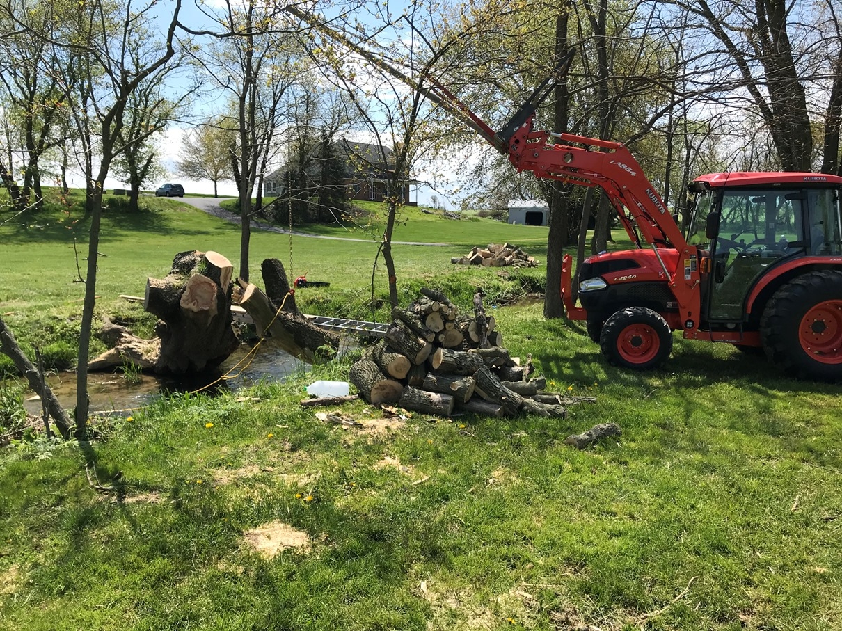

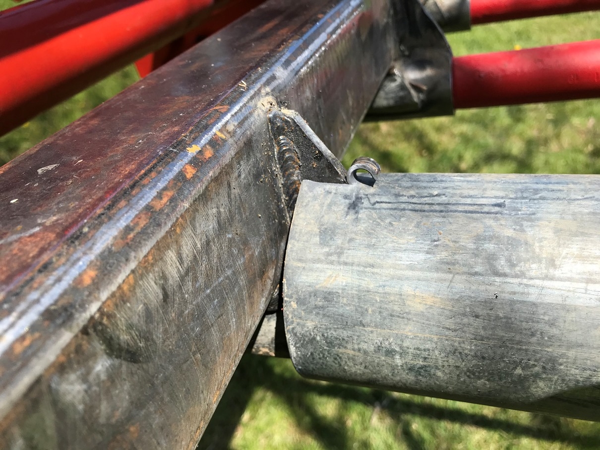

I removed a bunch of limbs from a tree in my creek a few years ago. Wanting to catch the big chunks before they ended up in the water, some Rube Goldberg crane actions were taken. For rigging, a 10' piece of 3"EMT conduit on one fork for my boom. To add support there were two chains from the business end of the conduit to the fork frame. When tree chunk cane loose, it applied quite a bit of force to the "crane". It pushed the conduit back toward the forks with enough force to have a reinforcing gusset peel the pipe open as seen in the second picture.
My forks are bale spears welded to a QA frame. You can see the amount of deflection with the load on it, and the spear did return to its normal unbent condition. A real testament to the strength of that steel.

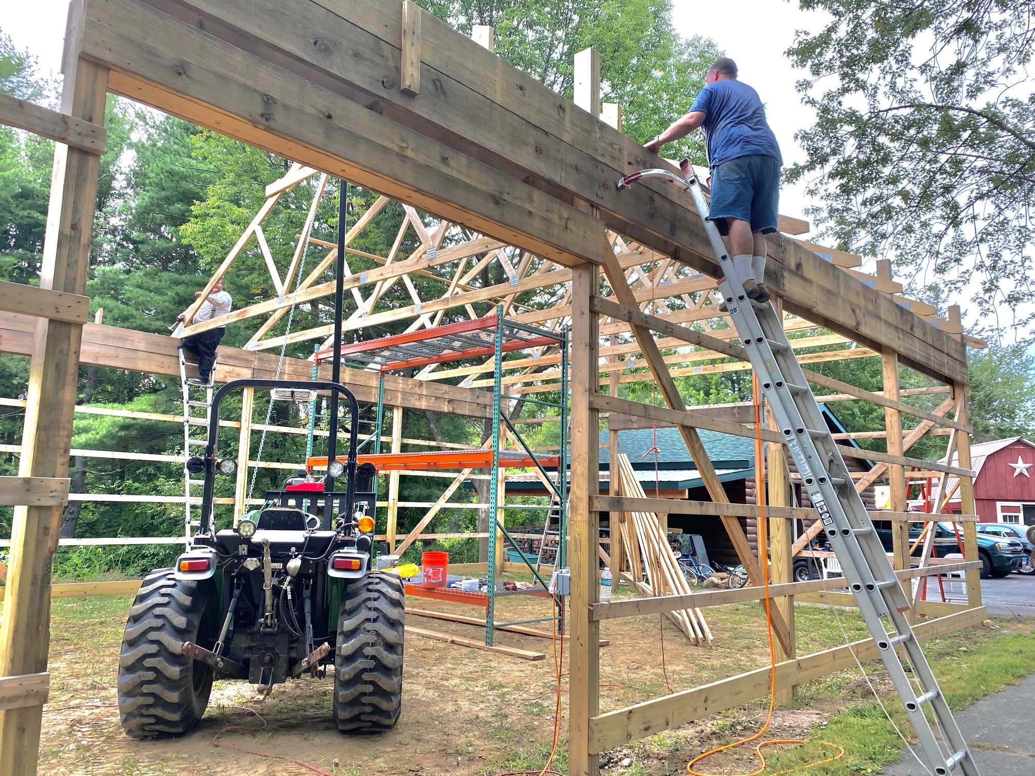

I borrowed one of the smaller duct jacks from work when I built the shed for the L4240. The peak is probably 13 or 14 feet. The picture was taken during a test run for concept - just wanted to verify the jack was tall enough before starting the lifts.

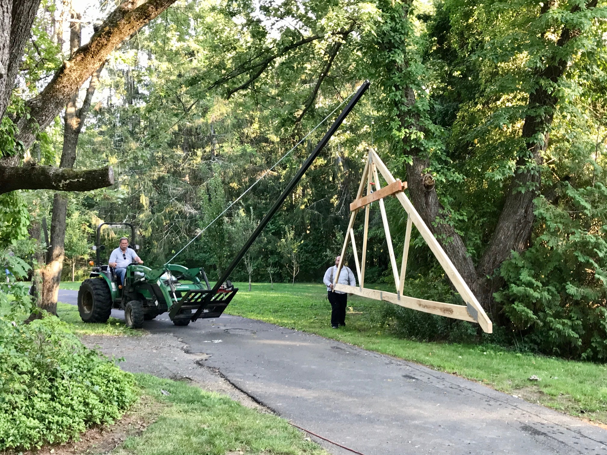

These were 4-12 32' span, lifted onto 14' sidewalls. Unsure of the weight, didn't care. Top of boom was over 21' in air as I lifted it clear of side walls as I drove it in.
Just a piece of pipe on end of a manure tine. Chains running rack to bucket back in a "V" to carry the tension load. 8500lb tractor, level ground, zero issues lifting or driving while in air, I did have to carry them a distance low to the ground to get between where rolldeck slid the trusses off and where the building was.
