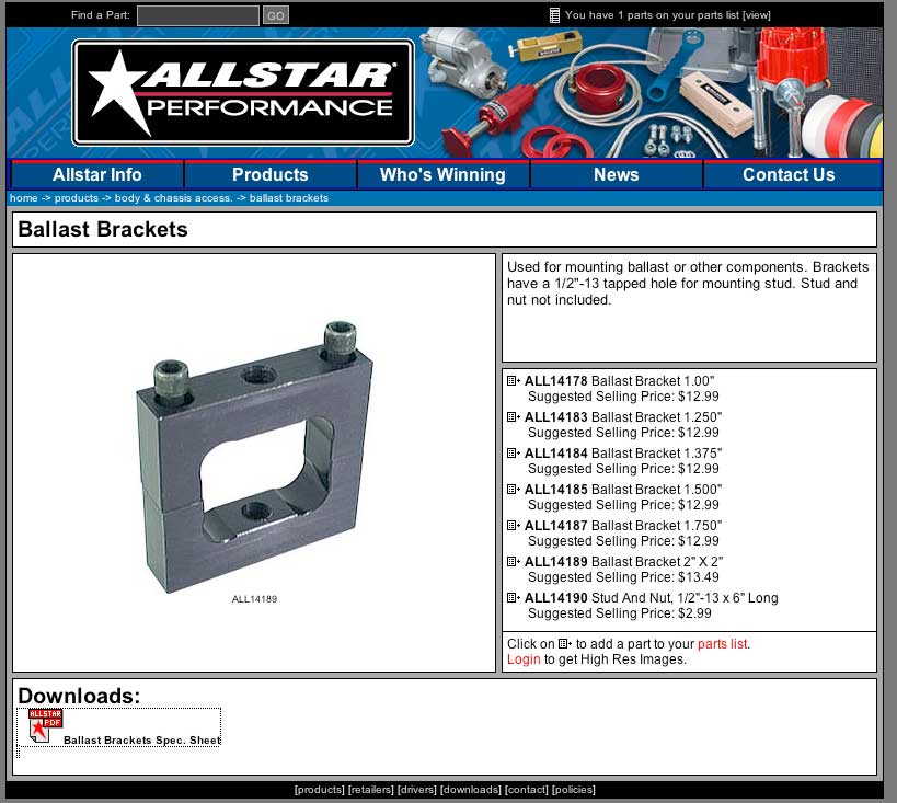

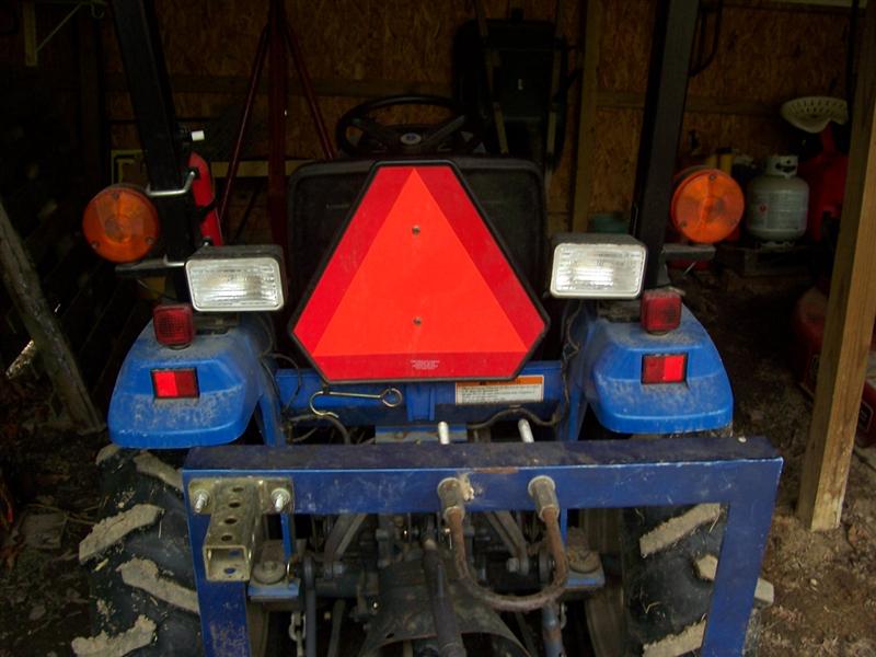

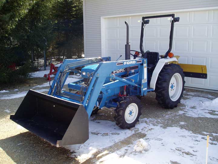

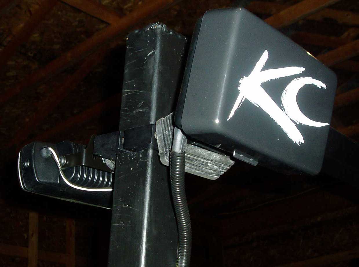

I can't answer all your questions, but here's what I used. I bought two brackets from allstarperformance.com (Part # ALL14189) and used those to mount my lights. They are actually Ballast Brackets but have two 1/2"-13 holes tapped on each end and will clamp anywhere to the 2"x2" ROPS. Then I just modified my brackets that came with my lights (Piaa and KC) to accept a 1/2" bolt. As for wiring I spent a little bit extra and just purchased the wiring harness that's designed for the lights and hooked everything up from there.
Anyway, I've attached a couple photos showing my lights and the website screen shot for the brackets if you don't want to make a bracket.
Thanks

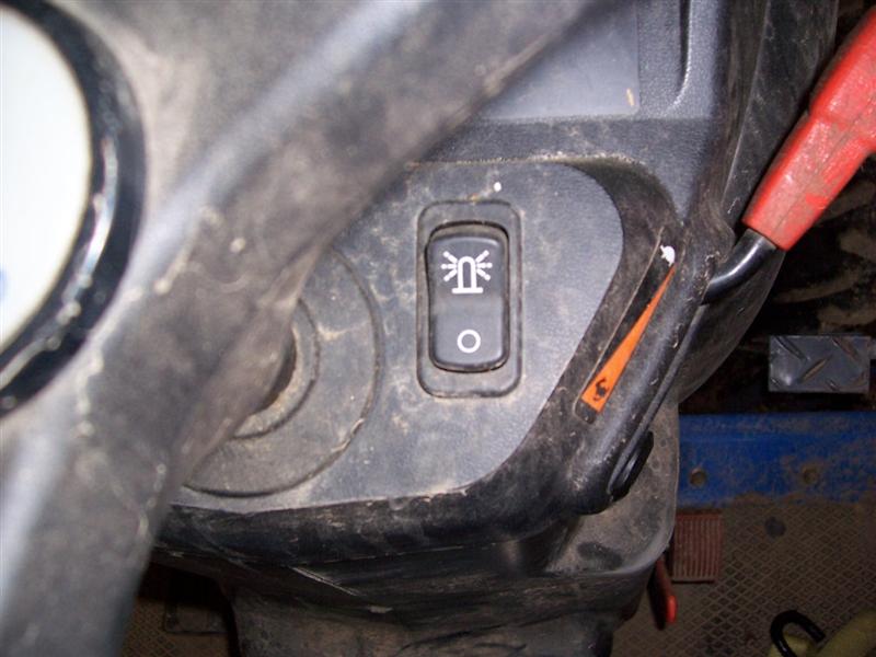

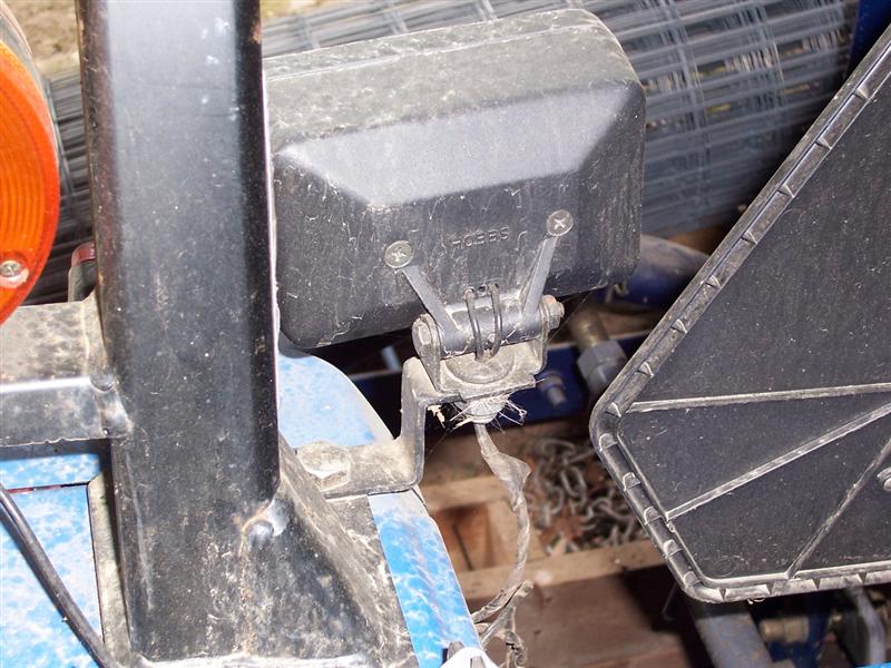

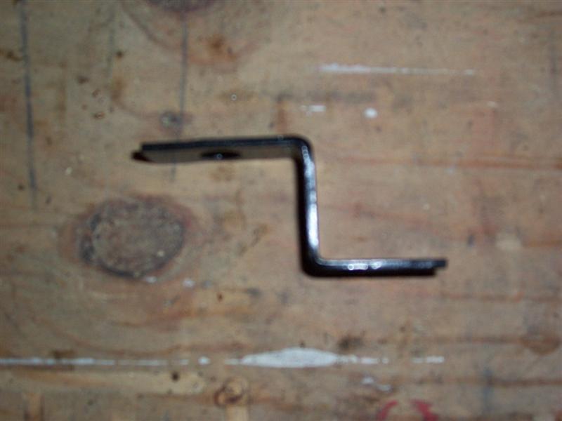

When I added my work lights I bent my own brackets out of 1/8"x1" steel. I placed it under one of the ROPs bolts. I bought the switch at a JD construction dealer, I think it is from a log skidder or dozer. The part # is AT175603. The location for the switch had a blank on it so I removed the blank and enlarged the hole just slightly for the switch to fit.
Solo
