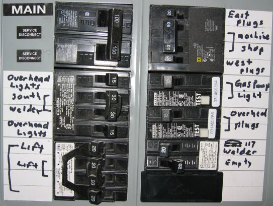

I'm getting ready to run the wiring for my 24X32 (10'ceiling) barn/shop & also have some related questions. I have 100 amp service to the barn. /forums/images/graemlins/smirk.gif
For now, I thought of wiring 6 over head light fixtures (for 100 watt bulbs) with receptacles. I was going to plug 3 48" dual florecent lights (with pull chains) into 3 of the receptacles to hang over the future workbench area. Is it okay to run what I just described off 1 15 amp circuit? /forums/images/graemlins/confused.gif
Which is better... plastic or ceramic fixtures?
I was then going to run 10 outlets around the perimeter of the building off of another 15 amp circuit. How would that work? /forums/images/graemlins/confused.gif
I have a basic service box with 6 circuit slots with room to add flood lights, 220, etc later. /forums/images/graemlins/smile.gif

Shade,
Put the outlets on a 20A breaker instead of the 15A. And put them on a GFCI.
Plastic or metal......?? Same as being asked plastic or paper at the grocery. Al in what you prefer.
/ Lighting & workbench? #35
Thanx for the info.
Why 20 amp instead of 15? I'm glad that you suggest 20 - I have 2 of them. /forums/images/graemlins/smile.gif
Do you mean GFCI breakers or GFCI outlet receptacles?

I just built my pole barn this year.
I have a separate 100 amp service to the barn.
My wiring is this, one circuit for the lights with room for more. I use those twisted bulbs which are turned into the sockets that plug in to standard outlets. I can add more to this, currently have 2 outlets/ 4 plug ins on one circuit.
On outlets, I have 2 circuits, both with gfic outlets on the first outlet placement. (required by code).
I have a circuit for just the garage door opener, again a simple plug in.
I have another circuit for the side and front lights, which are motion detecting.
Another circuit for my small out building 220 split into 2 sides of the extension box to give me 2 legs of 110 each, lights and outlets only on this.
I have one more circiut 220 for my air compressor, which by the way has 1 inch pvc tubing around the barn with several outlets that I can connect air lines or tools to

Just to throw in a couple of items no one has mentioned.
I installed a retractable cord reel between the cars, right next to the garage door opener. I plugged it into the garage door opener outlet since I am not likely to be raising the door while using the cord reel. Really handy to have a 30' cord available in the middle of the garage. I put another one on the corner of the front porch by the driveway. I know the cheap ones are not rated for outdoor use but it is on a GFCI plug and I can replace it for $25 or $30 when it rusts/wears out. It's been there for about 4 years now and still works great.
After sweltering through a couple of hot summers I insulated the ceiling. The roof has exposed 2X6 rafters. Stapled the 6" insulation between the rafters and then ran 2' wide chicken wire perpendicular to the rafters and left a 2' gap between rows of chicken wire. Insulation will start falling after a few years without the chicken wire to hold it in place.
I was amazed at the difference the insulation made in both summer and winter. I used to be able to feel the heat coming through the roof in the summer and now it is often 2 degrees cooler in the garage than it is outside.
I put a ceiling fan in the center of the garage, above the joists. It circulates the air and keeps moisture from building up in the corners in the dead air space. I have it blowing up so the air hits the roof and then blows down into the corners.
Ditto on the fluorescent lights. My 28X32 garage has 10 4' fixtures + 2 over the workbench. I have one of those clip-on aluminum floodlights on the back wall behind the workbench with a 200 watt bulb in it in case I need a lot of light on something I am working on.
Don't forget to put in a plug for an air compressor. I put mine on it's own 20 amp circuit. The air compressor is the biggest load I have in the garage so I didn't want anything else on that circuit.
