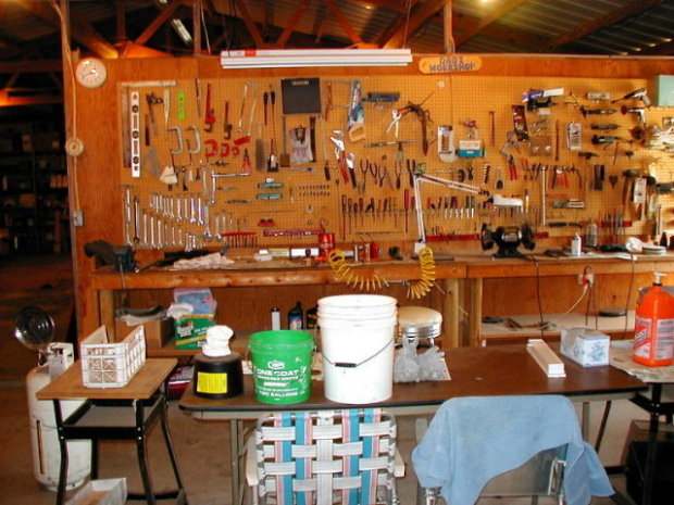

I built two of my own workbenches that were perfect for my purposes, but maybe not for yours. I made them taller than you're considering (legs about 42" if I remember right) because I worked there a lot standing up, or sometimes sitting on the barstool in the picture. The top, and the bottom shelf, were 3/4" particle board, legs were "landscape timbers", perimeter 2 x 4s under the top and a single 2 x 4 under the middle of the bottom shelf and all assembled with 3" countersunk screws. The shop had lots of plain incandescent light bulbs only, so I hung the two tube 4' florescent fixture over the spot where I worked the most. And I put my 4" swiveling vise on the left end of the left bench, the bench grinder toward the left end of the right bench, (and a 3 ton arbor press out of the picture on the right end of the right bench).
