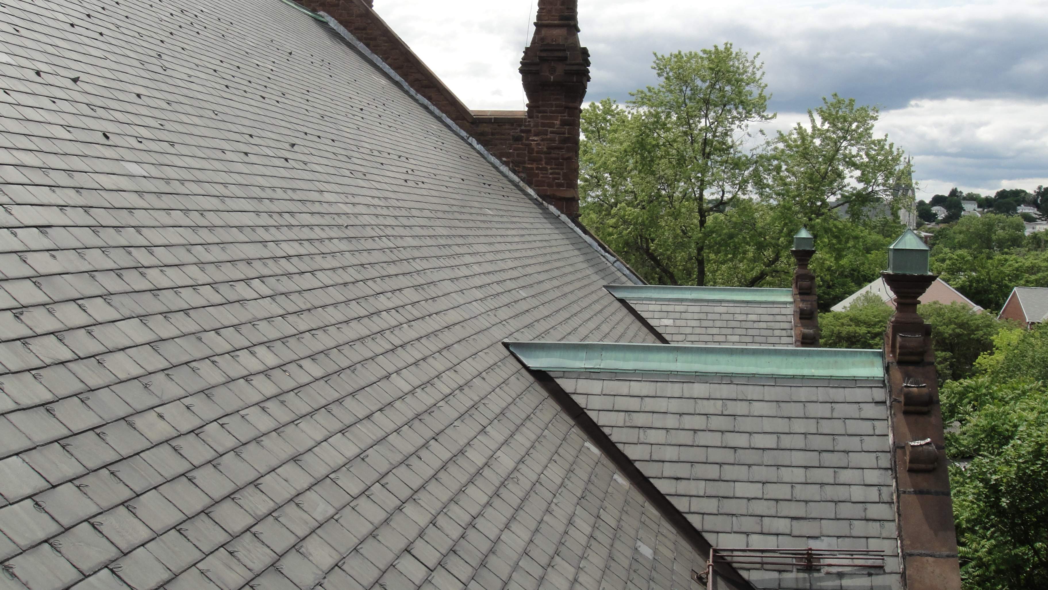

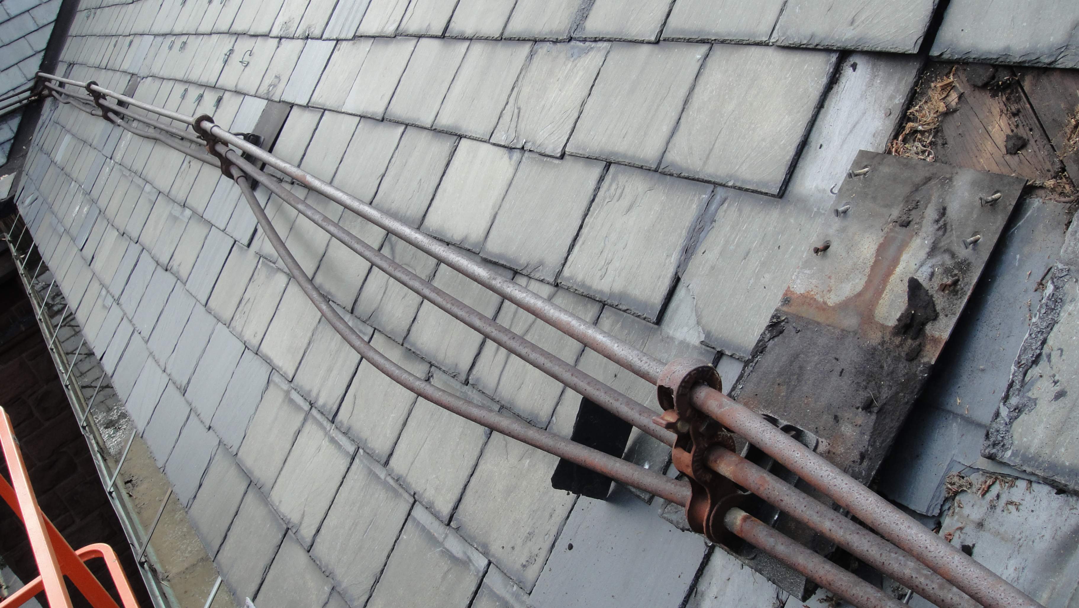

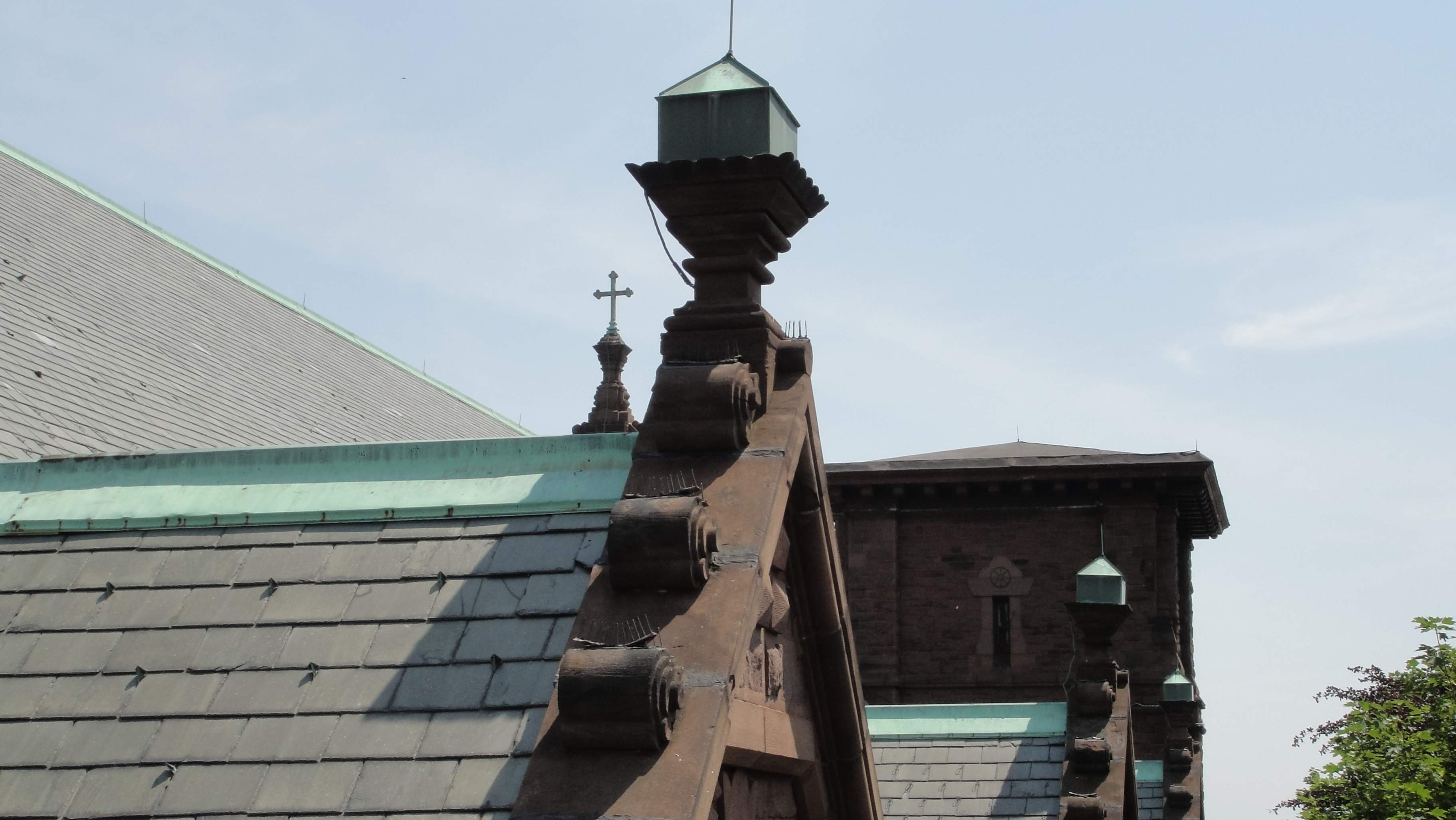

I don't know much about lightning protection but I occasionally find myself repairing components of lightning protection systems on old churches and schools, mostly because no one else wants to or can get to them.
This is a church I've worked on for close to 30 years now, the system is old and often I find wires broken so I splice them where possible. We work across the ridge of the building sometimes and believe me you don't want to sit on one of those 12" high spikes :eek:
Pictures;
This chimney is 92 feet high, you can see the old system in place, we use a boom lift, imagine how the old timers got up there!

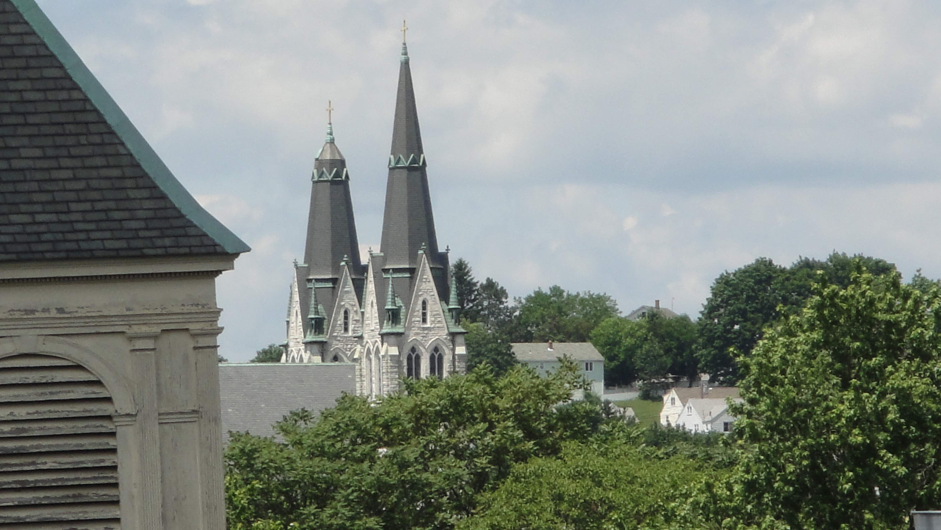

Plus, Lightning truncated one of these twin steeple towers years ago, unsure whether it was protected or not, but guessing not.
Oh yeah don't forget it was Ben Franklin who gave us lightning protection, probably one of his greatest and most enduring contributions/ inventions, even though not many people even give it a second thought. It's pretty much a world wide standard that we could not live without.

Question for JB...Looking at your pictures, the second picture shows a church roof that is shingled. Looking closer at the shingles...I see a lot of raised areas on the shingles. What are they? Roofing nails that have popped up? Or something else?

That is a 110 year old slate roof, a very high quality slate (monson black) and what you see are copper snow guards. There are a few different types on this roof. Some are wire loops that were put on when the roof went on, some were retro fitted over the years, they just slide up between and under the slate and catch the top edge of the slate with a fold in the sheet metal.
This is a high and steep roof, the gutter is over 50 feet off the ground and the peak is 90 feet high. I've seen pictures of the old timers installing those little snow guards from bottom up, they would get a row started and just lay a 2x4 on that row and keep moving up. no fall protection, just a 2x4 out in the middle of the roof 3/4 the way up. That takes some nerve.
On the bottom a couple feet up from the gutter there is a steel pipe snow guard system that is supposed to hold the snow back, but it still builds up to the point of forcing past and damaging the snow rails crashing down to the ground. I never get to hear it cause I'm home tucked into my bed, but the priests or others that live in or near slate roofed buildings always use the same term to describe what it sounds like "A freight train"
We had a hard winter and the snow rails took a beating.
This building is very well covered with lightning protection, almost every picture I have you can see the braided wire or spikes. you can see some in the last picture. The only problem is it is very old and I know there are breaks in the bonding. I will start looking closer at it in the future, maybe propose some serious repairs.

Thank you JB. That is very interesting. I did not think of slate, nor snow guards. Living down south it did not enter my mind about ways to hold snow. I see the lightning spikes and it looks like there are a few pigeon spike strips there, too. That looks like interesting work. I can't believe the steepness of those roofs. The idea of safety has come a long way.
