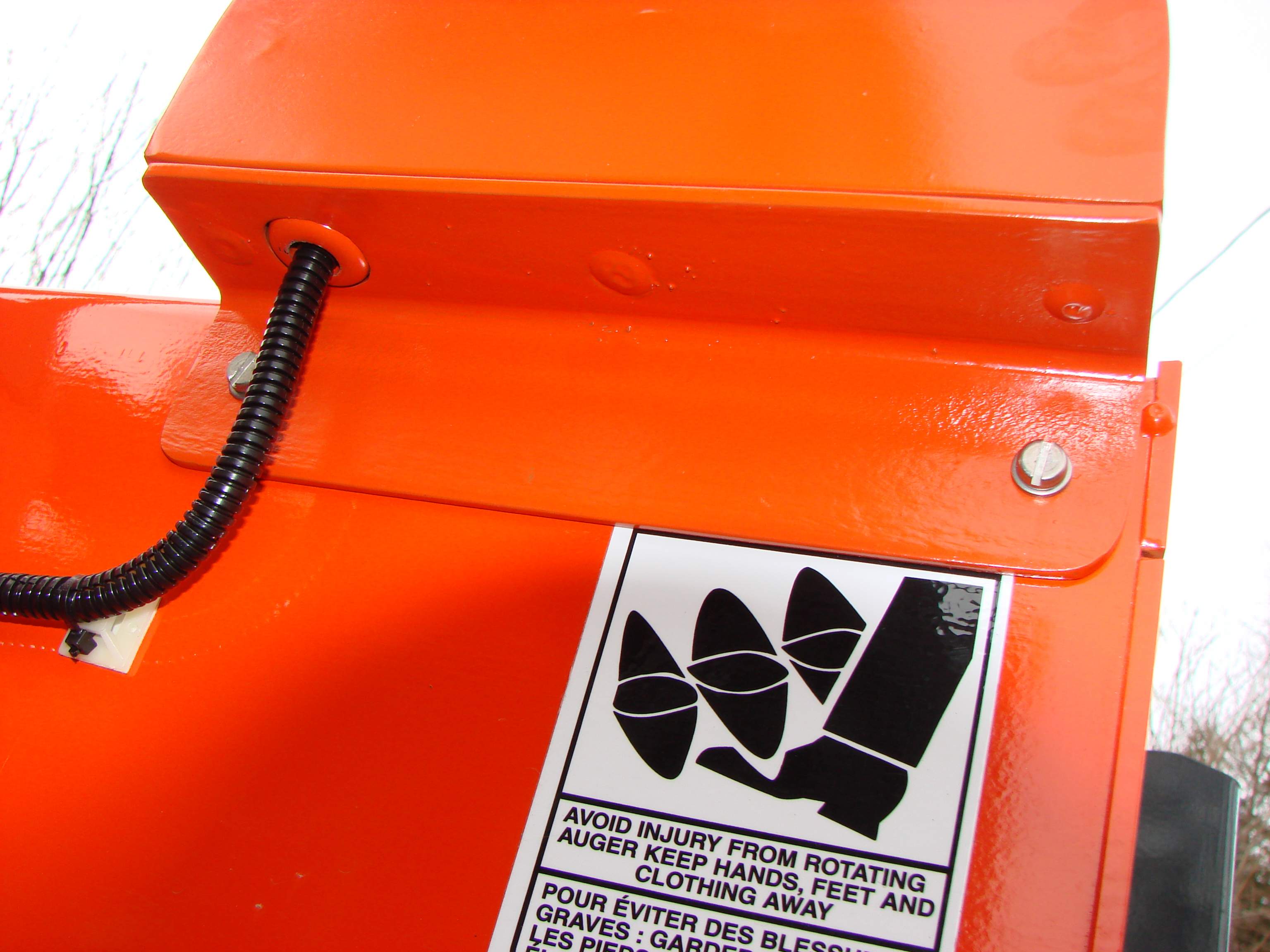

Thank you Eric for the kind words. I wanted to do the video to show everyone just how I did it plus it's a little easier than just posting pictures. To bad about the poor guy on the tractor. Always bad to hear these things this time of the year.
The lights are made by Grote and the part numer is # 77362. The part number is for one. The lights are LEd and water proof. You'll also need a small wiring pigtails that go into each light and they will be water proof as well. There will be three wires on the pigtail. One is ground. One is park and one is stop. If you hook up the park wire the light will flash slow. If you hook up the other wire the light will flash fast and just don't connect to slow wire. I went with the fast flash :D
I don't need to tell you that it gets a lot of attention ;) Oh. The cheapest place to purchase these lights will be from a Tractor truck parts store. Places like Napa will want your first born to buy one. I think up here in Canada I paid around $30. each and about $4. for each pig tail.

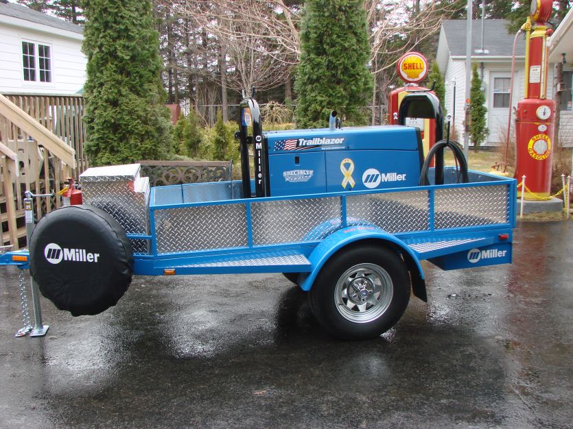

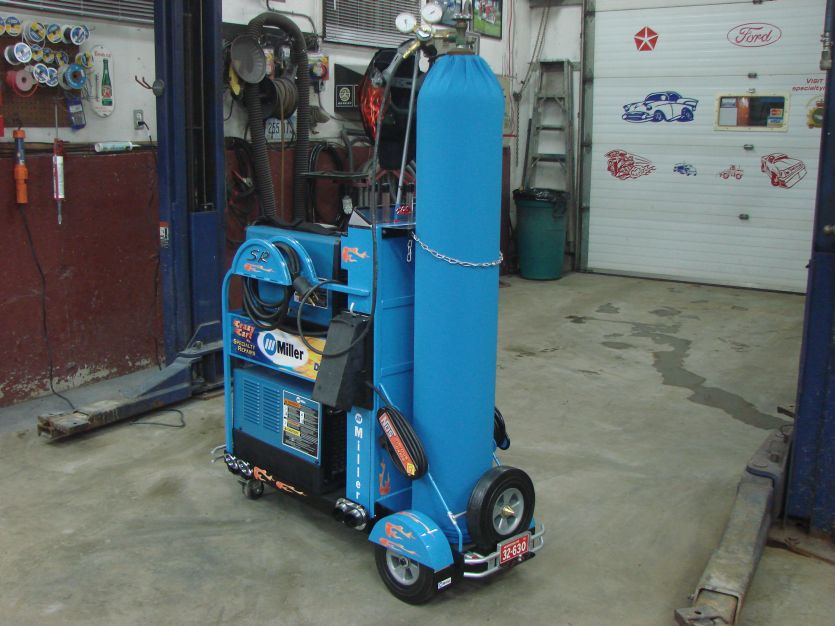

Philscbx Cool handle. Do you ride a CBX? They are NICE bikes :D My daily rider is a GL1800 Wing but I haven't seen a bike I didn't like. Enjoyed reading your story. I'm not a hunter either but do enjoy snapping pictures of things in the wilderness. I also like the Miller gear. Although my main business is in automotive I do a good bit of machining and fabrickating. You can't go wrong with that new Mig you got there. Very nice machine.
I got the Miller 702 plazma. Miller Dynasty DX200 with the "Crazy Cart" I designed and built for it. Got the Millermatic 251 with aluminum spool gun and the mobile Miller Trail Blazer 302 with custom trailer I designed and built. Good thing I don't weld for a living :rolleyes:
Thanks for your reply and your kind words. Enjoyed it!

The LED lights I was refering to was the ones in the video that I made the box's for and mounted on the snow blower. That's why the video was made. I just wanted to show how I did it just in case there were other tractor owners out there that may have wanted to do the same as I did.
The only other LED's on my tractor are the top of the cab signal lights. I removed the factory ones and put LED's in there place. The top emergency light is a strobe light and the custom built the light bar for it. Hope this clears things up for you.
