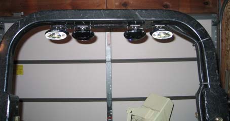

Here is a picture of the lights I mounted to my ROPS.
I used marine expoxy to mount a 20" long piece of 2" angle iron to the ROPS. I then drilled all the mounting holes into the angle iron and painted it to match the ROPS. I mounted my lights UNDER the ROPS because I have lots of low tree branches and didn't want to tear the lights apart on a branch.

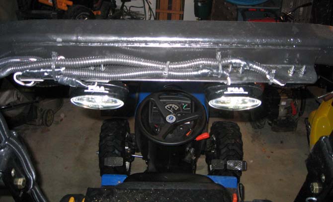

Here is a picture looking down onto the back of the angle iron light bar I attached. By using the angle iron and mounting the lights below the ROPS, it allowed me to run the wiring behind the ROPS and keep it protected from snagging branches.

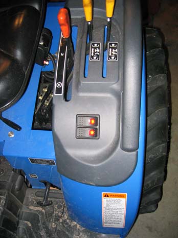

Here is a picture of the switches I mounted in the left fender. The switches are waterproof marine switches and seem to be the same brand used by NH on the dash. The switches are available with lighted indicators or without them. I chose the lighted units.

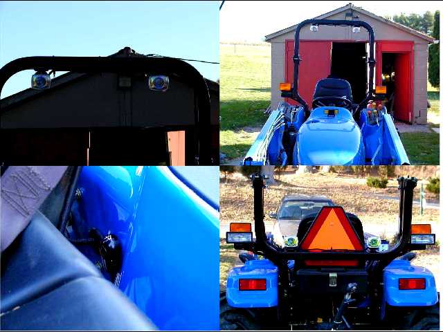

Here is my light solution.. There is more to the story on my web page..

MMiller how about lights under a canopy? You can keep cool, high, dry, and well lit. /forums/images/graemlins/cool.gif
