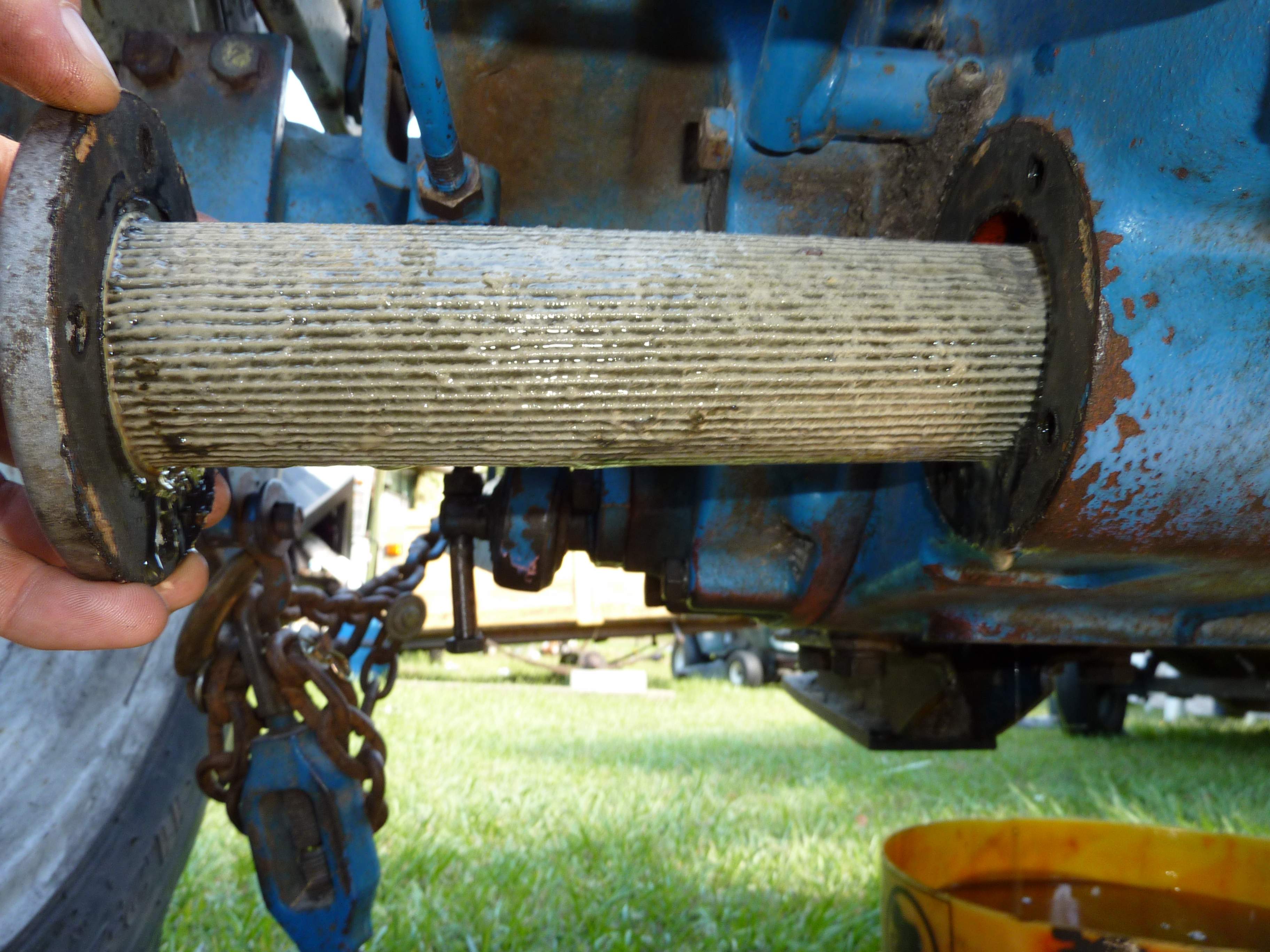

awwwh now that thats dun, i can go back to blacksmithin. i finally got round ta tinkerin on the tractor. drained n strained the tranny fluid. found the filter plugged again.
i flushed it out with bout a gal of deisel a cuple times strainin it each time. the hydraulics are once again responding. i cant thank u all nuff fur all the dialog in diagnosin my delema.

glad i flushed the tranny cuzz it had a load of debri in there.
Thank God it was a simple fix.

Looking at those pics makes me wanna puke.. lol :yuck: A good thing is there is no rust on your gears in there. :thumbsup:
Cool, You might have a pump overhaul in your future madam. I'd add 5 gallons of oil and run it for a while, drain filter and reuse the same oil minus the crud several time to cleans inside of the system before putting new clean oil. I'm wondering if this thing sat out and got bunch of moisture in it. I wondered if they had the right oil in it or they just put some unknown oil in it. Mystick oil sold by TSC is not too bad and it meets NH 134a.

well guys, that sure didnt last long. only 3 menuts ta plug back up. im thinkin it's time furra new hydraulic/tranny filter. altho this one's sposta be cleanable, ive alredy flushed the filter once before. n again this time i drained n flushed the system. wen i filled the filter with fuel to flush it, it sure didnt wanna seep thru the filter very fast. i dunno how many other times my pa had cleaned this one before he passed. n i had no idea wut wunc wuz cleanable aint cleanable no more.
now, were do i find a filter fur my ford. it's bout 12" long n bout 4" diameter. mesh outside. the filter guys, the filter...
