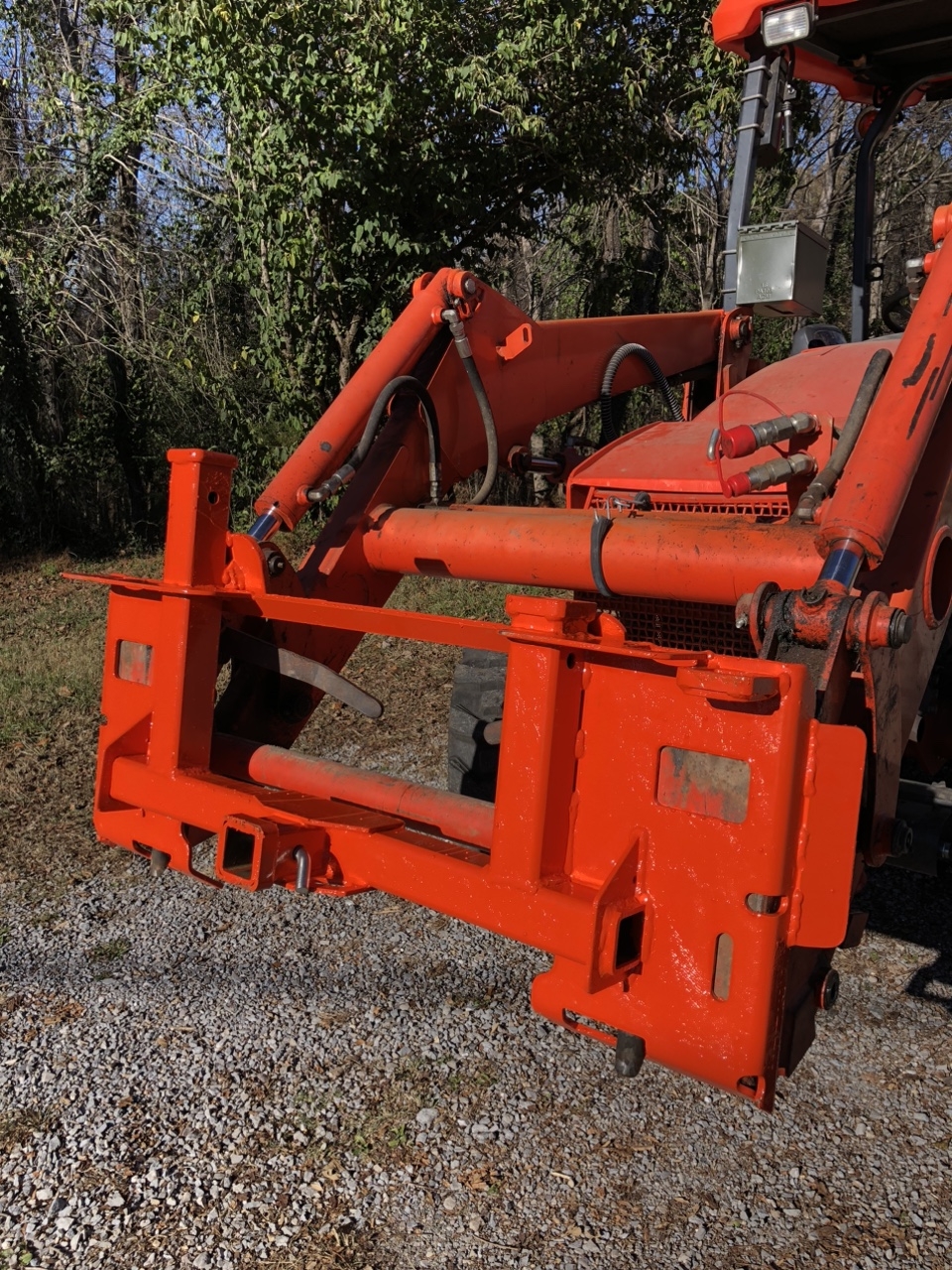

Have 2” receiver hitches on grapple and buckets for high work. Low work or narrow woods roads they get in the way. Made this with multiple receivers. Like that it lighter to high hillside work and doesn’t get in the way down narrow paths. Usually use the right top tall one.
