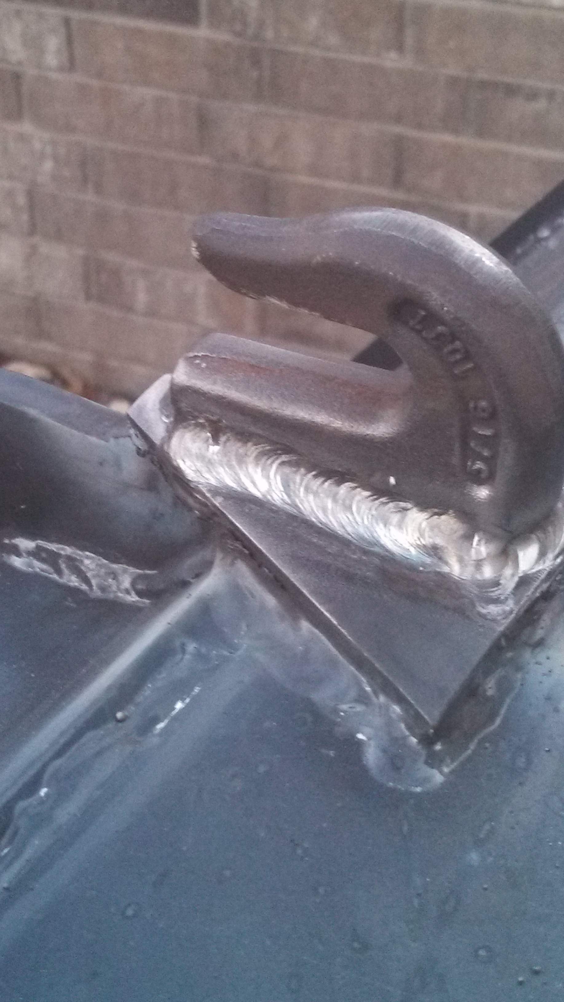

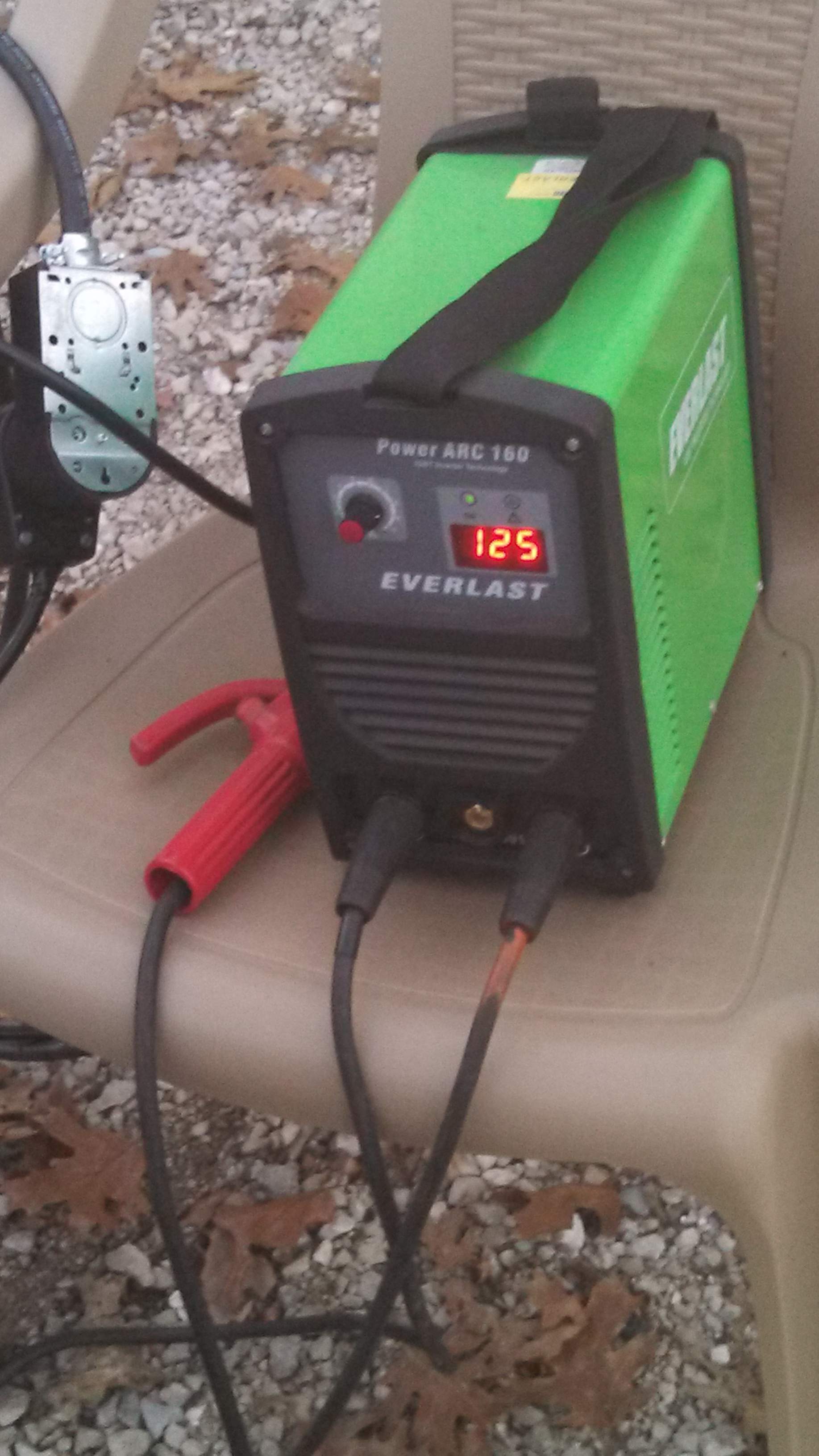

Well, if you ask 10 weldors, about welders, you will get at least 10 different answers, some defended to the death.:) What I am saying is this is a contentious subject. But since you asked.:) Ok.. well an AC only welder will make welds, but an DC welder makes a lot nicer welds with less spatter and offers a larger selection of electrodes that will run on DC I have a nice AC225 Lincoln. looks good, and is about 20 years old. It served me well. I gave about $210 for it about 20 years ago they are about $300 now. I gave $269 for an Everlast PA160, a little 160 amp DC only inverter welder and it is so much better of a welder it is not even in the same class. Its capability's are far greater, its ease of use is far greater. It is the size of a lunch box AND it is made in China!..That fact alone is enough to have me thrown into the depths of hades by some people on this forum, and if you buy a Chinese inverter welder, you too will be despised by a few here. However a lot of these little Chinese welders work very well. Now, how long will they last? I dunno. I have used mine for about 2 years There is nothing in the box on the Lincoln, a transformer, a fan a switch, maybe a choke, and that is about it. The Everlast is full of electronics. All I can tell you is I haven't bothered to use the Lincoln since I got the Everlast, an the Everlast has made my welding so much better it is not even funny. The Lincoln is for sale, it is mounted on a rubber tired hand truck, and I put 30 foot welding leads on it. (original 10 foot) $150 and come and get it.. I will help load it. It is heavy. I can tuck the Everlast under my arm and walk off with it literally, and its duty cycle is more robust than the Lincoln. Would I buy either of the AC225 AC only or even the AC/DC unit.. uh. no I would not. Others on here will call me "shill", "fanboy" or insinuate that I am paid by Everlast or Longivity or so some guy in China. I will assure you I work for Windstream Communications and am just a hobby weldor, and have no finincial interest in or receive ANYTHING from either Everlast or Longivity. Rigs I would look at IF I were you. Everlast PA140 PA160sth PA200 PA300. Longivity Stickweld 250 . There you have heard my rant, and undoubtedly will hear others:D Here is some pix of the welder, and the buckethook is welded with 7018 ( a DC rod) and the broken little stanly hook was TIG'd with the Everlast (yes you can TIG with a DC stick welder)
