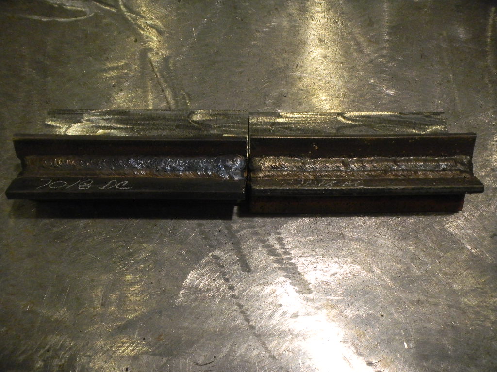

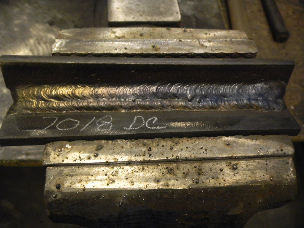

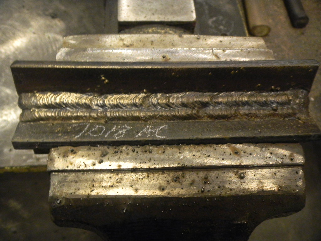

/ LINCOLN 225 #45
I am far from an expert in any way on welding as Shield Arc can attest. However I am learning through his help.
But some students make their teacher look really really good!;)
Some of your first vertical up with 7018 on the Stickweld 250.:thumbsup:
