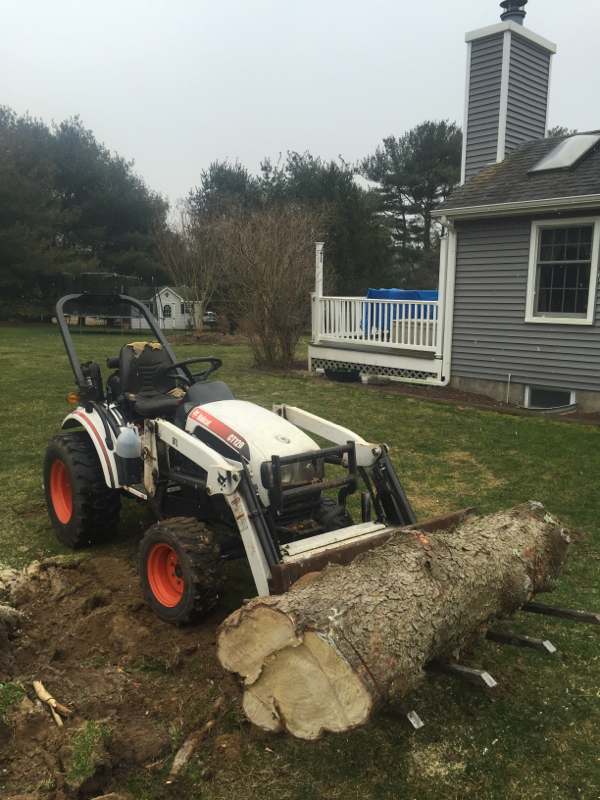

This is the most I can hope to pick up with his tractor. I don't have the most ballast in the back and put it in there is a weighted three point hitch trailer hitch.

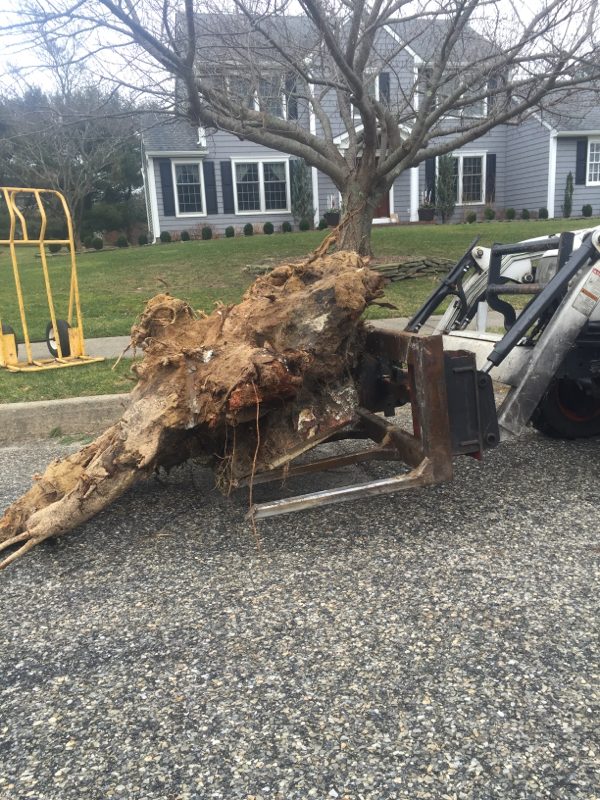

#74
This I'm picking up enough to drag out to the street. But the tractor at this point is having a hard time even lifting it enough to tip the machine

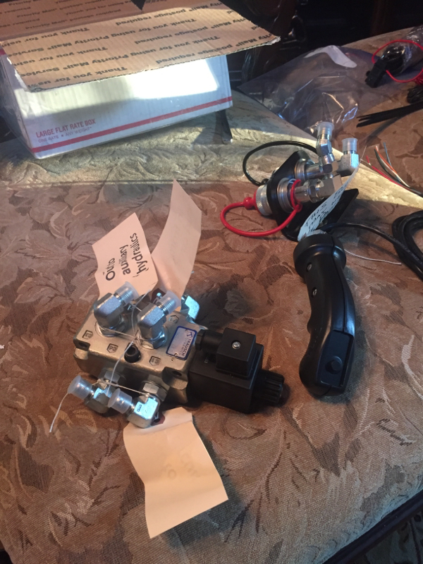

The kit came in
