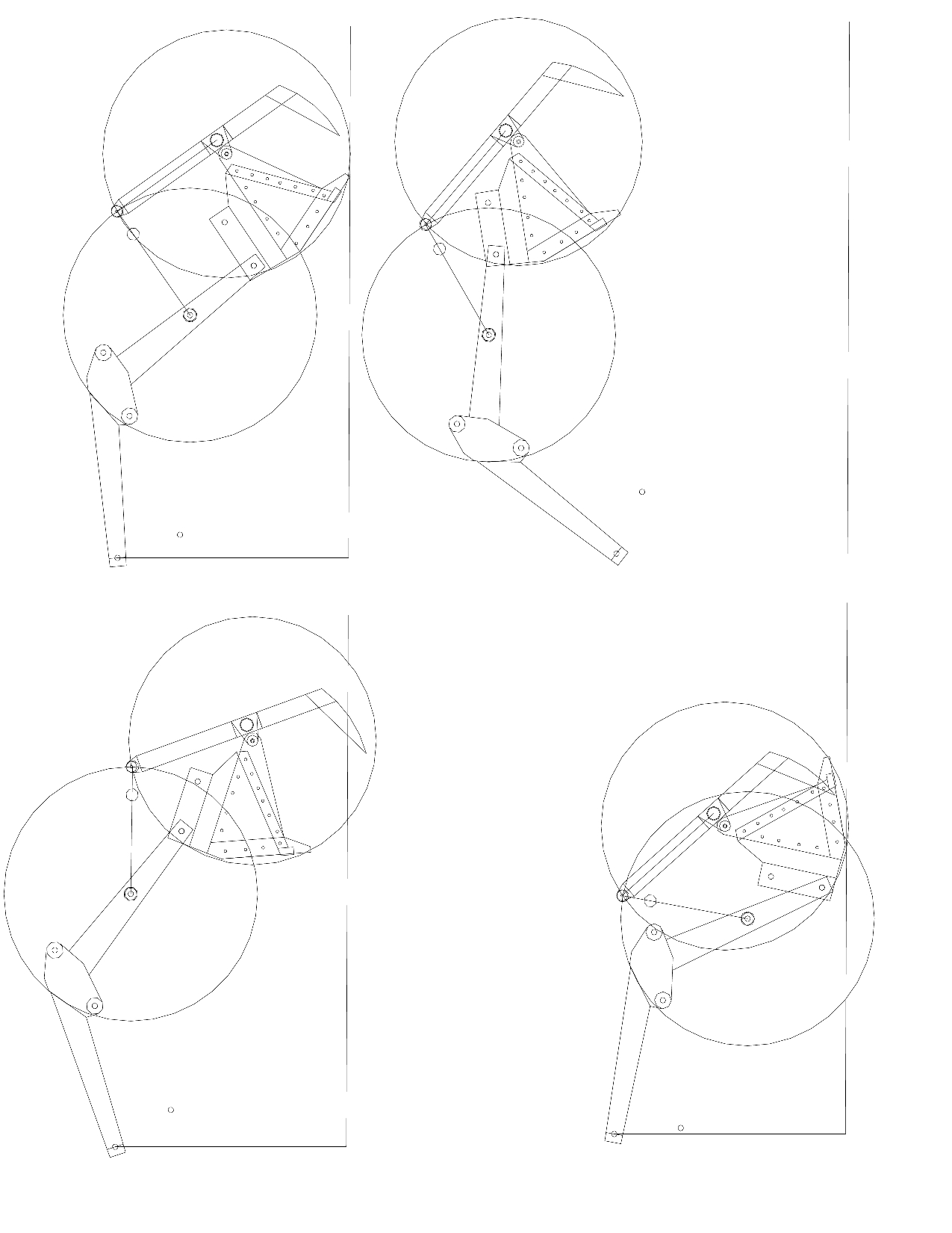

There was a thread about a mechanical closing bucket and grapple that was done by clever use of linkages that the bucket closed against the grapple as it curled back. I can't find it now.
I saved the drawings, with his member name, in my "Project Ideas" file, so did a search on his "Started Threads" and found it: http://www.tractorbynet.com/forums/build-yourself/353078-heavy-duty-mechanical-grapple-little.html
   / Linear Actuator for ct120 grapple #63
I saved the drawings, with his member name, in my "Projects" file, so did a search on his "Started Threads" and found it: http://www.tractorbynet.com/forums/build-yourself/353078-heavy-duty-mechanical-grapple-little.html
If I recall correctly you lose the normal curl function if you rig such a grapple closing device. Given the complexity and limitation I don't see it as a particularly viable option. Not that big a deal to rig up some rear remotes and just use those to control a grapple.
