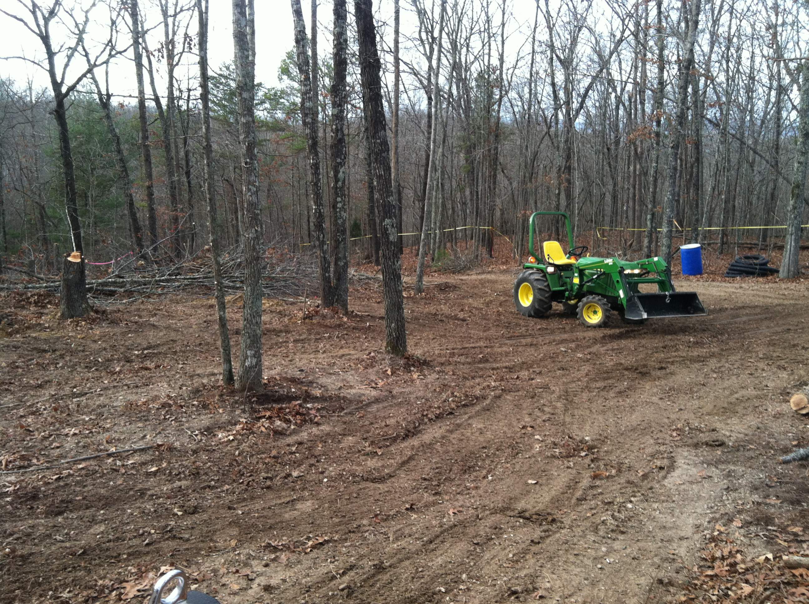

Well it looks like the plan is to take 6 gallons of antifreeze to the property ,I have a 55 gallon barrel of water already there and a drill pump/air compressor and I have a 5000 watt power inverter mounted in the truck for light duty power so I should be able to do it there without removing the tires and hauling /reinstalling them by myself and be done in short order ! I know in the long run I will be proud of self building this property but sometimes you have to be a little creative dealing with the heavy stuff alone I need to keep my back in working order this early in the game and at 6'2" and 240 lbs it's hard enough getting off the couch sometimes !:laughing:
60.00 anti freeze
12.00 liquid tire valve adapter
$72.00 total :thumbsup: Thanks for all the advice !:cool2: 036.jpg

I'm clearing land and have no concerns about soft ground ,I have been using it without loading the tires and on my land I have a pretty good slope and a lot of trees to come down and skid ,I had 120 lbs on front and moved that to the rear and still felt uneasy ,tomorrow I will load the rears and let you know how much difference I notice on my machine ,I'm still working on a 3ph weight box too ! :thumbsup:
